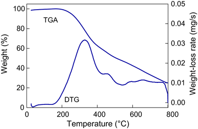

But looking to see what cracks those, I ran into this, which is a really good detail of what is happening at the chemical level when we are talking about cracking tars.. And yes I don’t expect anyone to read and understand it without eyes glazing. Skim and look at the pretty pictures and note the temperatures, etc. But the general idea is lignin is chain. In the first step, break that down to the individual links (which are rings). The second step is to crack those rings open.

From what I could gather, lignin is tricky because it has an intermediate decomposition stage that likes to reform back into tars and other nastiness rather than produce fully to CO and H2. Higher temperatures help and some catalysts help.
