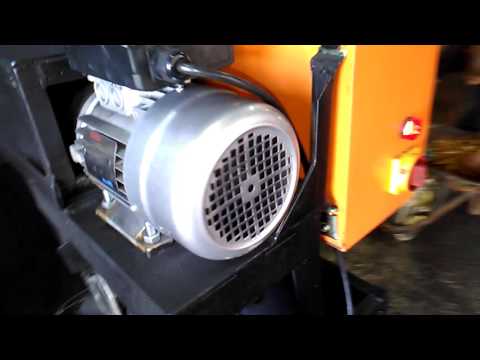

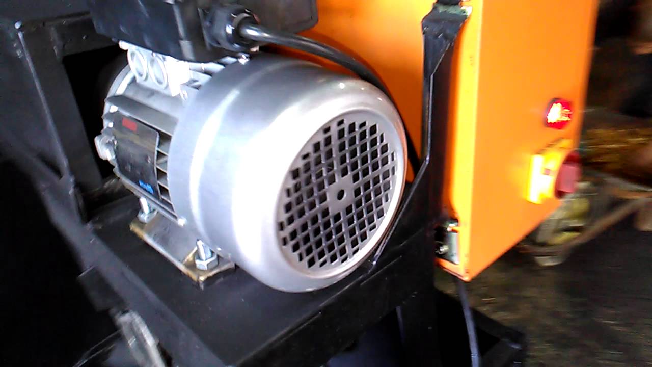

I thought I would put this here for those who might be thinking on wood gasiftcation on wood chips and all the automation that is required. That is one big gasifier with electrical motors running the chips feeders. To just run a very small generator. Heck the power of the generator has to run the electrical parts of the gasifier too. Not much left to run anything else. Right.
Looks a little to pricey for this poor boy. I don’t know what stackless means either. Is it some kind of Drizzler?
No, I looked for his other video s. Different pieces on top of each other. And I think he mentioned up draft somewhere. He started with real big chunks and at the end it was chips……

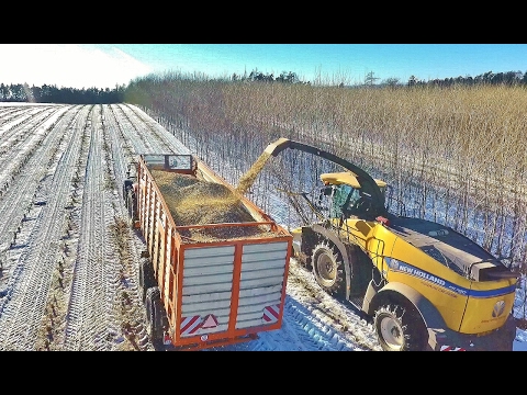

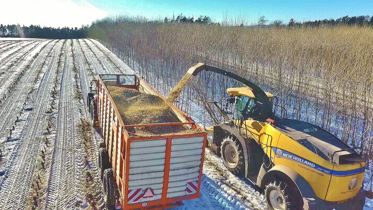

Too small for you! You are in the big money poplar biomass coppicing game! You need something bigger!
Just fin case you didn’t know, you can clone poplars from cuttings. it isn’t hard. :slight_smile:
(I posted this video because I think it is funny the tractor with the trailer kept getting stuck and was towed at one point. )
Yes this is what people shuld do more. not the biodiesel and bioethanol nonesence…
