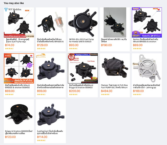

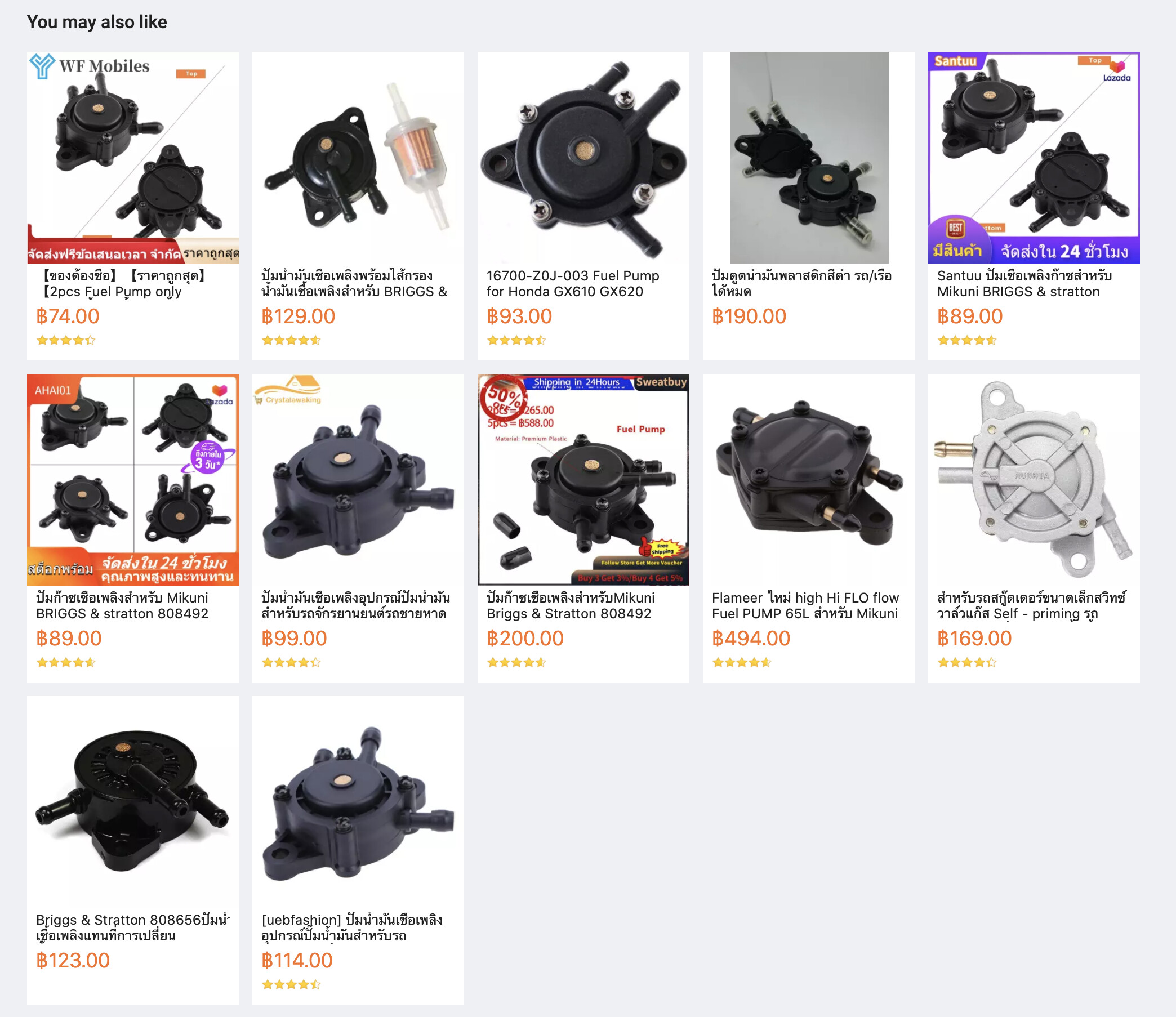

one of these , for a single cylinder engine, waterdrip feeder, works as a charm for few $ only

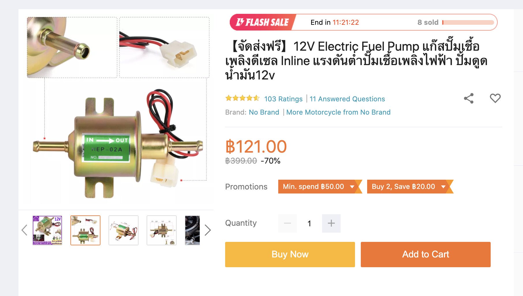

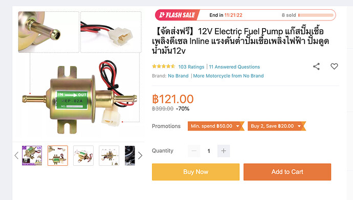

or one of these
Hi Koen, I went WOW!! those are expensive. Then I looked closer and realized, that is not US dollar $ sign being displayed.
Hi Bob, about 30 Thb to 1US$
They are around 8 bucks on Amazon. But I found just using the crank case vent to pressurize the tank works for basically free. Just a hose is all that is needed. My filler neck and cap are NPT so you just loosen the cap to relieve over pressure.

Hi Koen
are these pumps connected to the engine intake?
and will they work with a four cylinder?

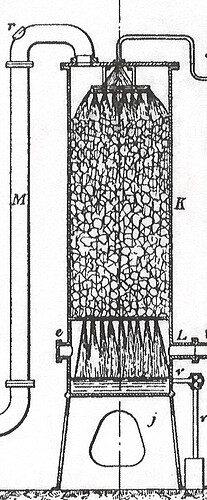

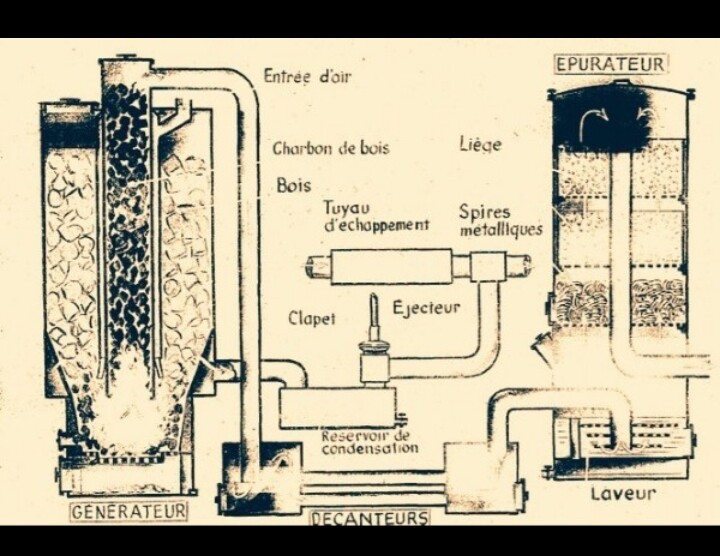

This has steam intake to gasifier . Does not specify engine vacuum controlling amount of steam or tuning of this system .
