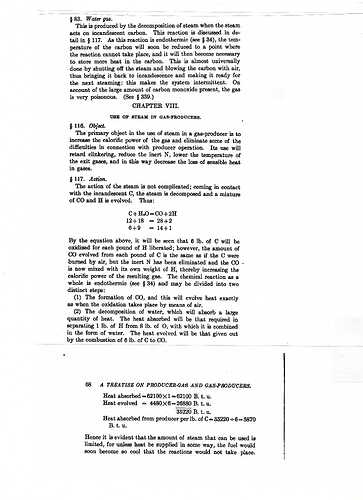

The idea here is to use the reaction heat for this to keep the nozzle from melting. The steam is not doing anything. it is the flashing of the water to steam that is absorbing the heat. The later water shift is exothermic as well, but this is not all that is cooling the nozzle. The water flashing is more localized to the nozzle cooling. The steam water shift is happening well after the nozzle into the reaction zone.
Endothermic ?
Oh, I need more characters.
Water shift is moderately exothermic but tar cracking is endothermic.
https://www.sciencedirect.com/topics/engineering/water-gas-shift-reaction
http://beta.chem.uw.edu.pl/people/AMyslinski/nowy/zarzadzanie/06ME_mat.pdf
Per page 49 #83; over all it is endothermic. A bit like heats of combustion in that there is positive and negative reactions at work.
Minor detail, just fun talk. What matters is a working and reliable producer.
Yeah you are right, I had to look them up and I actually meant endothermic. The process absorbs heat. Both in the evaporation of the water and the oxygen shift out to carbon.
