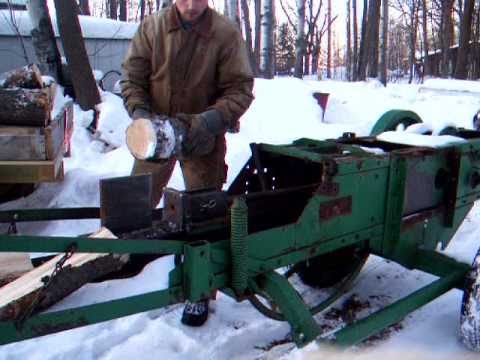

Chris' Baler Chunker
I have planned to make some type of a conveyor system from the beginning. That’s why it outputs chunks at the front, pointing towards the bed of the truck.
Right now my bags are solid not mesh, and wet wood will not dry in them. So, bagging is a second phase after drying spread out somewhere.
For those thinking 81 RPM is too fast, try counting the turns in any of Wayne’s chunker videos. He ranges from 60-90 RPM, depending on the tractor throttle settings. In this video it’s running 84 RPM, on woodgas.

Added a box to haul my stuff in. Corners braced by chunker feedstock… The yellow piece I picked up at Sandusky’s awhile back, perfect fit.
Looks good, why is it not raining at your house??
Haha! That wood I chunked Friday is already dry enough to run… :stuck_out_tongue_closed_eyes:
With the box heavily loaded, the chunker is now tail heavy. No problem with a sliding axle… I drilled a couple new holes and we’re back in balance. Credit to @MarvinW for the sliding axle idea.
