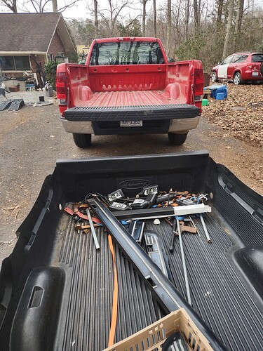

Got this godforsaken thing out of the bed. NOW I HAVE DRAIN HOLES!
And access holes. A pox on the dingdong that put the black plastic top covers to hide the dents and dings. It was self tap screwed and double sided taped down. Whoever had this truck before me was a real jackleg fly by night kind of guy.

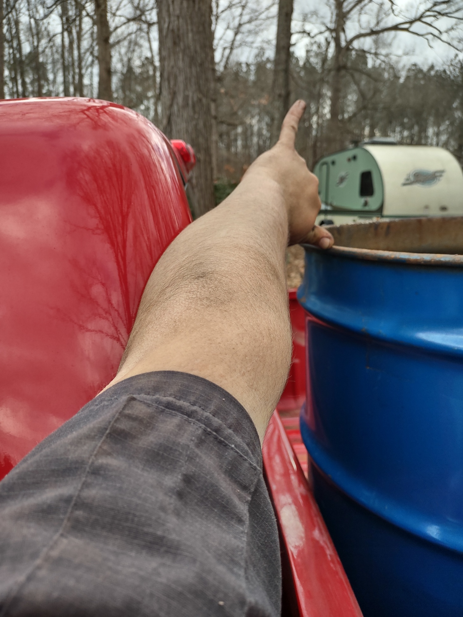

I’m going to see if I can fit a 2" PVC pipe in between the bed and the cab, if I can I know where my gas out is headed.

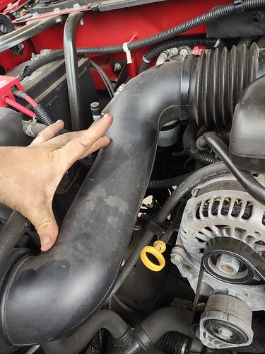

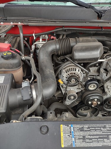

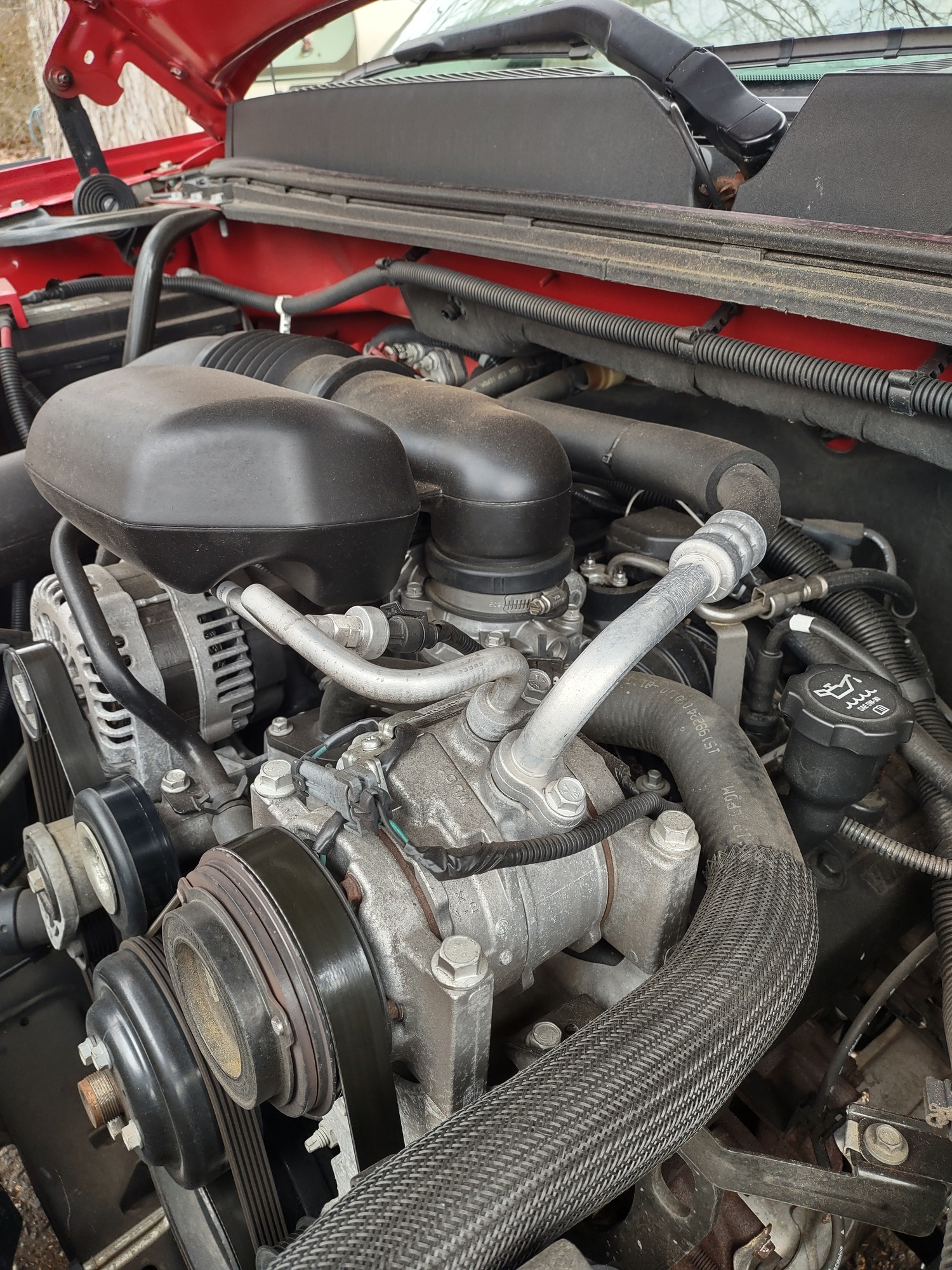

I wish I could find a fully sealed air cleaner body that would fit this bad boy. I’m wary of the plastic piping going from the air box to the throttle body.
I do have a fair bit of room. But it’s a clamp on style. I may try to make a plenum that route the woodgas after the air cleaner assembly, that way I don’t need to cut up the snorkel and prevent contamination getting into the vacuum tubes built in.
Either that, or I cut this section off and make an all in one gas mixer body to be clamped in. Looks like it’s about right for 3" thin wall.

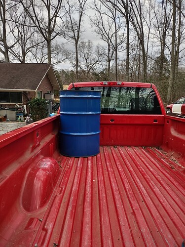

Here’s how much room I have with a bog standard 55 gallon drum sitting in the bed. I have probably 9 inches of room. I’m really glad because that will immediately go into hopper space and I won’t need to cut a big hole for it. I’ll just weld some tabs to the drum and bolt it down at the feet, and band strap it against the backboard of the bed.
Because of the location of the fuel tank I’m putting the gasifier on the Drinker’s side, filter body on Captain’s side. This will also make it a little safer for refilling since it’ll face away from the road.

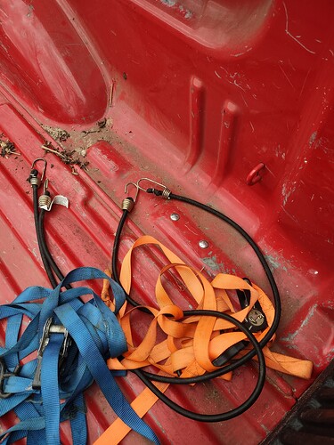

Homeboy had carriage bolts mounted on the passenger side of the bed. Two pairs. No sign of the same on the driver side. Wonder what accessory he had in here?
I checked underneath and there’s nothing attached. Really weird. I’ve thought about getting a truck bed crane lift put in the Sierra for when I have to pick up some serious scraps.

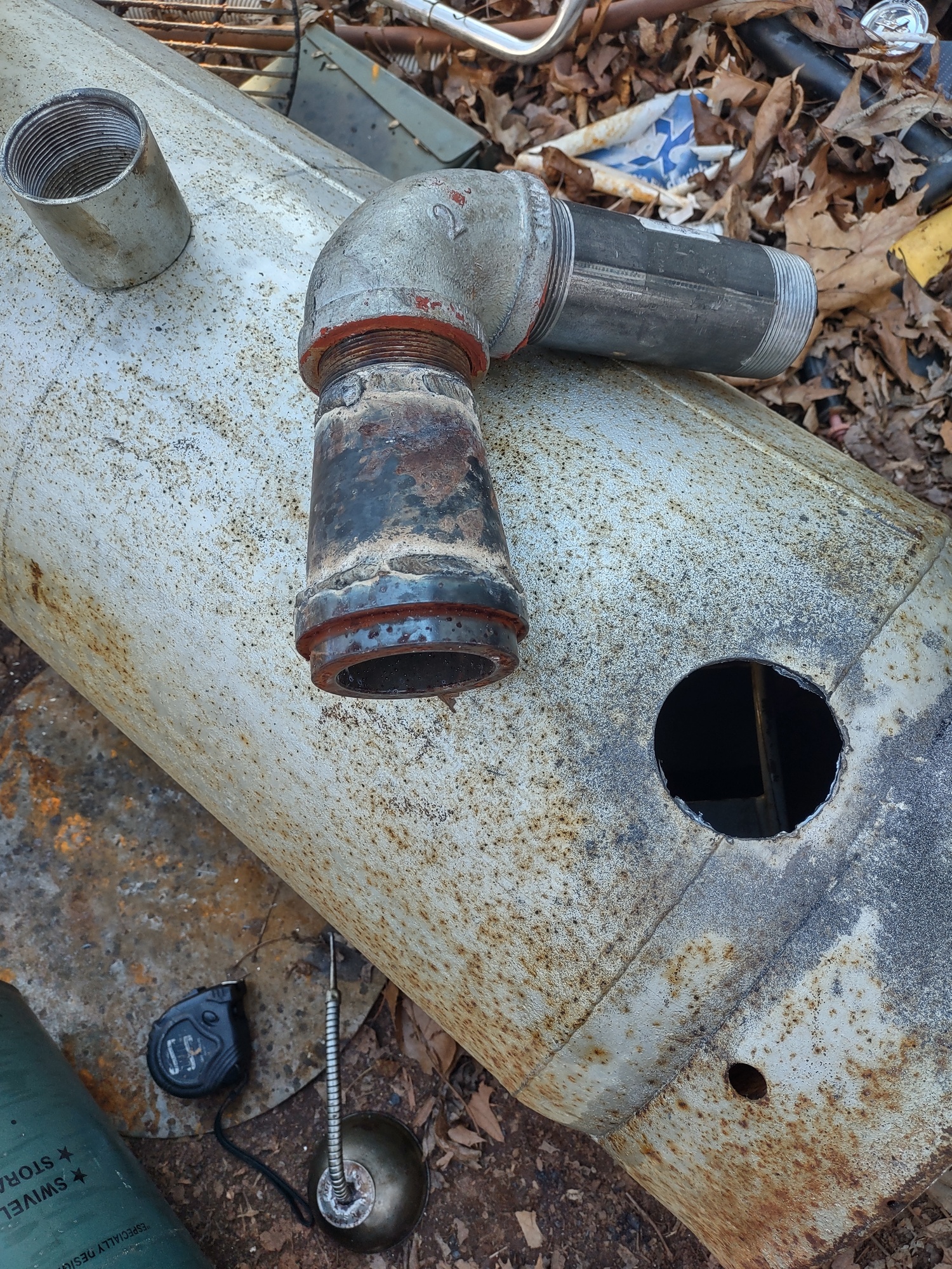

Okay so I have just about all the materials needed to route the gas. I’m robbing parts from the Mazda, and I have a few lengths of 2" EMT leftover as well as PVC pipe.

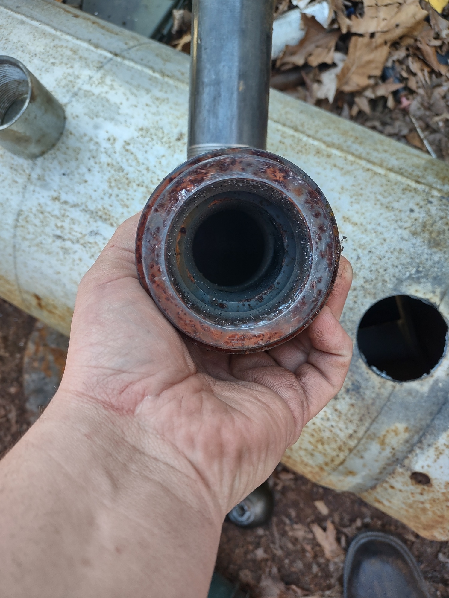

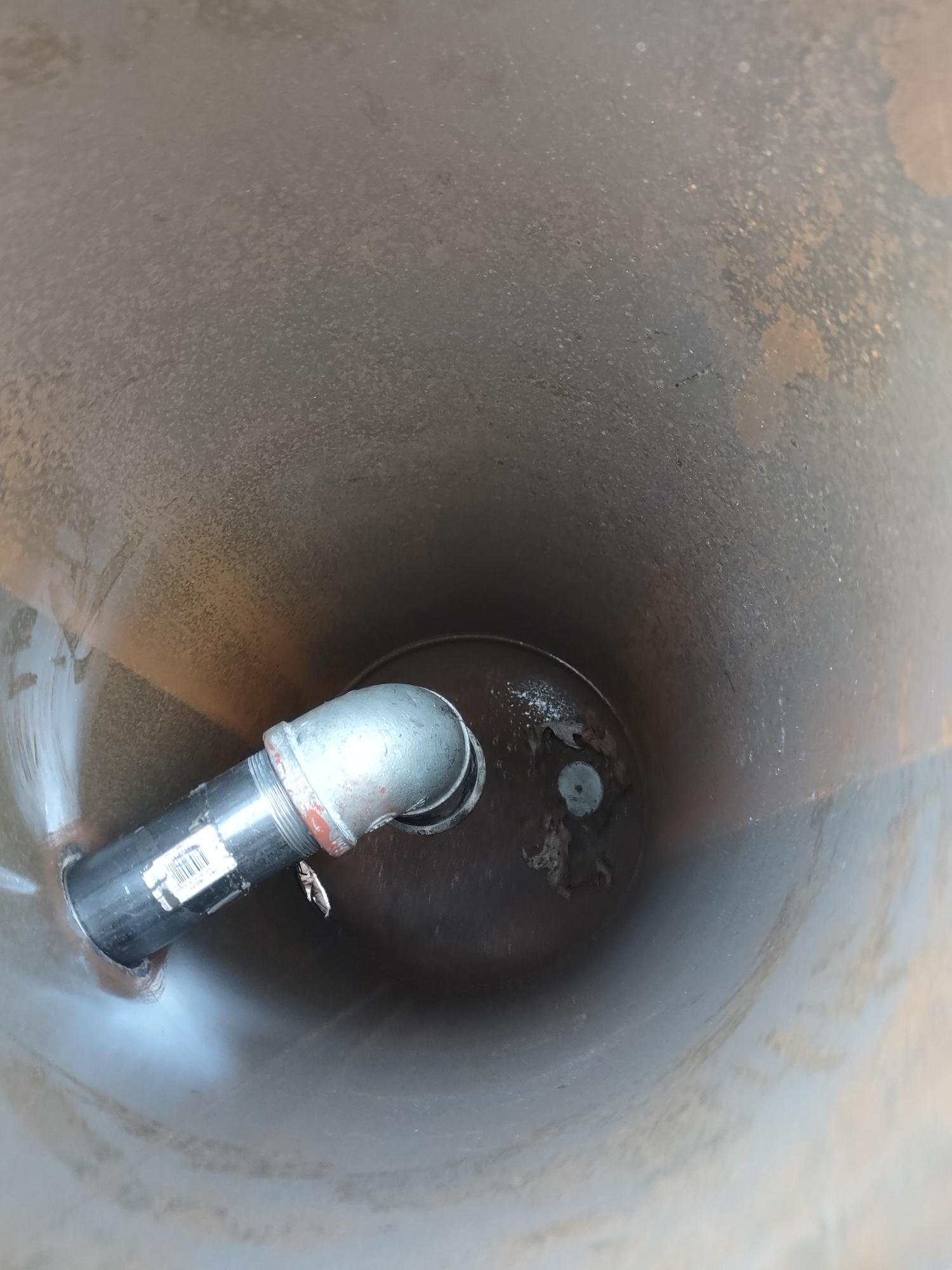

I’m going to cool the gas before I filter it, and share the water reservoir with the filter body. I’m going to weld my 20 gallon drum to the bottom of my 30 gallon drum because I have enough cab height to do this, will give me about 15 or so gallons of room for nasty juice. Might drill a hole thru the head of the bed and route a drain pipe with a gate valve so I can drain it cleanly.

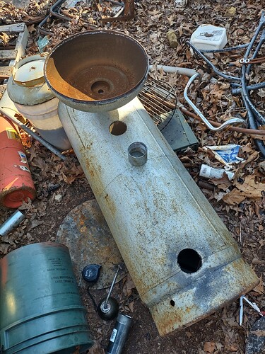

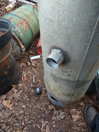

Svedlund facsimile body, 100lb tank. Nozzle is 2" ID and made of some heavy thick steel, threaded so if I ever find a better material in this size I can replace it as well as removal for slag cleaning or repairs. Threaded in also so I can remove the hearth liner for replacement or repairs.
2" thick of ceramic wool 18" tall, still need to get some sodium silicate to paint on the wool, and then use a watery slurry of my refractory mortar, I’ve tried spreading it on at the proper water mixture and it just clumped up. Going to go for a honey-like consistency instead of the peanut butter consistency that it had. Will probably be a process of laying the Gasifier on its side and add a bit, let it dry, roll it some and add more et cetera.
Once I get the coupler welded in I’ll trim off the excess and add a partial 55 gallon drum hopper. Looking right now if I don’t add a barrel hopper I’m looking at 30 gallons. So at my charcoal density, 36lbs of charcoal above the nozzle. Not very long distance.
I have not given up on the 4.3L sized Joni 8.0 copy, I’ve finally found my air jacket material, the old top of the 100lb propane tank. Very sturdy material and will be tall enough to fit.
