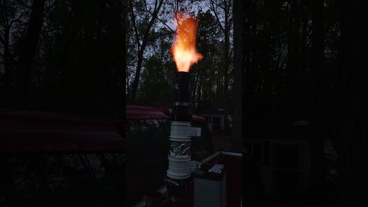

Did a flare test. It’s super odd.
The cooling rail isn’t getting that hot, but the exit pipe to the filter box was almost too hot to touch! It’s most likely not cracking steam. I’m wondering if a naturally occurring ash funnel will form eventually.
It warped one of my super cheapo bilge blowers. Video uploading now. Very strong flare. Two blowers joined up.
That sound at 4:40 sounds like the fire is traveling backwards down to the blowers. That is why the blowers got so hot. I had that a couple of times and melted the fan blades. Bummer!
Well, when I get it plumbed up to the engine I’ll probably watch it like a hawk on the test runs. Need to stop by the hardware store and get a few fittings and fresh glue. I should have enough elbows though.
The bottom fan is what got messed up, probably because it was cinched down to that silicone adapter. Plastic got soft and it warped from the hose clamp.
