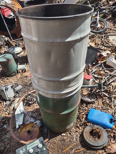

Those two barrels welded together is going to be a diagonal downdraft charcoal like earlier plans. I just wasn’t comfortable with only 15 gallons of hopper capacity but that’s fine for the generator, in fact I can lower the nozzle height even more for that 400cc engine and get some capacity back.

Got the top barrel portion painted with some primer. Coat is still drying. Thought I’d paint over the welds before surface rust takes hold. My first big circumference weld where I didn’t have leaks to patch up!
I still need to weld in the gas exit and nozzle coupler. I have a grate that fits perfectly inside this barrel and I have something I can use as a grate perch.
No it won’t be white, as funny as a stained white gasifier would be. I already have a lid with a rope RTV gasket, just need to make a lid tensioner so I’ll have popoff. Going the Gary Gilmore route with that, big central coil spring with a bar. That way the lid will just burp a little instead of flying all the way open. Going to weld a big bolt in the center of the lid to guide the bar and spring, bar will be some square tube I have laying around, holes drilled through and a nut on the end of the bolt. As the spring compresses from a backfire, the bolt will be able to slide through the bar but not the lid.

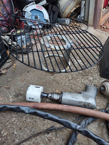

Here’s the grate. Held up with the old ring top of the 100lb propane tank. It sits the entire inner diameter of the barrel. Since it’ll basically be a fixed grate, the charbed should keep compacting.
I would think if you put course Charcoal on top first it would work. Is it a old BBQ grill?
Yes it’s an old BBQ grill. I have some coarse stuff I can pile on it, and eventually it’ll develop its own bed.
I am liking this KISS design, keeping it super simple. Let the Charcoal be the insulation around the barrel. This reminds me of the mini van gasifier barrel design. But you have a better nozzle and filtering.
I also have about 12 inches of char bed depth, so it shouldn’t get TOO hot at the grate.

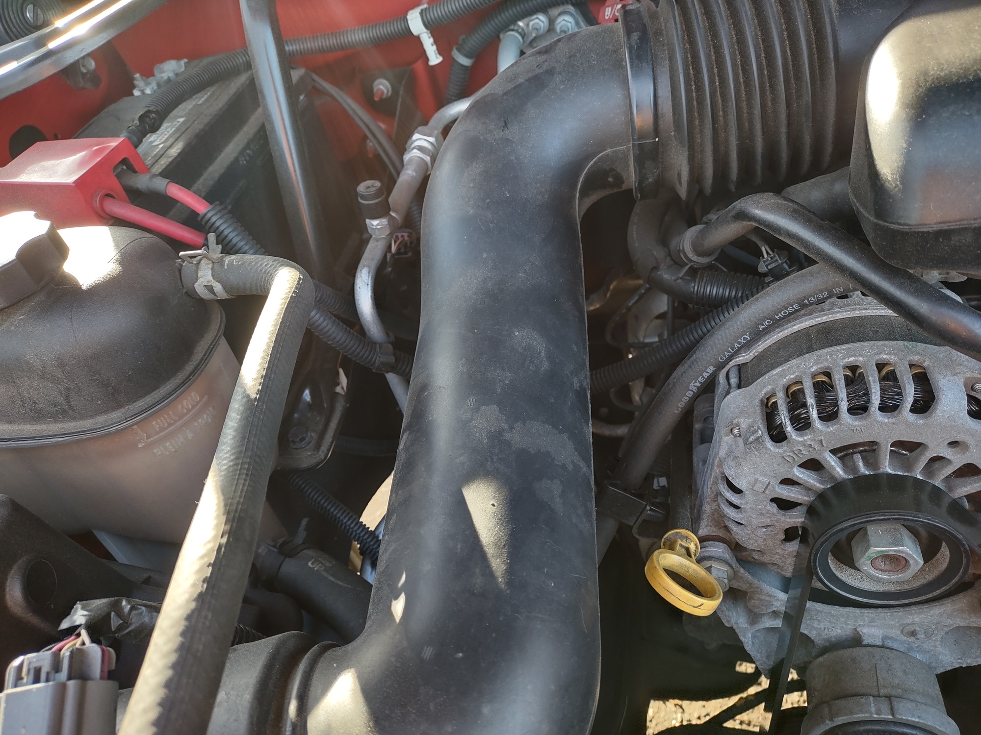

Now I just need to wait for my jumbo ammo box to arrive, and this week I’ll get more piping for the cooling rail. And some PVC for general plumbing. I need to get my strategy going for the air mixer. Not sure entirely how I’m going to splice into the air cleaner tube. It’s much bigger than 3" conduit. I have a factory recall air cleaner pipe that I will practice on, cut it open to see if I can nest the steel pipe inside and seal with silicone couplers that turbocharger people use.

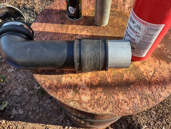

Okay so luckily thank God, a 3" Fernco fitting is a very tight fit. I have a very short area where I can introduce the woodgas as far as the snorkel is concerned.
To give myself as much real estate for the gas in and my air damper I might use a regular coupler and a 3" elbow.

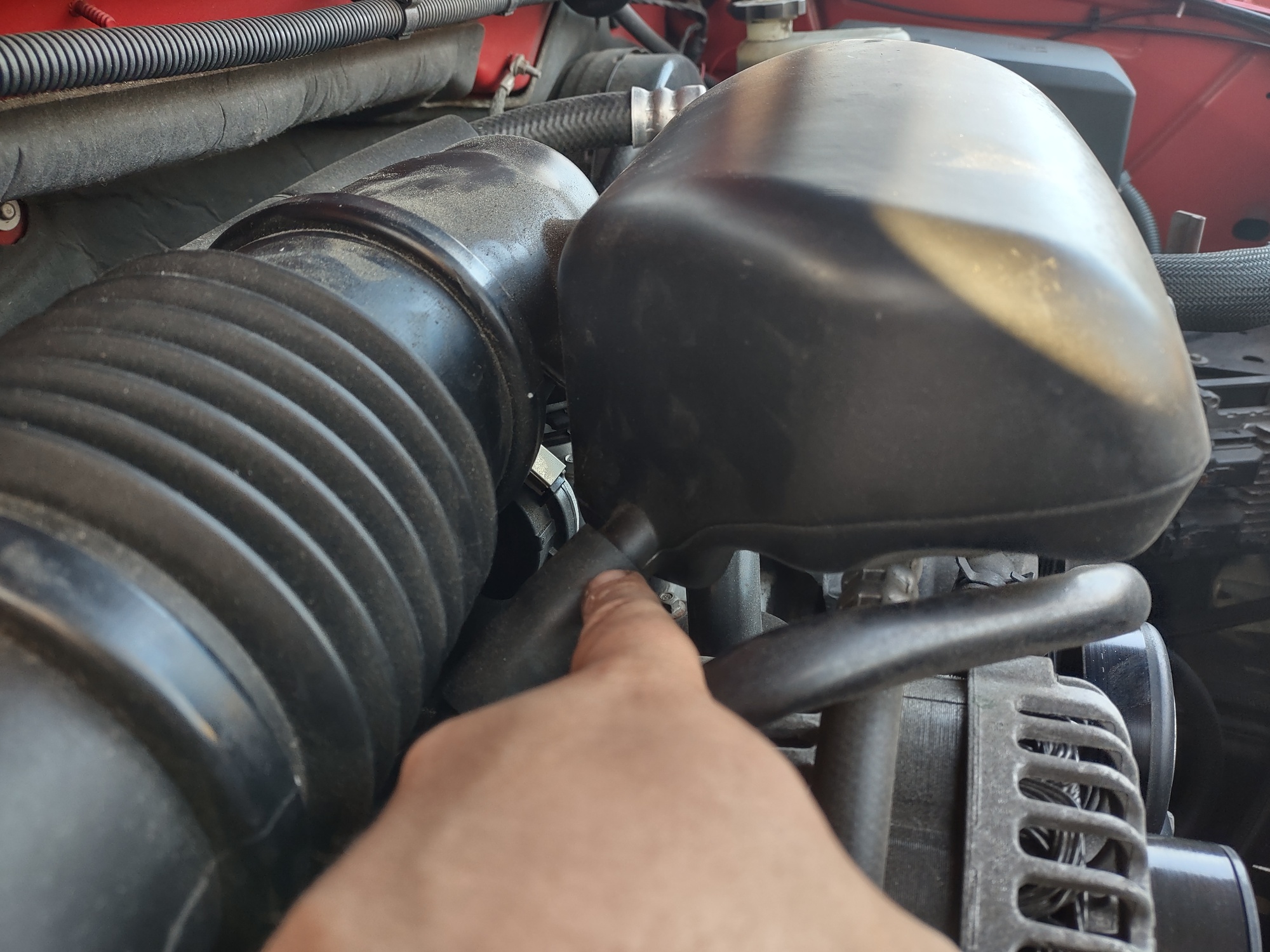

This area is in between the mass air flow sensor which is right after the filter, and the what appears to either be the valve cover breather or the PCV hose before the throttle body. That’s all under vacuum so I’m not afraid of soot getting in the PCV. PCV is in its own little box, one of those tumors attached to the snorkel pipe.
These snorkels are not cheap so I’m going to measure thrice, cut once.

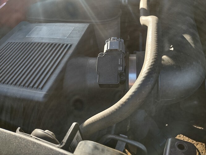

Here’s the actual snorkel, the MAF sensor, my real estate, and where the PCV hose is. I wish I had a few of those useless noise reducing tumors to plumb into like other trucks have. I can’t cut into this one because of the PCV.
You said just after the mass flow sensor air. Explanation again on what you are doing simple drawing will help.
The reason I ask is this is where I am trying to put my mixer on my Subrau outback I want to use the original air filter box for filtering the air mixer. I am concerned if I cut back on the air what my mass flow sensor will do.
I’m not entirely sure, but I can’t relocate mine or risk getting soot in it. Last thing you want is a bunch of carbon messing up the sensor and throwing off your fuel map when you’re on gasoline. When you’re not on gasoline and have it switched off it may be confused and try to trim down your fuel amounts. It detects less air so it trims back the gasoline leaving the injectors. It does this as your air filter gets dirty so it doesn’t run too rich.
My air damper will be behind the MAF, I think it will read normal air flow since it won’t be dampened until afterwards.
