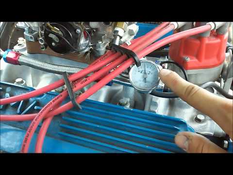

Ordered some hard line for the return and to bridge the gap for my vapor and feed lines. I’m gonna try out a clicky clacky low pressure pump to see how it performs. Have two so if they end up dying I’ll at least have a spare. I’m going to block off the mechanical pump but not going to throw it away. Might even leave it in the truck as my backup to the backup.
My experience with those external electric fuel pumps. The have to be mounted below the tank or they will run dry and burn up. May be different now but the they tend to over pressure the carb without a pressure regulator. Could be an issue with the small carb you are using. At any rate I would leave the mechanical pump in place.
I have a pressure regulator in place already to knock it down to below 2 PSI from the 7 the mechanical one makes at idle.
My only issue is one I had with the Mazda as well, every fuel cutoff solenoid I’ve tried fails within just a few months. They either quit working or start leaking real bad.
I know the mechanical one would be better simply because the fuel would already be at the engine, so I’d be back on guzzoline real quick. I’m just not satisfied with the ways to cut them off. Maybe I should just let the truck idle on gasoline the whole time and see what my consumption is like. With the return line put in place either way at least I won’t have to worry about vapor lock. Thunderhead289 had a way to do a return with a deadhead regulator using a barbed Tee. I’ll mount my fuel pressure gauge after the Tee so I can adjust the regulator accordingly to account for the tee bleeding off pressure.
He was doing this with an electric set to deadhead so I don’t know how my mechanical will react to it.

Okay going to try this out before going to an electric pump. Local parts store has a 3 line mechanical pump in stock, this could simplify my guzzoline plumbing significantly by just having the deadhead regulator close to the carb and the cutoff solenoid as well. Also means my return line will be the stock length, glad about that.
I should probably get some brass pipe and just hard connect my pressure gauge, regulator, and cutoff solenoid into one rail. I want to eliminate as much rubber line as possible.
