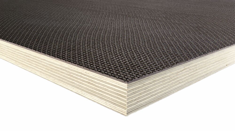

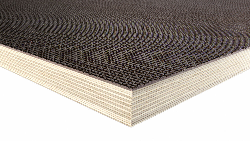

Not to drag up an older part of your thread, but these guys laminate the plywood.
I didn’t look to see what they are using. Maybe carbon fiber, which is a lot like fiberglass, but lighter and stronger. Fiberglass is bonded to plywood a lot for boats, but I don’t think it holds up well with the shock of throwing stuff in that back and abrasion resistance.
I wasn’t going to buy any, I already had a big stack. Luckily for me we got more 2x6 dimensional lumber so I can finish the bed.
My next challenge will be weight watching this truck because of the low GVWR. Old bed probably weighed 400-450 lbs, I vaguely remember someone saying a WK system is around 500lbs? I forget and I’m having a time searching for a definite answer. So if my truck’s curb weight is 3770, minus 450, plus 500, plus me(about 240), that leaves me with a 900lb payload. Not sure what the bed will weigh but I’m glad these 2x6s are softwood. I won’t really know until I get it all done.
I didn’t think you would -buy- it. I was just pointing at other options, namely it is the coating they use. I would probably stain it and put a coat of polyurathane on it. like how you finish a hardwood floor even with the pineboards you settled on.
