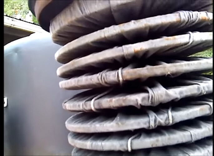

I’m going to follow Goran’s form factor and use a sheet metal wall to force the gas to go around down then through the bag filter. Same for using a perforated stand pipe that goes the length of the bag filter. The only thing I won’t do is the exact shape of the bag itself. The Mako looking charcoal gasifier that you can see on YouTube uses a more concertina accordion style bag filter. It’s gathered and reinforced with wires to hold it’s shape. Just means you sew the bag to the OD for the peak of the accordion and gather with wire for the valleys.

Yeah I’m second guessing my plan. That’s why I’m asking Goran how he sewed his together. I’ve seen Matt use staples to hold his hot bag filters together so I’m wondering if Goran did the same.
This round pledged filter I have seen before the container sat so filter was on it’s side. Like Steve said the ash/soot would fall off easier and end up in the ash clean out in the bottom part of the filter container.
I agree with Steve and Bob, this filter should lay-down, to not get clogged fast, anyway it is a good-performing, easy to make filter.

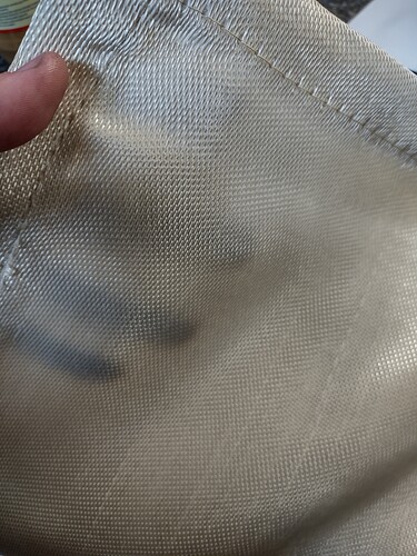

Bought a welder’s blanket. It seems like a very tight weave. I can still see my hands silhouette through the fabric though.
I could always use some of its own strands, or maybe staple it over in a double hem.

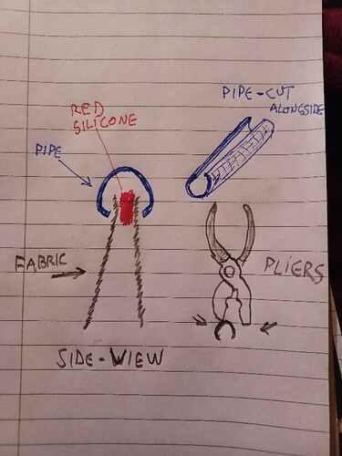

Sorry if i hijack your thread Cody, just posting some thougts about “joining” fabric, this is something i want to try when repair my filter, thinking about cutting up, maybe thin copper pipe and press it together on the joint.
Made a little sketch, because i didn’t know how to explain exactly.
I think the pipe should protect the silicone, make it withstand even more heat.
Personally I would use stainless steel, since heat anneals copper and brass so it might lose its grip on the seam. I think it could work well though!
It’s what i suspect too… stainless should be the best, but it’s rather stiff and “springy” maybe it dont close tight enough?
I’m not sure. I think if you were to see the silicone start to squeeze out then it should have a decent grip.
Another way you could try is to take sheet metal and flatten in a press. You would need a bending brake to start the bend and situate the filter seam inside, then press it down. Or do the same with the pipe, crush it down the entire way.
I would think after the silicone drys it is not going to come a part that easy. If you staple it down the seam or sow it with fine wire it will hold.
I have done both. Using a leather stitching awle for stitching with fine wire.
