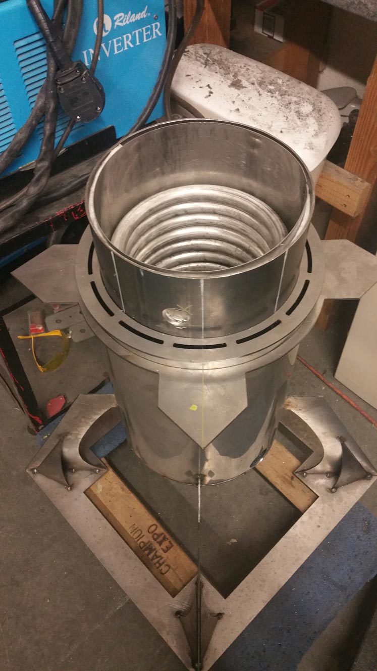

Crossfire Gasifier
New Crossfire gasifiers are being shipped with an outer jacket air pre-heater / gas cooler… This modification was done to cool the gas, but we were very cognizant that the heated air might increase (or make more efficient) the water gas shift, by reducing condensation prior to the nozzle, and (perhaps) even help carry the atomized vapor across more incandescent carbon surface area…
Will keep you all posted on our findings…
