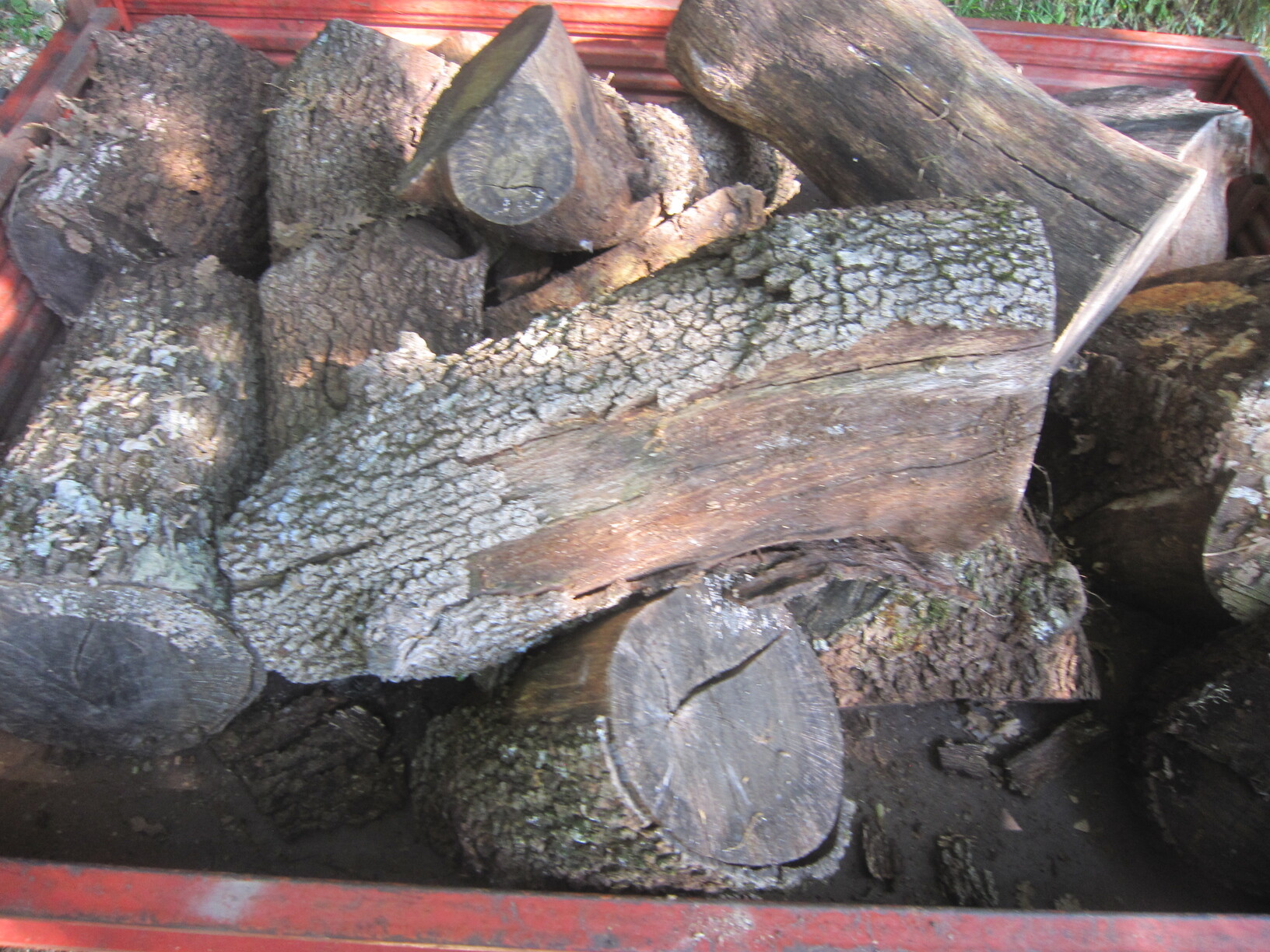

yesterday we loaded heavy oak pieces in the afternoon heat…here the new old tool from göran would have been useful…we must buid one…

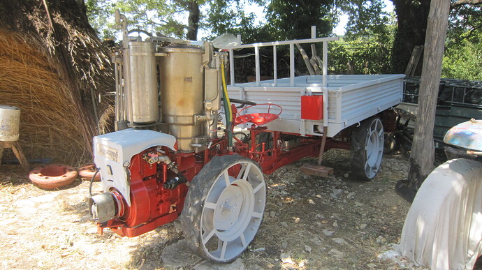

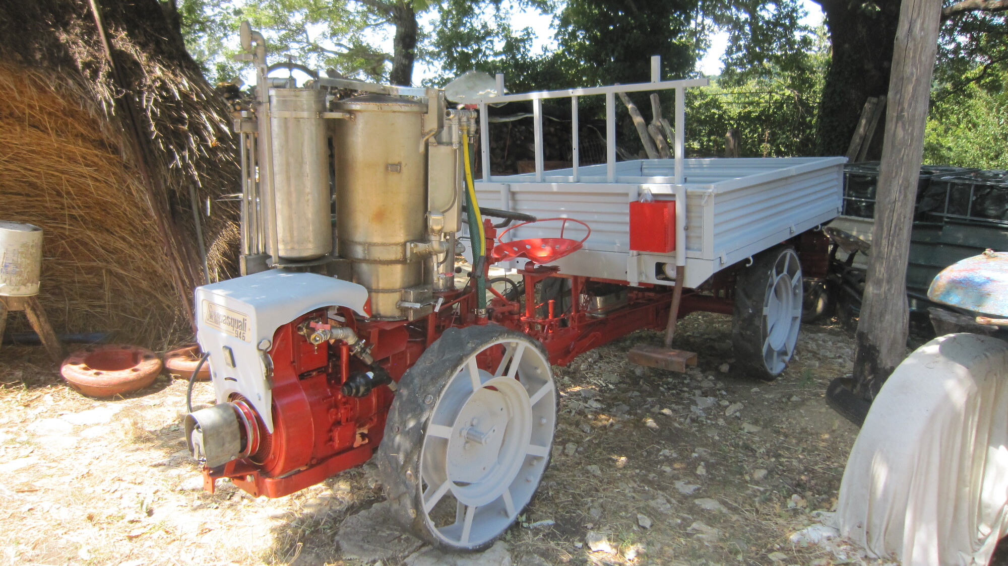

as the pasquali (gasquali) has no roof yet, we thought it is worth for some paint…

I think it is cool but how do you see over the gasifier when driving it?
