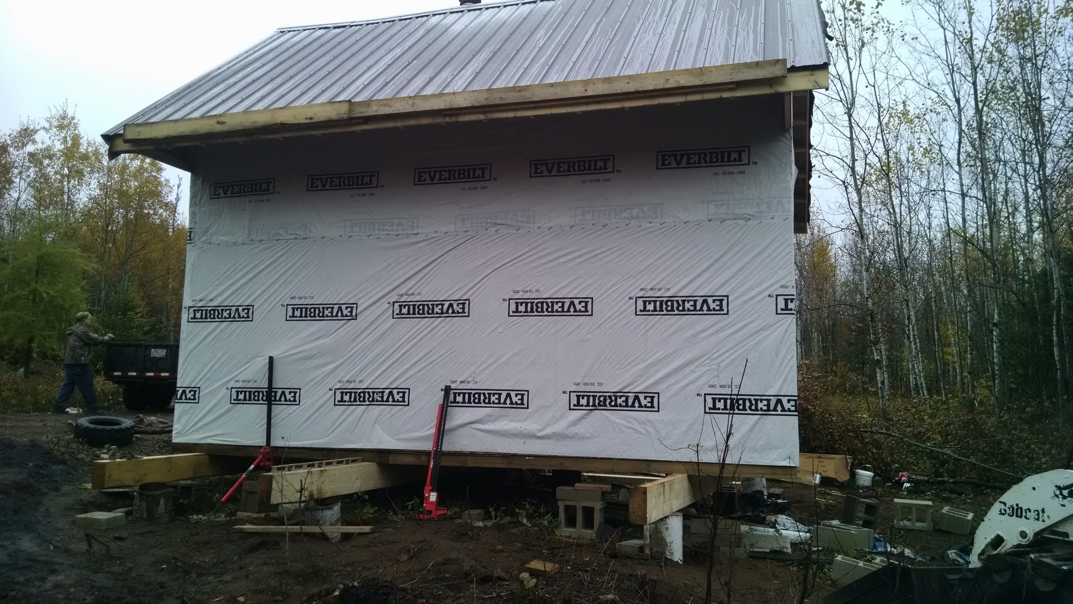

Decided to set the cabin on 12" diameter concrete posts that are 5’ deep. This way I don’t have to worry about the ground freezing and heaving up the cabin. I had a local sawmill cut three 5" x10" beams 20’ long. The beams stick out 4’ on both sides for a future wrap around deck and porch.

Hey Bill, Don’t forget ground cloth as a vapor barrier.
