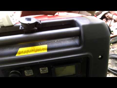

A big relief for me today. I was able to get my Chinese Honda clone inverter generator to run both my plasma cutter and welder. They didn’t make it easy for me though. They used European receptacles on the panel to plug into. The circuit breakers are set for 20 amps and they used 14 and 12 gauge wire behind the panel.
I removed the factory receptacles and replaced them with a twist lock. I also made a 3’ extension to plug into.
I tested the welder first and it didn’t work. I then tried the plasma cutter and it worked well. I went back to the welder and fund the grounding clamp was corroded. So I cleaned it up and put a new bolt in it and now works well. I welded on some 1/4" stock scrap left over from my chunker.
Now I need some input. Is a welder hard on a generator? It is a pure sine wave generator so it should be okay for the welder. I’m worried because the welder may be constantly be pushing max capacity when in use. It does have an ECO switch so it idles down with no load. I do understand I will need to use this with gasoline only because wood gas may not provide enough the way it is.
Anything else I may have over looked?
It will draw current as needed; the welder never uses its rated amperage unless you’re welding on max heat settings. Most of the time it should be well below the rated amps. You can probably weld gasifiers all day long and it will never notice.
Thanks Chris. I guess I should have reworded that. I meant max capacity on the generator. I have pushed this welder hard but haven’t exceeded it’s duty cycle. I suppose the circuit breakers will pop before any internal wires would fail?
HI Bill S just wondering how good that cuts 1/8" miled steel under 5K watts.I am surprized it cuts at them lower watts.I see your getting the fort up,looks good and sturdy.
I’m really not sure about the milled steel. I imagine the same? It went through the ¼" fine.
