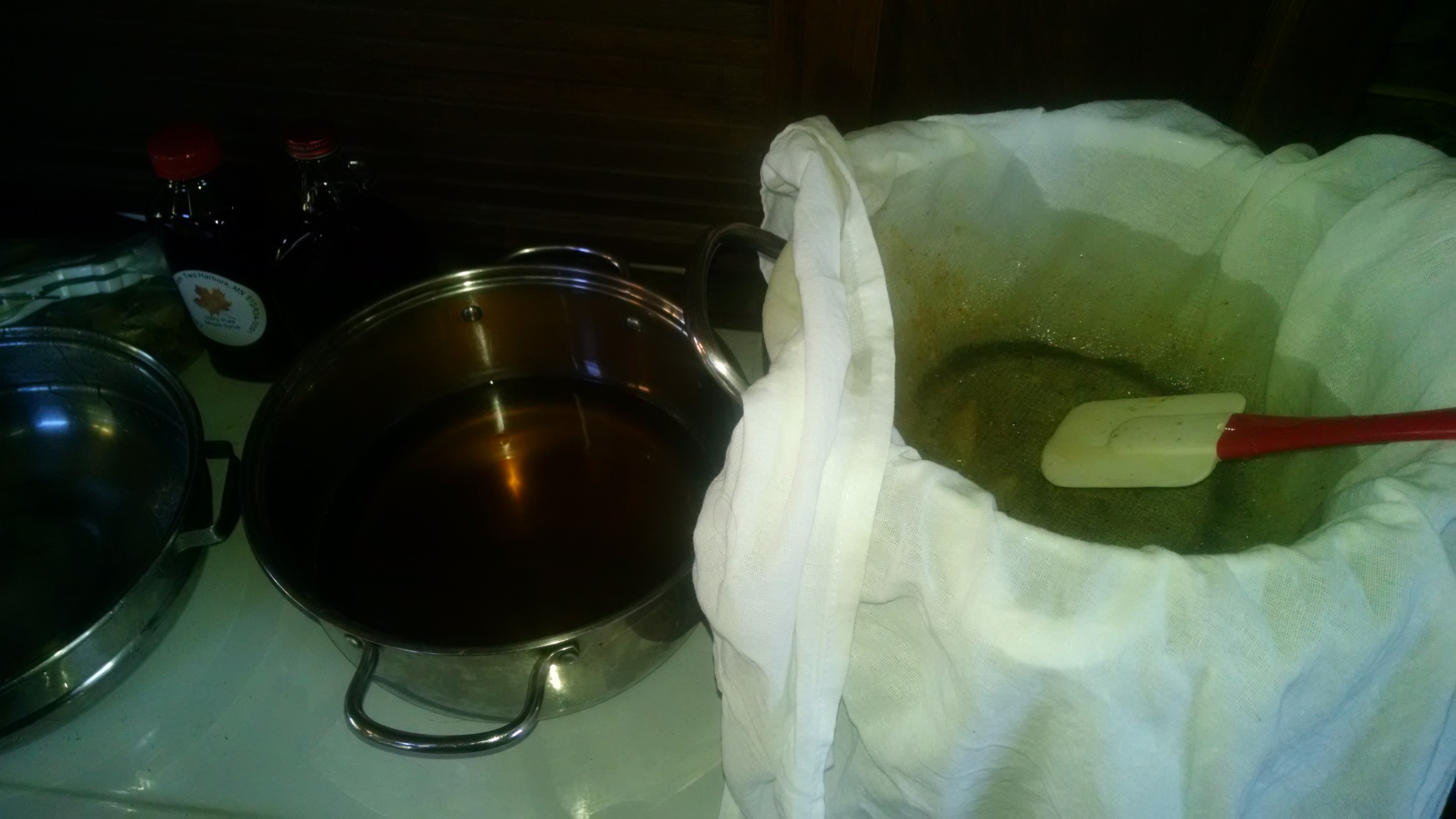

Well, my fears of not having a Maple season became reality. The other syrup makers here suffered as well. We went from winter to summer like flipping a switch. Very minimal flow.

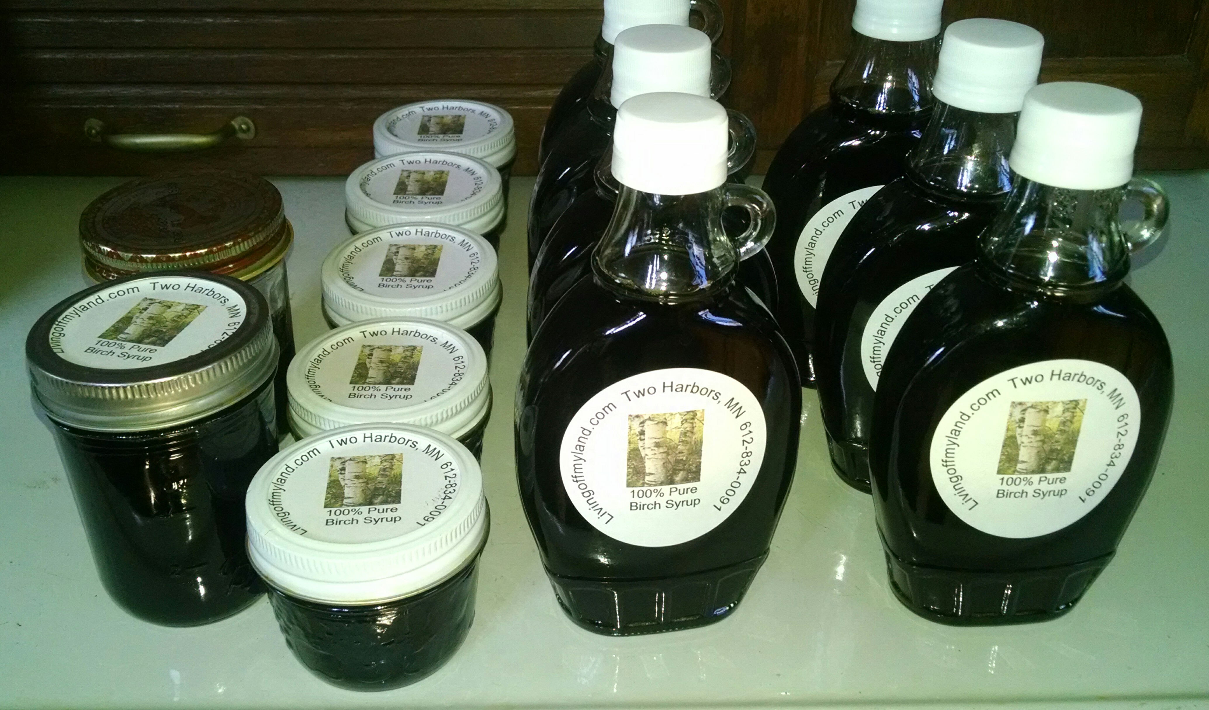

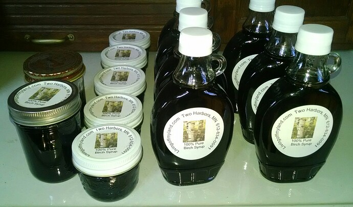

So, I pulled the taps, sanitized them and put some in a couple dozen Birch trees. Very good flow. Two to four gallons of sap per day per tree. The ratio is anywhere from 80-150:1. The process is also very time consuming. One has to be careful to not burn the different sugars Birch has. The upside is, Birch syrup can demand $3-500/ gallon. I learned a lot on this first batch and will be making improvements on my evaporator to speed up the process.
I made up some sample jars to bring to some high end restaurants.
I also have people buying Birch sap from me for $1/ gallon for it’s nutrient values. This is what I call, “living of my land”.
