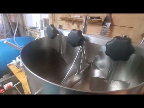

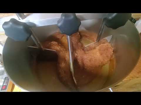

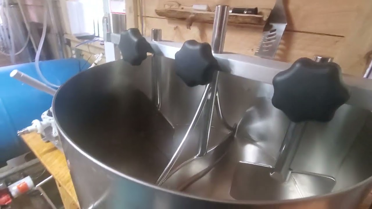

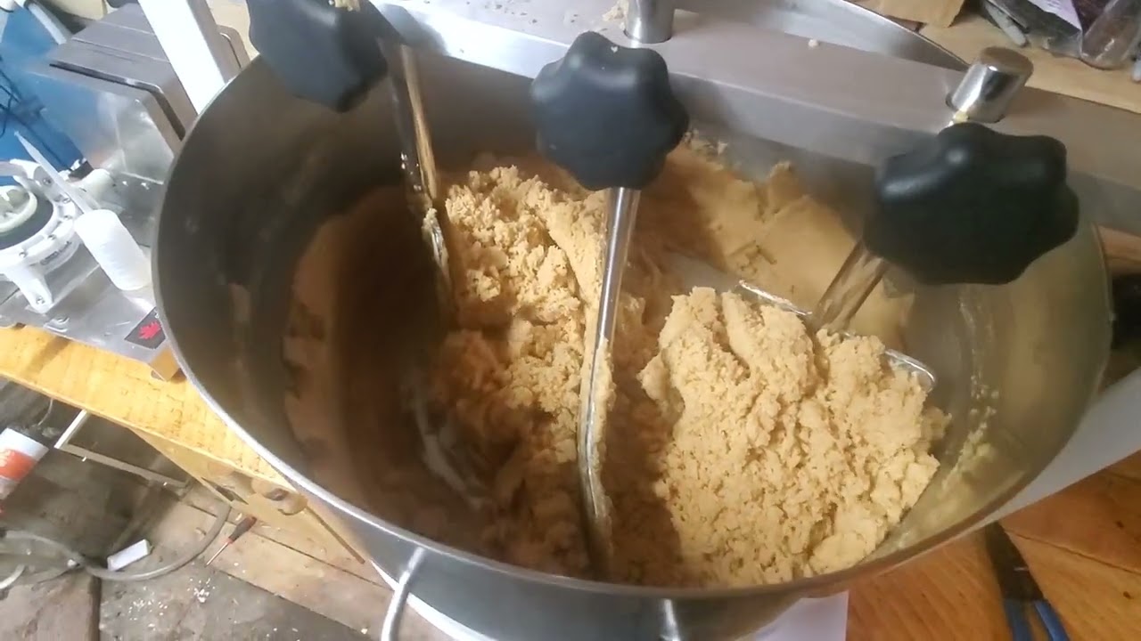

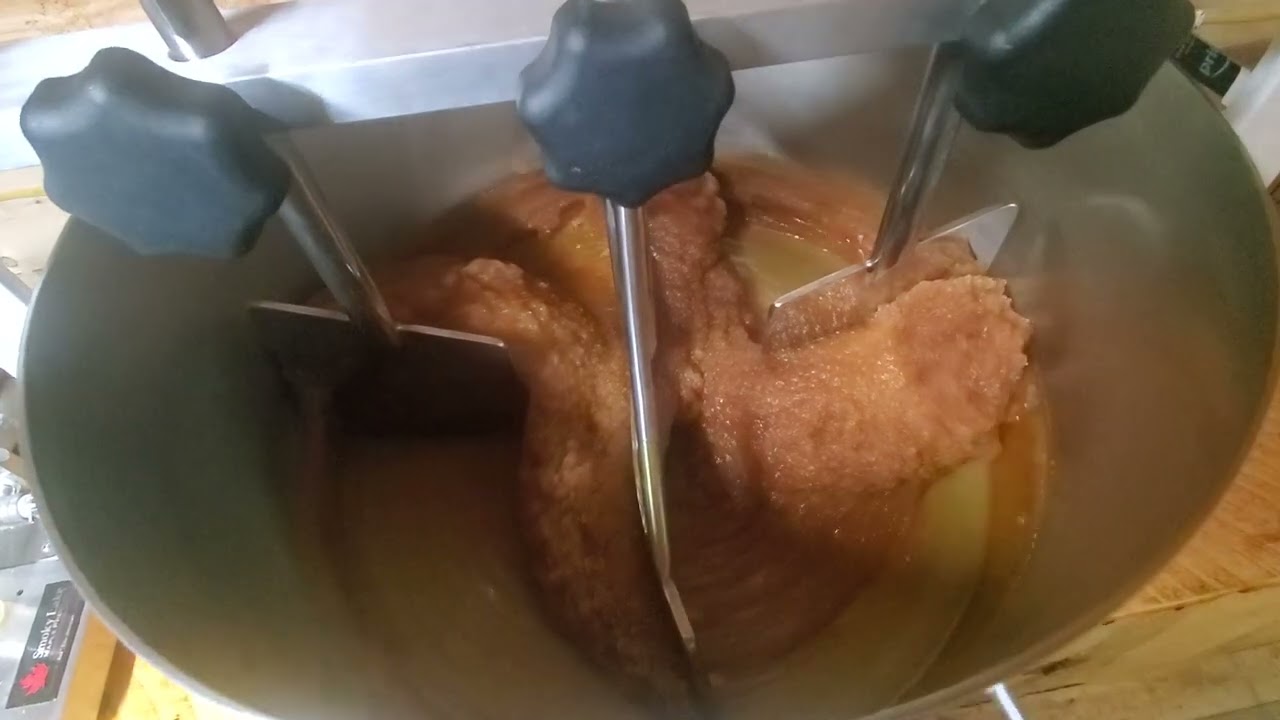

I bought a 100:1 gear reduction box years ago thinking I was going to use it as a chunker. I was informed it was going to be too small so it sat on the shelf. Fast forward to this year. We increased our production of maple syrup and the demand for maple sugar has also increased. We sell sugar at the markets and use it to make pine cone syrup.
Pine cone syrup has many health benefits. Its antimicrobial, antiviral, anti-inflammatory and has many other vitamins and nutrients. It increases t cell response according to a NIH study.
Well my son in law is a stainless steel fabricator at his dad’s shop so I asked him if he would build a food grade sugar maker. I gave him my vision and the reduction box. He, my daughter and grandsons chose to spend a week vacation with us this summer and he brought the new sugar maker with him. Here it is in action.
What does the stirring do? Help agitate to let water evaporate from the syrup to dry into granules faster?
Bill, you and Mary are amazing in all that you do in the time that you first moved up there. You should really document your life in a book. It might be a best seller!
The syrup is heated up to to 265⁰ to evaporate most of the water prior to stirring. If it wasn’t being stirred as it’s cooling down, it would turn into rock candy. Stirring it allows it to granulate.
