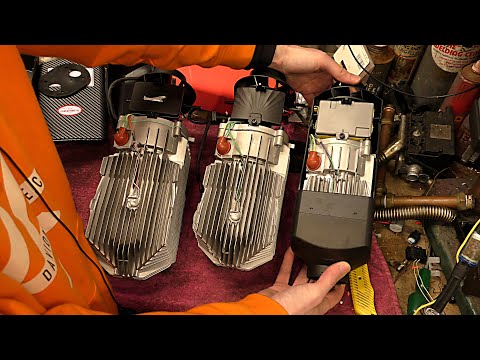

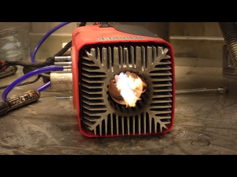

Steve if you watch this guy , he is by far the most sensible of the heater users that i have seen and will say what’s what without bullshit , if it can be done he will do it if not he will warn against .
Thanks Dave.
Now what’s inside . . . ( This guys a hoot, he talks to himself like me. Traps his finger Outch! just like me too.)
Then a year later sizing systems comparison:

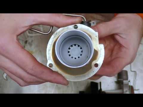

And BillS., he has an after 2000 hours operating internal cleaning video too.
