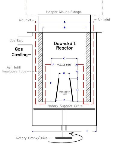

Hey DJ, I’m drawing Imbert plans for my 1977 GMC C15 with the 350 engine, and your pics are so helpful! I wonder if you could share some dimensions that would help me immensely. See the drawing for what I’m looking for. Let me know which is most critical. (Are you happy with the power or amount of wood gas you’ve attained? What kind of temps are you getting at the reactor or the gasifier exhaust? Did you have problems with the leaf spring bracket beneath the bed? Should I build the same size reactor or scale it down according to engine size?)
Hello Nick,
You cannot use my 454 dimensions for your 350 engine. On my website http://woodgas.nl/ you find the calculations for an Imbert. You might use slightly lower gas speeds in the reactor than mentioned. I find lower speeds work as well when the hearth is well insulated. Lower gas speeds add to the power of the engine because of less restriction.
Power is very good. Wet filtration sucks, your engine will be partly coal powder powered. I have no idea of temperatures in the hearth. The bracket was no obstacle.
