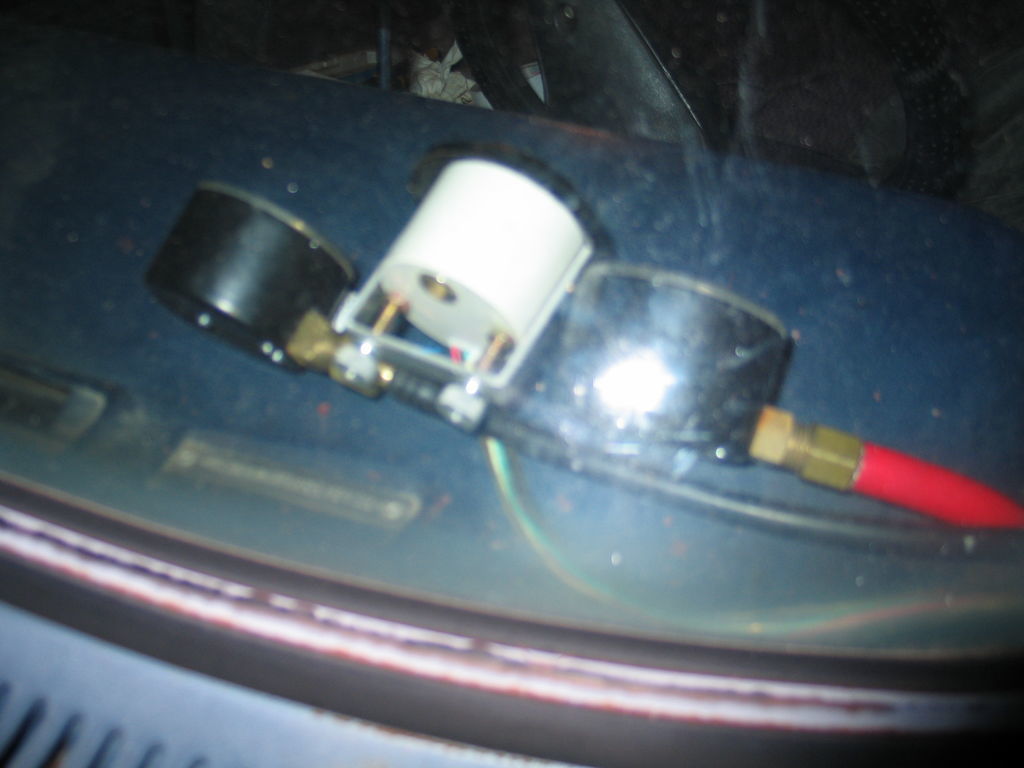

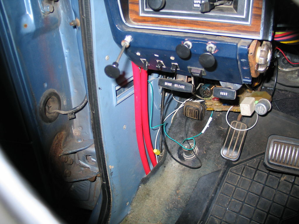

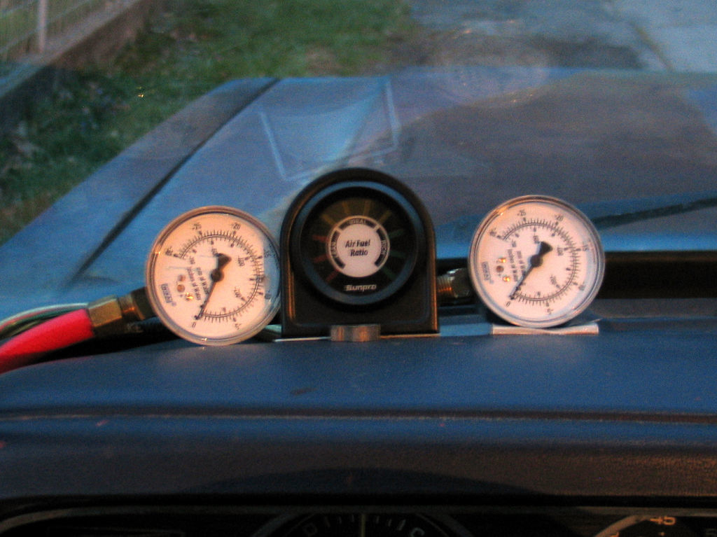

Moved some gauges! I’ve been meaning to do this for a while. Vacuum gauges are easy to move, just run a vacuum line to the cab. Easier said than done…

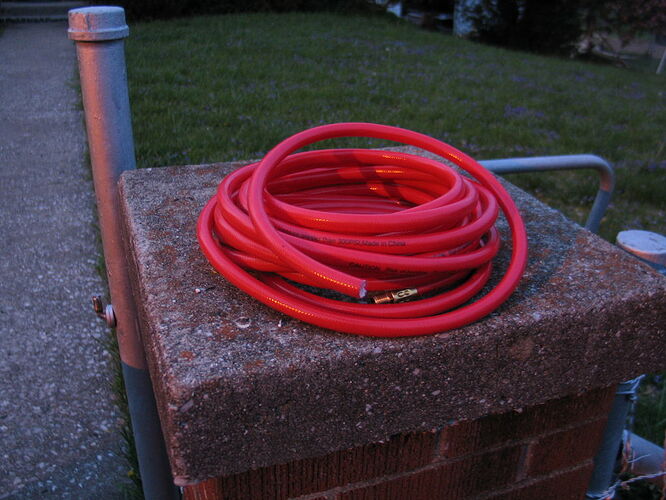

I went to the auto parts store and asked about fuel line and vac hoses. They wanted $1.20 per foot! Since I needed about 25 feet, that didn’t sound so good. So I went over to Walmart to see what I could find (I don’t know what I expected, maybe aquarium tubing).
What I found was a 50 foot air compressor hose for $12. Not bad! It’s bright red, but otherwise seems to be a really easy solution. Even comes with threads already attached, ones that match my gauges. Note that the hose is a tad big, I had to use a section of smaller hose as a reducer for the barb fittings. Still very sturdy and will serve my purpose well. And there’s enough to do another truck (photo is leftovers).

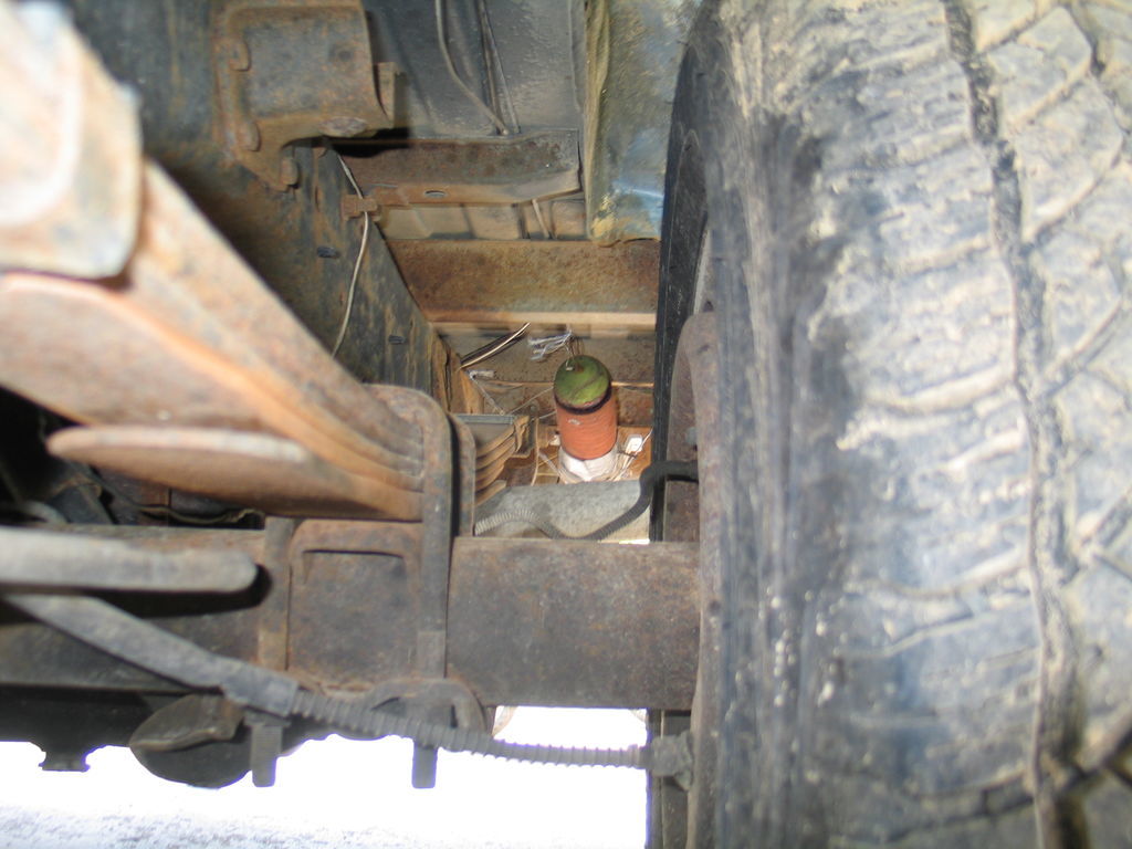

So I ran the lines from the original vacuum gauge locations (hopper and rails) under the truck and through the floor. I now have the gauges on the dash. They’re sideways, yes. But I’m not too picky. I may make a mount for the three gauges later on, plus add the backlighting I showed earlier.
Can’t move the temperature gauge without a digital gizmo. But for $12 this was worth doing!
Looks good to me, I’ll bring some LED tape to Argos for you to try.
Good thinking, Chris S.! That trick should get added into the book in later printings, along with the hopper drip guide.

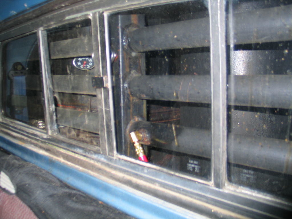

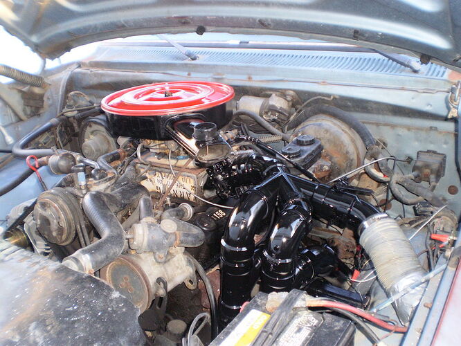

Replaced the water pump, timing chain, radiator, belts hoses, thermostat, coolant and oil. Hit various pieces with some black paint as they came off the truck, came out pretty nice. Smog pump is now gone. it’s running great. Smooth and quiet with the new belts, and the timing chain is much much tighter now. (Any doubts about yours, go ahead and replace it! You’ll be sad if it breaks/skips).
I’ve got some video of the repairs that I’ll post when I get a chance. Meantime here’s some pics.

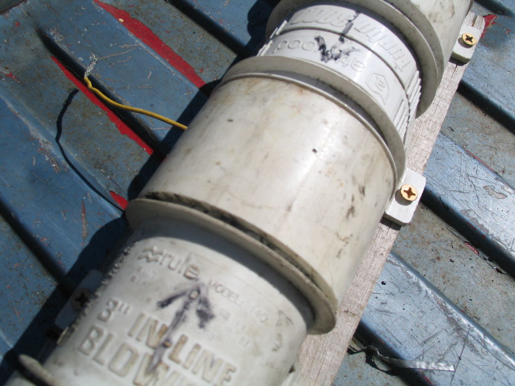

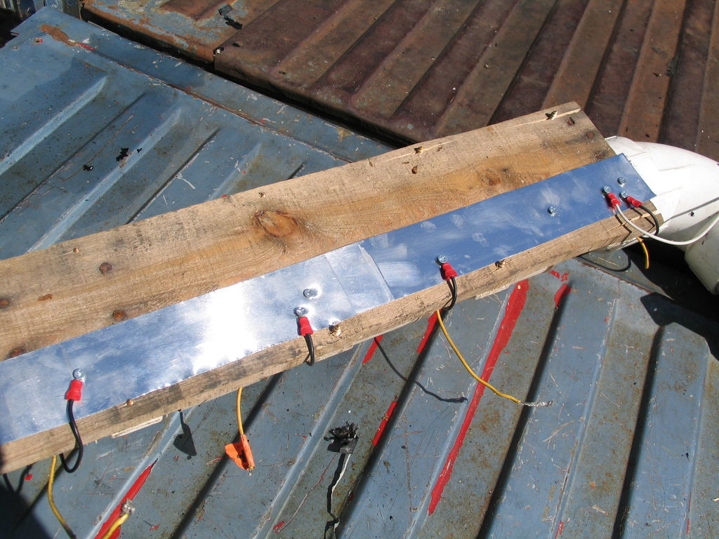

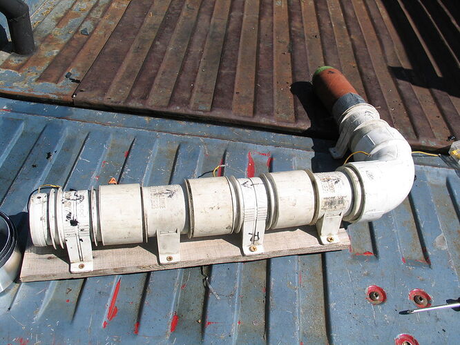

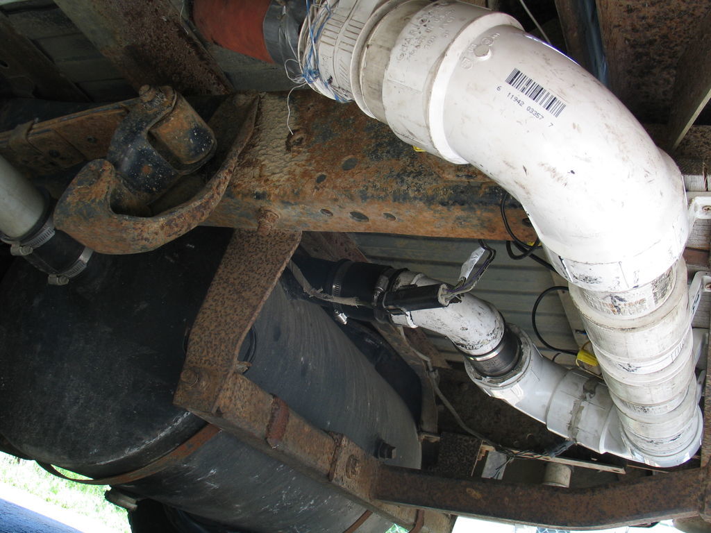

Reworked the blowers this morning. They had been working OK, but the tubing connected them from the inside, and there was some flex tubing involved.
Now they are connected via 3" PVC, which is a perfect fit on the outside of the blowers. Then for rigidity I screwed them to a board and mounted them all in a line. The back of the board got a strip of aluminum flashing for a common ground, which greatly simplifies the wiring.
I put the last one on a 90 degree L so the pull-string from the cab is in direct line of sight to the tennis ball valve. Works great!
