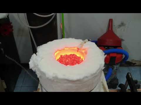

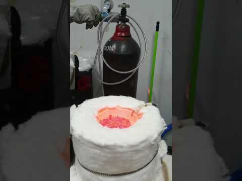

Whoo, wait!!! Need a little more description–especially the last picture!!! :thinking: Is the one picture a fire tube made out of ceramic wool?? TomC
Hi Tom,
Its a ceramic sleeve with refractory around it and then ceramic wool to insulate

my guess is that they used less pure gas for the 100%
Considered that the input in the reactor was Co2 welding gas only, then the outcome is as i expected but anyhow exciting.
Ok i think you covered the ceramic blanket with fire cement, Or Some other coating. Well i need too coat my ceramic blanket secondary burn chamber on my water boiler, due too i can feel the ceramic particles floating around the the heating stove areas. The next ceramic blanket stove or gasifier is getting coated on serface before it go’s intoo Use. too keep the particles from migrateing around, Hope its not as deadly as esbestes. Works good at keeping the heat in though.I am coating the one im useing before next winter.BBB.

Hi Koen good evening, or its evening now. IT looks as if you poured raw iron strait in your ceramic kiln , no other metal pot,IS THAT HOW IT CAN BE DONE ? I want too melt some aluminum sooner or later.Thanks for posting your outfit forge design.LOOKS NEAT.
PEET THanks for posting the rigidizor. think i am going too water glass serface of my blanket, it wont get much over 1000f after i add fire brick over blanket. this unit of mine is not as hot as forge, the water glass i think will suffice for rigidizor top coat dust seal. Koen might want too water glass outside of his forge for dust control measure.I would hate too be stuck in a factory spalwning that ceramic blanket on the machine.
Hi Kevin,
Ooops, no , its not metal, its carbon…
You can call it an “electric gasifier” ?
