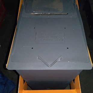

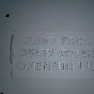

Well the polar vortex should be leaving next week and I’m going to finish the one gasifier I’m working on and I am going to run my larger one. The larger one has plenty of fuel capacity. The smaller one, not so much. What will happen if I open the hopper to put in more fuel if it is running. I don’t have any hair but I still have eyebrows. I’d like to keep them. Are they at risk or worse.
Yup keep your face away at all times during an on the fly refill and you will need to be very fast or just shut it off for refilling. If you use a batter bank its no problem then as you wont lose power and I dont know why losing power for a few seconds would be an issue anyways But you should use a battery bank with any stand alone gasification technology. Its way more efficient this way, only make the power you need otherwise it a waste and way more labor then is necessary.
Generally when we open the lid under operation or just after a run there will be some lag time and then a real vibrant blue flare will emerge and POOF! out the top of the hopper. Yes indeed I found this out the hard way and after a gasifier run I had to run down to the corner store. I put my mask on and proceeded into the store. "What the hell stinks in the store?? God that’s an awful smell!!! Yeah it was my goatee half singed off my face and now the smell was trapped inside my mask.
Thank you Matt. If shutting it off means stopping the engine then no problem. Just didn’t want to have something blow up and I didn’t know if I had to have the thing cooled down before I could add more.
yeah if you can let it sit for a few minutes that is best. If you have a big open lid like I have; then the puff back isn’t such a big deal as long as your expecting it and your keeping body and face away.;
