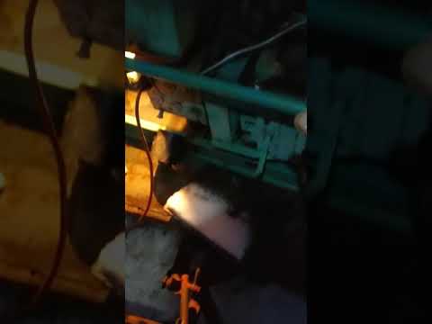

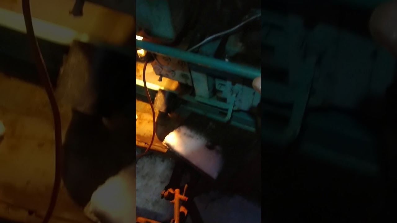

Bob, my bunker can hold ~ 40-45L of wood (~ 16kg). I drive up to 45 miles max on one load, depending on the density of the wood. But I can and will refuel on the way with the engine running. The whole construction is made neatly and does not provoke any negativity from the police. And in general, in 3 years of driving on gas, there were no problems with the police, they even respect me, I have a very interesting car.
Hi Vitaliy, Here on this site we encourage the members to do a building thread of there vehicles. Yours is complete and proven to work. You still can show how you built it, specially if you have building pictures. Also we do a lot of walkarounds with video. Just create your own vehicle title thread then go from there. You can trace my thread “92 Dodge Dakota from the book” back to @Chris Saenz when he owned it and made modifications to the truck, and then back to @Wayne Keith when he first built the truck in 2012 that produce the book on how a WK Gasifier is built.
You can do the same thing here on this site, your own special design building thread. Like many others have done.
Yes, I’d like to see more details of your build. You are getting a lot of miles out of fuel stock that would scare most people here. You must be doing a lot of things right.
Hi Vitaliy, I have watched your video more than once. Great video walkaround. I noticed on your dash board the temperature gage meter reading up to 2250 and down to 1750 ? This is in degrees Fahrenheit? Where is the prob located, at the grate? How long is the after cooling tubing under the car. Is the wood piped up from the filter to the engine compartment metal tubing? What year and make is your car?
Kama River! what is the town name?
Bob, on my tidy, you saw the engine speed. There is a plastic corrugation under the car. 1984 car.
