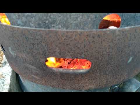

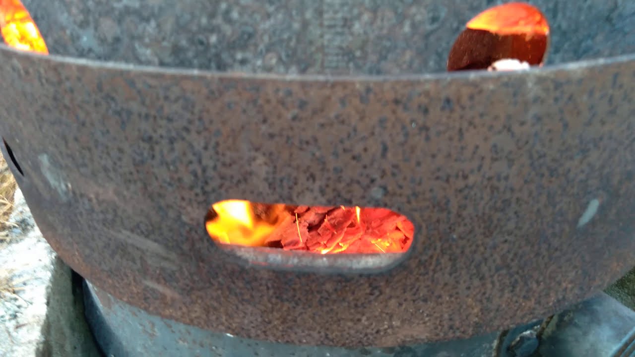

No this not how this one works. This is a two barrel set up, the lower barrel is just a catch. Kind of sorta what you are doing but not really. Because char never accumulates in the kiln, its always dropping out and allowing new fuel to be processed and layers much like a down draft gasifier. This small unit can fill that lower barrel in less than hour.

OK i sorta switched my brain on and re read a few posts and watched the video a little more , i thought the bottom of the burn barrel was just a 1/4 the size of the top barrel and thought you must have to empty that too often , but it seems you may have sunk a full size barrel into the ground , that of course would allow a much longer burn time .
Yup, it is the same size I just keep feeding and agitating the center grate to drop the char out. The heat drive out the oxygen of the catch barrel.
I let the fuel burn down about 1/4 the hieght of the barrel. I then shake the crap out of it to
drop the chare that will break apart and drop and then top it back off and then repeat.
Matt that is a interesting way to do it , i have a very large cone that stands about 3 foot high and is 3 foot square with a very heavy lid to seal it up after a burn , just like the air curtain kilns that are popular now over here but on smaller scale , my cone you just throw in what ever will fit and keep it topped up starving the coals of oxygen below works well on crappy pallet type wood once cooled i shovel it out into 55gal drums through a magnet to remove nails and staples and then seal drum till needed , we only have a small window of time to make charcoal this way over here due to fire restrictions , so most of my engine grade charcoal is made in the wood heater’s in my house , i may have to give your way a go very soon , see if it can save me shoveling out the coals afterwards .
