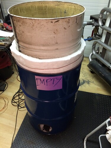

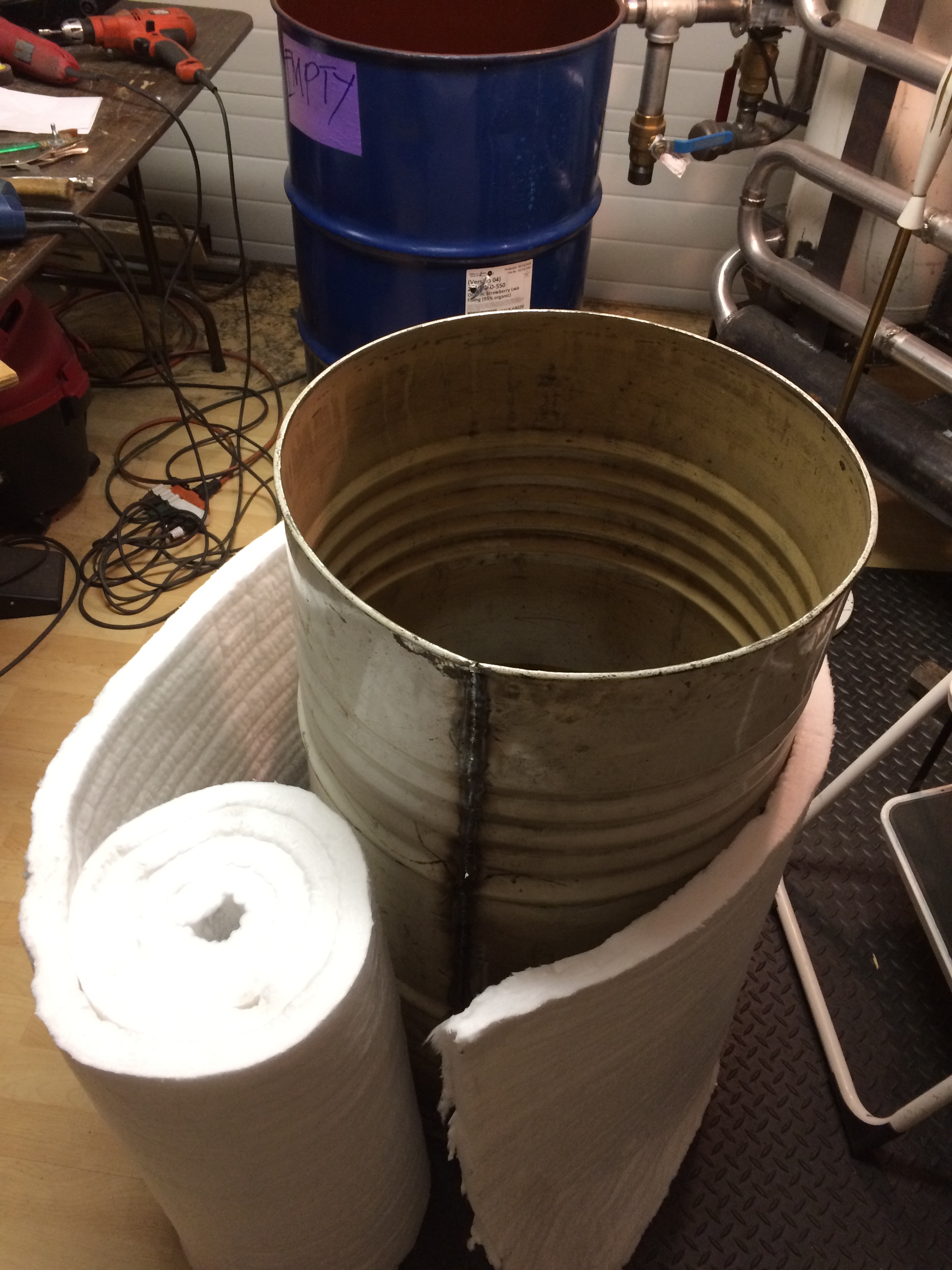

The space was one inch, same thickness as the roll of insulation. So I just wrapped it around, used a piece of wire to hold it, and stuffed it in the bigger barrel. It slid in with just enough friction to hold it at any position, unless I pushed down, so the sizing is important to make it easy.
Yes, what you describe sounds like a better design. Do all the flames and heat go up the pipe or does some go on the outside? Any pictures?
All the flames go up the pipe and extra heat is soaked in around the base of the drum as well , i found that when turning really really wet or green wood into charcoal i could start the fire on floor waste and when i wanted to go indoors for a cuppa i would throw some logs on and they would last ages slowly drying the wood inside , when the fire ban is off here i shall rebuild my drum and the pit i stand my drum over i shall insulate with fire bricks to keep more heat into the drum as well . i shall see if i can find any pics , but my set up is so ugly i squint my eyes every time i walk past my set up :smile:

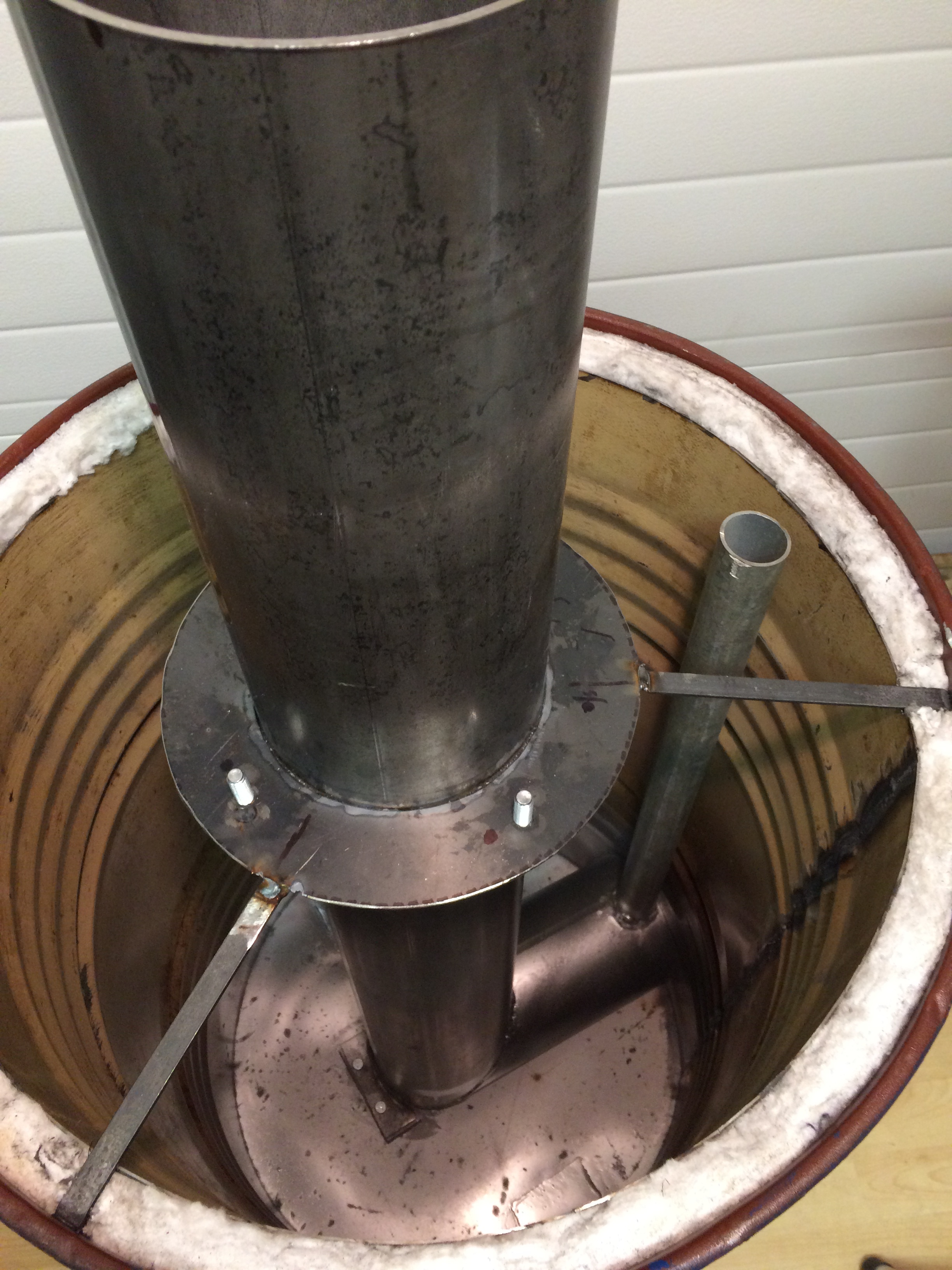

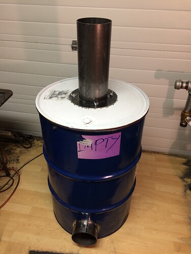

Made a little progress today. Six inch diameter L shaped tube (1/8" wall thickness) is bolted down to 1" x 3" tube under the floor. A Saturn-ring/flange welded to the L tube holds the tube in position and also serves as a face to tighten the lid against. Fire rope (not shown) fills any space in the crack. I haven’t decided how to insulate the top yet. And does it need some kind of opening in the lid with a check valve to release pressure, or is the pipe carrying gases down to the L tube enough? I plan to seal the crack around the lower L tube hole with furnace cement. There is a ring clamp to seal the lid, but it is not shown. The L tube assembly is bolted to the barrel and can be removed and replaced without welding. I still need to complete the chimney.

I am not suggesting you change your design. But i might have opted to run the gas pipe out the side then down to save space inside the retort, and maybe cool the gases off a bit.

Where does the gases escape? Are you going to feed them back into the rocket stove?
Maybe I’m misunderstanding what this is. I was thinking this was for making charcoal. Am I wrong?
Looks nice. Yes, you will need a way to vent the moisture out through the lid. Use a valve on that vent that can be shut once the escaping gas becomes rich enough to ignite.
Hi Greg , just as Bruce suggested with the pipe out the top lid to vent off moisture , always try and keep that pipe straight with no 90 deg bends as it will soon fill up with tar and gunk .

Yes, @BillSchiller, the thing in the blue steel drum is for making charcoal.
@BillSchiller When the wood is heated from the rocket stove, the gases from the wood go down the smaller vertical tube into the rocket stove, hopefully to help the fire.
@bsoutherland It makes sense - Let it vent out through the lid when it is moisture and force it down into the rocket stove when it becomes flammable. Thanks for clarifying. I’ll be sure to build a lid vent.
@d100f I started with Hookway’s design and I’m trying to improve it. I should be able to test it in a few days if I don’t get too distracted. How high above the lid do you find is the best length for the chimney?
