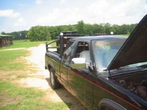

This video I am testing a truck before the gasifier was built .
