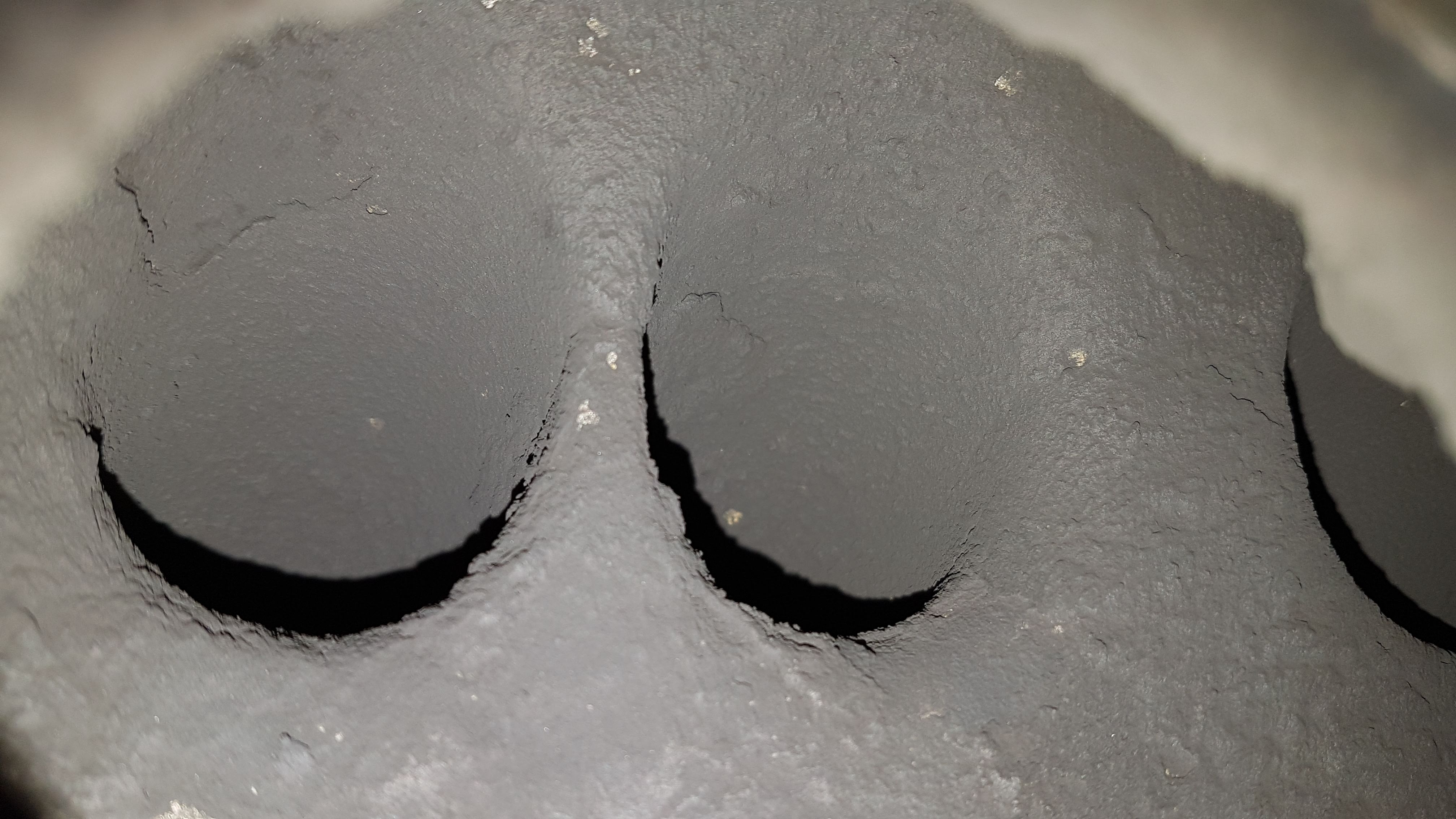

Is there a lot of soot in the intake tube?
How often do you have to clean it?
The throttle plate and the housing right next to it get the most buildup. I put the torch to it maybe every 2,000 km or whenever soot starts to interfere and I have a hard time keeping my idle down.
This is looking into the intake this summer when I dismanteled the throttle body.
Edit: At 11 o’clock in the left runner you can see soot starting to flake off. This is what we try to avoid by burning the intake every now and then. Different engines respond differently when flakes enter the intake valves. From what I’ve heard the 318 V8 likes to backfire, the Mazda makes valve/rocker arm noice but the Rabbit could swallow anything without even a burp.
