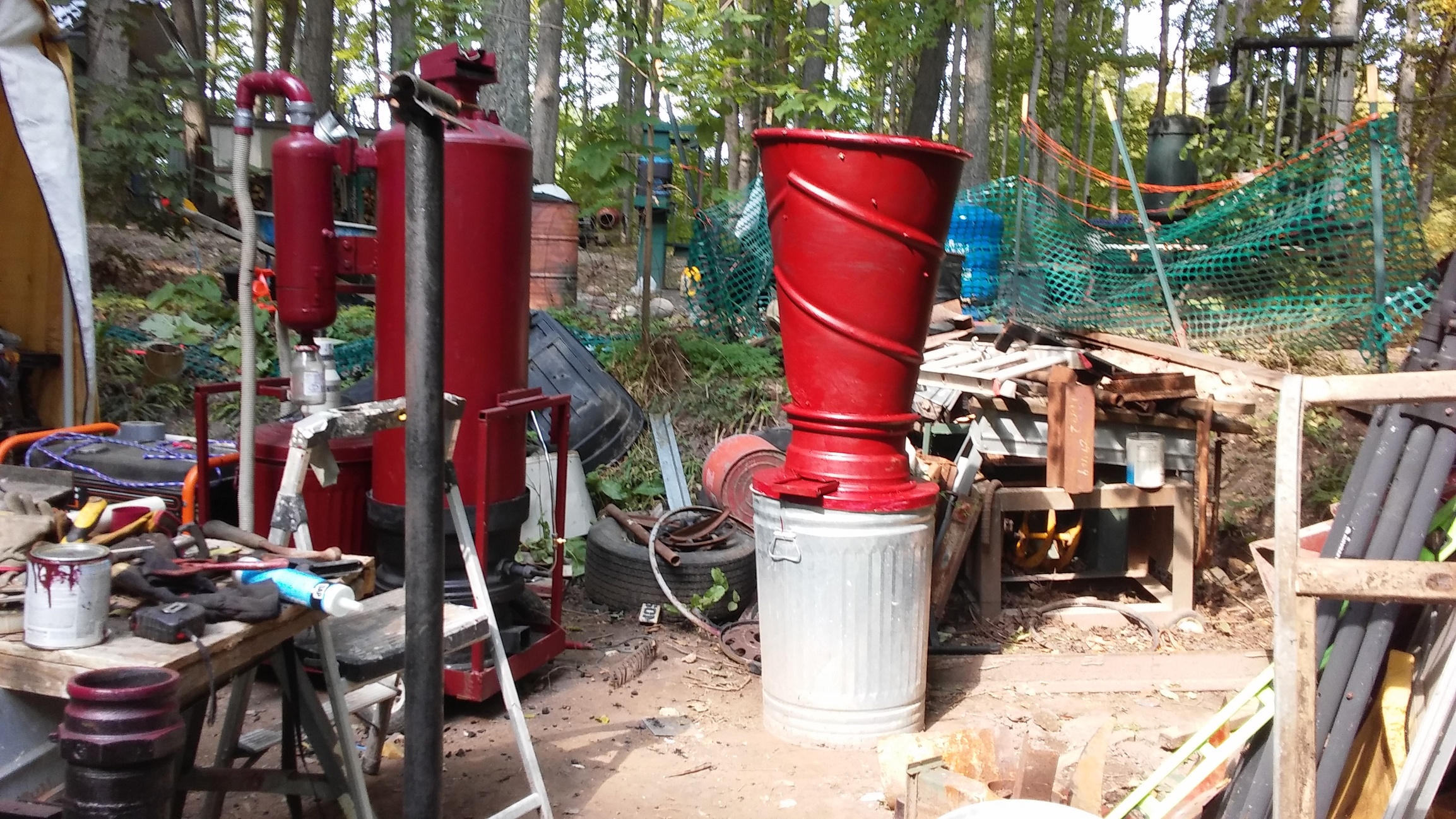

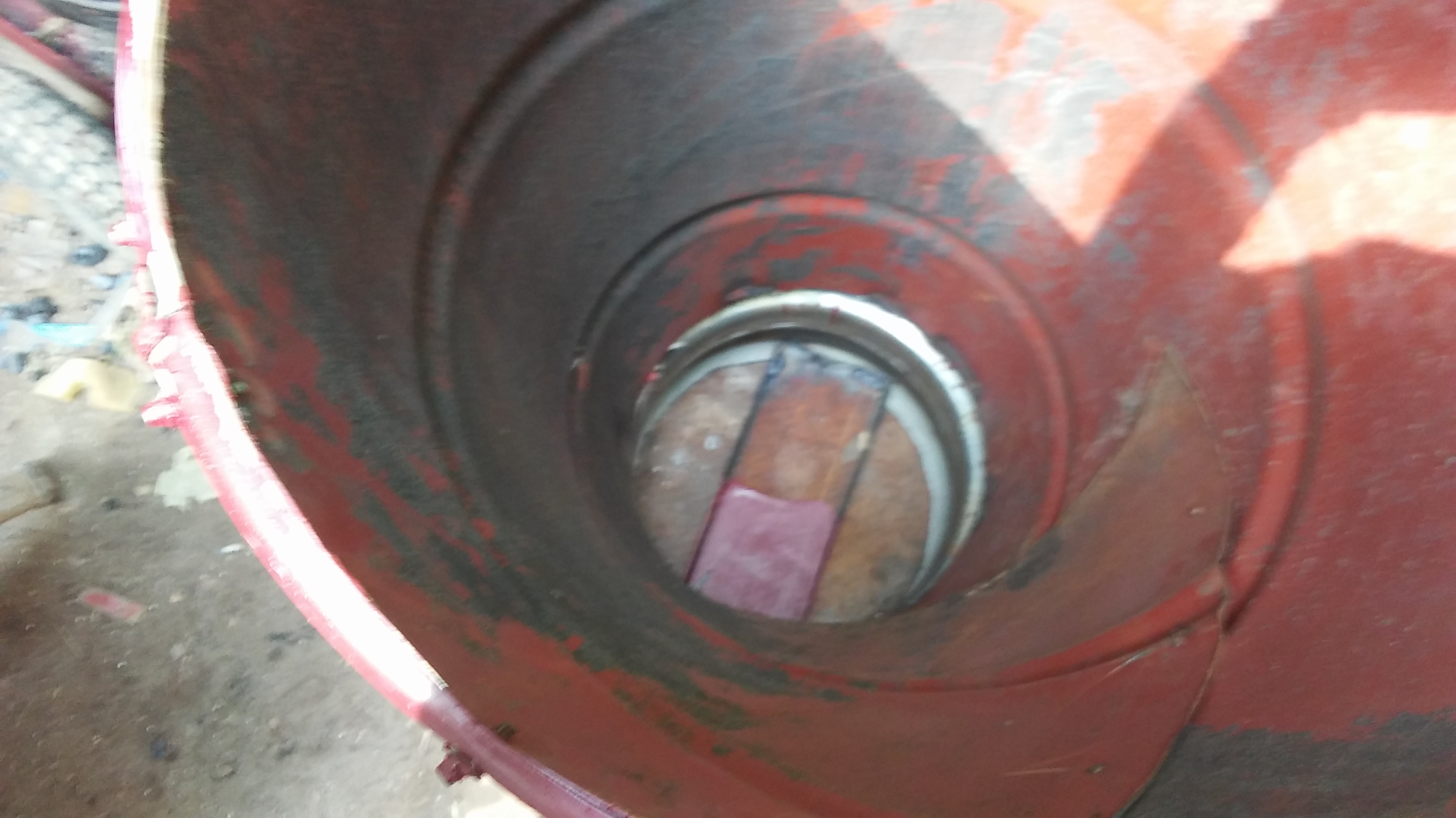

Didn’t really know where to stick this but since I made it after watching Don Mannes video I put it here. This is a cone shaped charcoal retort made out of a 55 gallon barrel. It took four hours to build this. About an hour of that was grinding the center out of the wheel. I cut the bottom of a 55 gallon barrel including the bottom rim and sliced long ways. I wrapped two ratchet straps a ways up from the bottom and tightened them alternately until the bottom was about a foot in diameter. That was about as far as it would go without cutting material out of the fold. I had a piece of wheel rim that was about that size that I tacked around the barrel skin and having cut the center out of another 14 inch wheel, I welded the rim section on the cone to the full wheel. I cut a slot out of the bottom of the wheel so that a plate could be slid in and out of it and cut up the lid from the barrel with a slot in it and screwed it to the bottom of the wheel and then put the base of a 50 gallon water heater skin under that. The plate slides in to cover that slot in the bottom. The water heater base fits snuggly over a 30 gallon trash can. The thinking here is that the cone will burn sticks like in Don’s retort and then the plate can be pulled out and the char will fall into the trash can. When done the slot can be closed and another load can be burned and cycled though. Then the area above the slot can be sealed with a piece of fire blanket to stop the char from burning. Really wasn’t as complicated as I made it sound,
Hi Tom , boy you do like hard work don’t you :grin: , i hope your a very tall man because i can tell that i would need a pair of steps to get up to the top of your cone to feed and look at it . cant wait to see some photo’s of your burn .Nice workmanship on your metalwork too by the way

I just enjoy building stuff Dave. I keep busy all the time. Just wish I still had better tools and materials to work with. Yes it’s too high. I just stuck it on that garbage can because it fit. There is an area behind where all the junk is that higher and about level with the top of the wheel. It will get moved there to use and I’ll cut some kind of clean out door into the can.

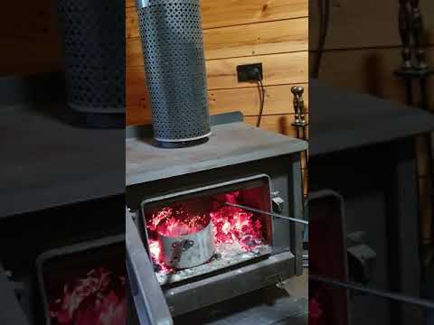

Hi Steve , i cant remember if i ever did post pics of me shoveling , what i will try and do is ask my wife if she would be so kind as to make a small video later on and i will load it up on youtube, but its a non rocket science way of harvesting charcoal , instead of throwing huge big logs onto my fires i split them small so they burn faster that way they produce more charcoal a lot faster , or i will use hardwood pallets they are even better at making real fast charcoal , as the flames start to die out in the fire i will open the door and with the shovel move some of the embers over to one side and then place a saucepan inside the fire and shovel the coals into it take it out once full put the lid on then load up another saucepan making sure to leave a good enough amount of embers so when i throw more wood on it catches alight pretty fast .
i then leave in pans to cool down for 20 mins and tip them into 25 litre containers outside to fully cool while i refill and start all over again .
My stove does not have a grate , shame really as it would cut down on the amount of ash , but in a way its all good as i load inside the fire nearly all the ash that fly’s up while shoveling is sucked up the chimney .

Steve here is a very short video as promised of me before before i refill the fire with wood this morning ,

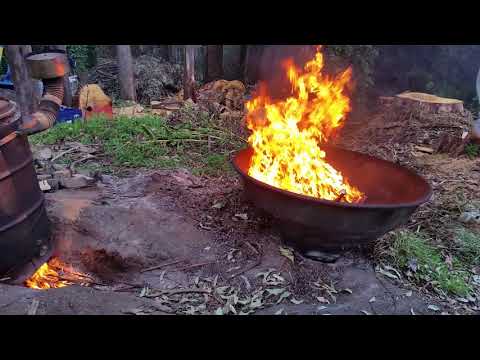

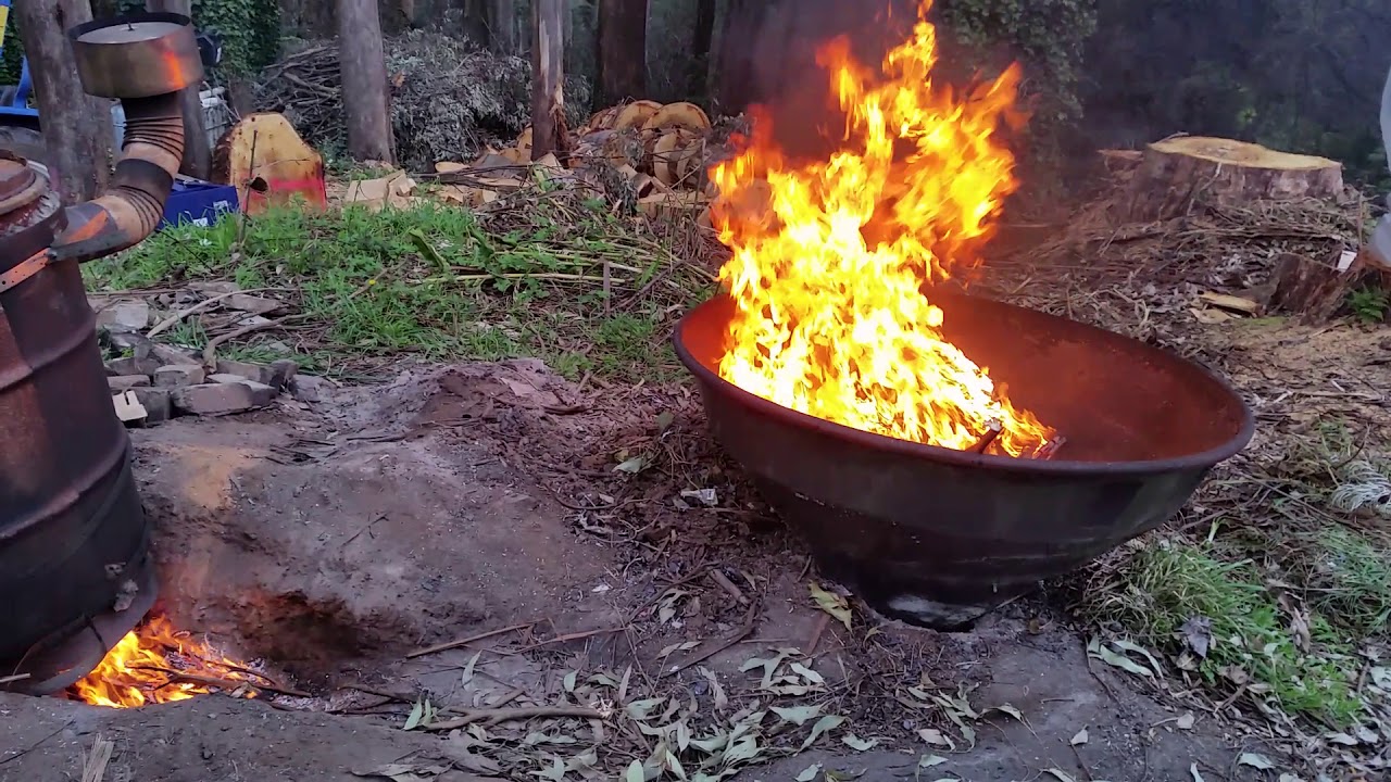

also here is a video of my cone burning gum leaf’s notice how fierce they burn and next to it is my version of the hookway i built shame i didnt get more of it in the video last year

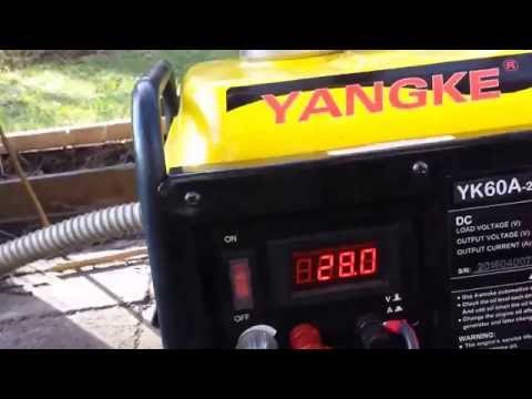

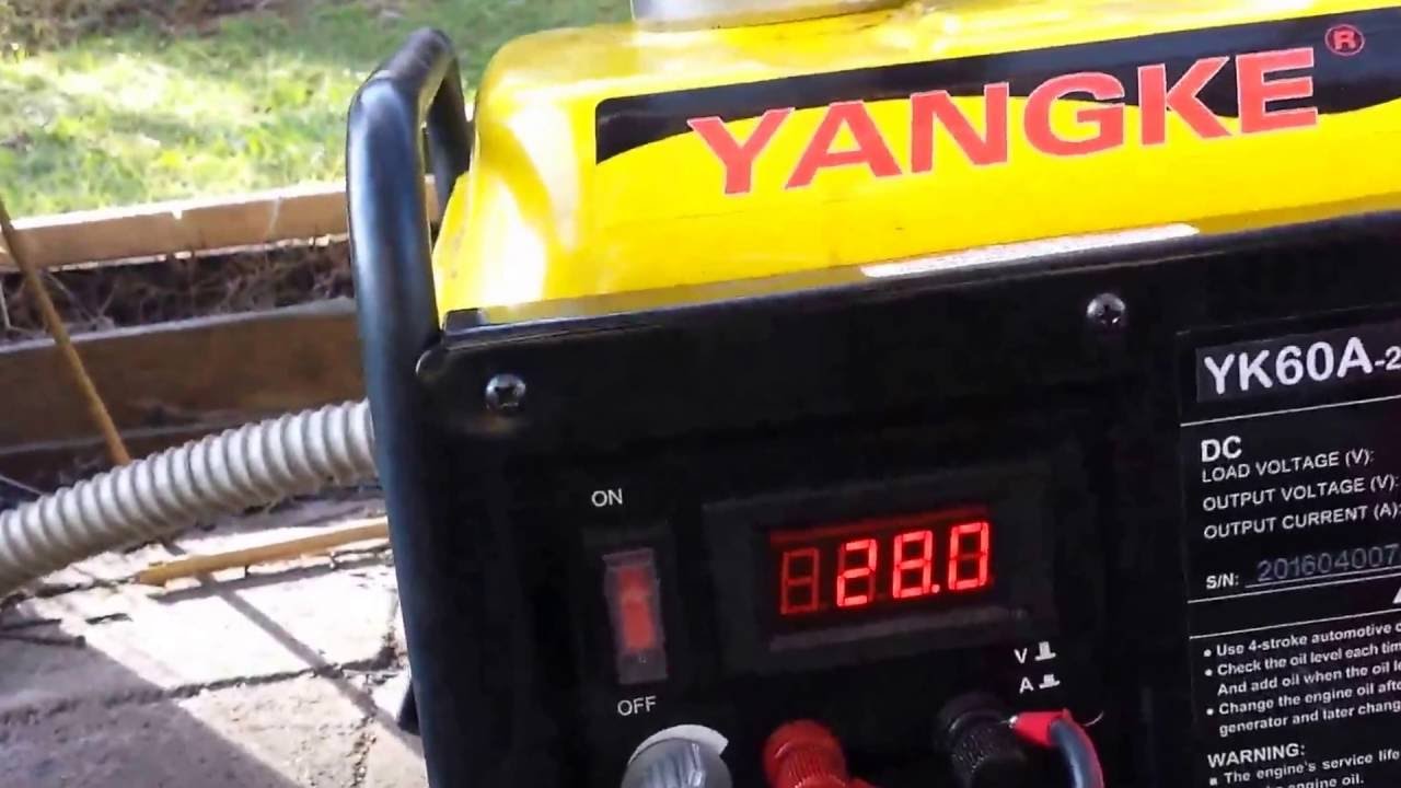

and this was a very cheap dc generator running on one of my old gasifiers made from a old propane tank
