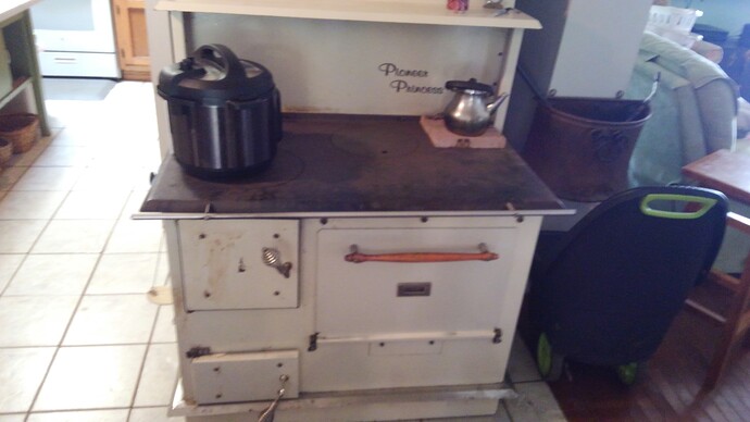

We have this one in our house. I don’t like it very much
It is hard to clean. It is smokey and has two small of fire box. I am now thinking of suggesting. Just taking stove principles and combining them to make a good stove.

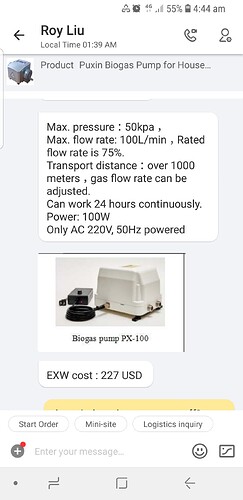

Yes that will be my plan if i cant find a pump that does the job. The trick will be finding what pressure it will need to cut off at and if the there is a switch that goes down that low. All switches iv found is very high. Here is the pump i was looking at but i might have found a better suited pump just need to hear back from the supplier.

I have the specs of the pump but the supplier but not the like yet. But this is what i have. Its a 220v pump im not sure if that will work fir you depending where you live.
