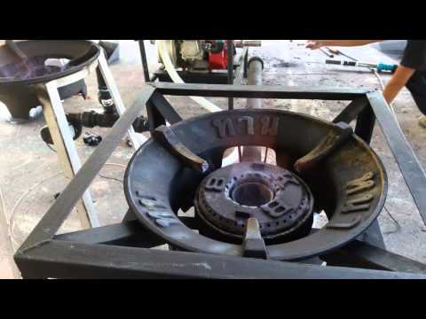

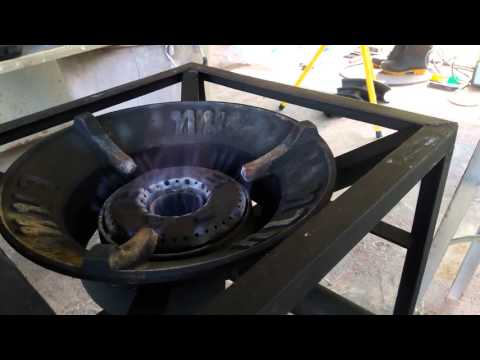

Playing with water…
Also learning about the visible effects on the gas…
here you see the actual water getting injected in the lightning port.
After extensive playing, the moist in the charcoal will result in the red color.
I was running on 2 cooking stoves simultanious, finding out the turn down ratio and how deep the quality of the gas goes, still allowing me to start the engine when needed.
Once the temperature is nice settled again an the charcoal bed at ease, nice blue color re apears. A wunderfull world of experiments :wink:
smile at the reving sound after the water gets squirted in…

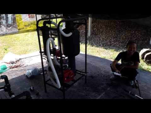

Working on the alternator setup for the electrical Trike…
Stripped the regulator and feeding now with a PWM
Original its a 80 amps 24V, with only 12v on the stator windings i got it up to 130 Volts already.
The Trike has a 60V DC Electrical motor, 20 Amps.
Today i tried the first connection, run with wheel of the ground, no battery connected.
Worked fine, tomorrow a run on the street without the weight of the battery’s…
I want to make it Hybrid… Charcoal gasifier / battery…
Looks that it can do even without the battery :stuck_out_tongue:
Today’s test was with a brand new GX200, on gasoline yes… i was to lazy to fire up a gasifier for this short test…
