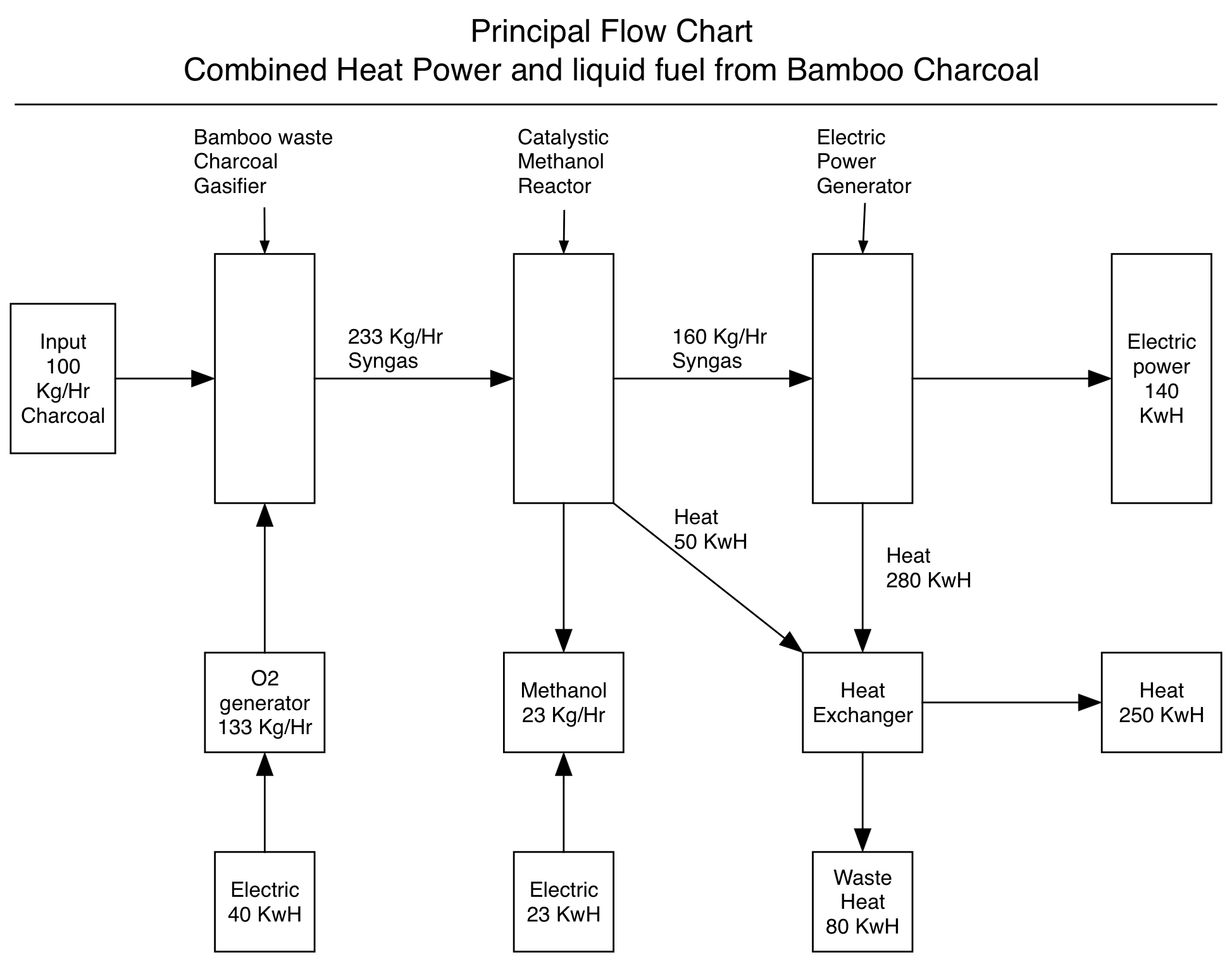

New project on the way…
You are really going all the way there. Could you describe the process that you will use to catalyze the syngas to produce the methanol or is it proprietary?
Hi Robin,
its basically a straight forward process, comparable with a car’s cat…
but with some “twist” regarding how to apply pressure and how to control the heat exchange.
combining the whole setup in one, makes it, far out, very efficient.
Actually, any system would be efficient, if you have a use for all energy evolved from the processes in use…
If i go further, with the above diagram, then how much water from the primary feedstock i can evaporate, with the 80Kwh waste heat, and even may use it to produce drinking water ? or to desalinate sea water ?
Gasification, in particular using your own grown, well managed woody biomass, is well known to be a good, if not the best solution…
Once you can handle it “farmer style” or as i love to call it, the Mc Gyver style, then you can build almost anything …
Thanks Koen. A liquid fuel from wood/charcoal would be very desirable!
I LOVE THIS DESIGN PHILOSOPHY
