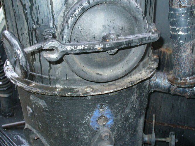

Presentation of a wood gasifier brand DULHOSTE: first photo of the bottom of the dolly with hooks held the ashes of the grid
the lower part of the gasifier wood left hooks for maintenance of the grid, at the top left the air supply with the dual parroi around the dolly, two functions the heating air before it enters the dolly and the top keeps the temperature of the dolly, then a small diamond hole sight glass to see inside the home and on the right a trapdoor for ignition kill vaulted wood.

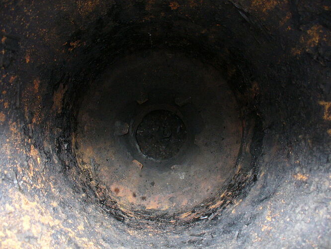

Sur cette photo six buses d"arrivée d’air en décalage sur la hauteur de 2 centimètres de haut en bas, c’est un chiffre pair de ce fait elle ne ce trouve pas directement en face, de même le type imbert, ce sont des chiffres impairs bien qu’au même niveau, alors elle ne sont pas en face pour envoyer l’oxygène.
Diabolo

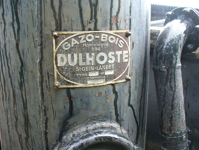

identification plate DULHOSTE
The hatch with the eye looking down
the eye gaze, the air and the door for cleaning of the ash.

I ONLY have available to me soft wood fuels. Yes they must be operated at a higher temperature for more complete conversion. And the unit must be able to pass through ~2X the volume of fuel wood chunks to have the same energy output as when fueling on denser fuelwood chunks. Softwoods are generally lower ash woods though.
On the right hand side of the picture is a “T” lock seal with a knob handle on an in and out rod. This is the grate shaker, yes?
The hearth core viewing eye is very interesting to me. Much work to make internal viewing possible. I cannot effectively operate if I cannot see inside for a real time control point. The designer/builder of this believes the same.
Best Regards
Hello Steve G, it is to shake off the grid nut right at the end of the threaded tube inside there are two half round plastic resists heat, when you intend to move the grid unscrewed and screwed back you you when you’re done to be airtight, if you look closely inside the dolly to make you notice a steel round hollow where the axis of the grid with rest and operated by a set of connecting rod by the rod of the nut. another photo of a logging truck, I love the wood in general, carpenter was my first job that I started at the age of 14 years.

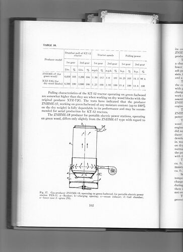

hi steve and frances
I saw your russian gasifier pics didn’t the russians have a wet wood gasifier?
I was never able to find much on it but somewhere i think i heard that they had to blow the steam off and then burn the dried wood.
I heard they really did a lot with gasification
if you have any pics i would love to look at them
thanks
Tom M.
The wet wood gasifier comes from a 1952 book :Logging Mechinization in the USSR by A. Koroleff. I borrowed mine from an interloan library system through Michigan State Unniversity. Here are some of my pics from when the woods powered their own harvest.
