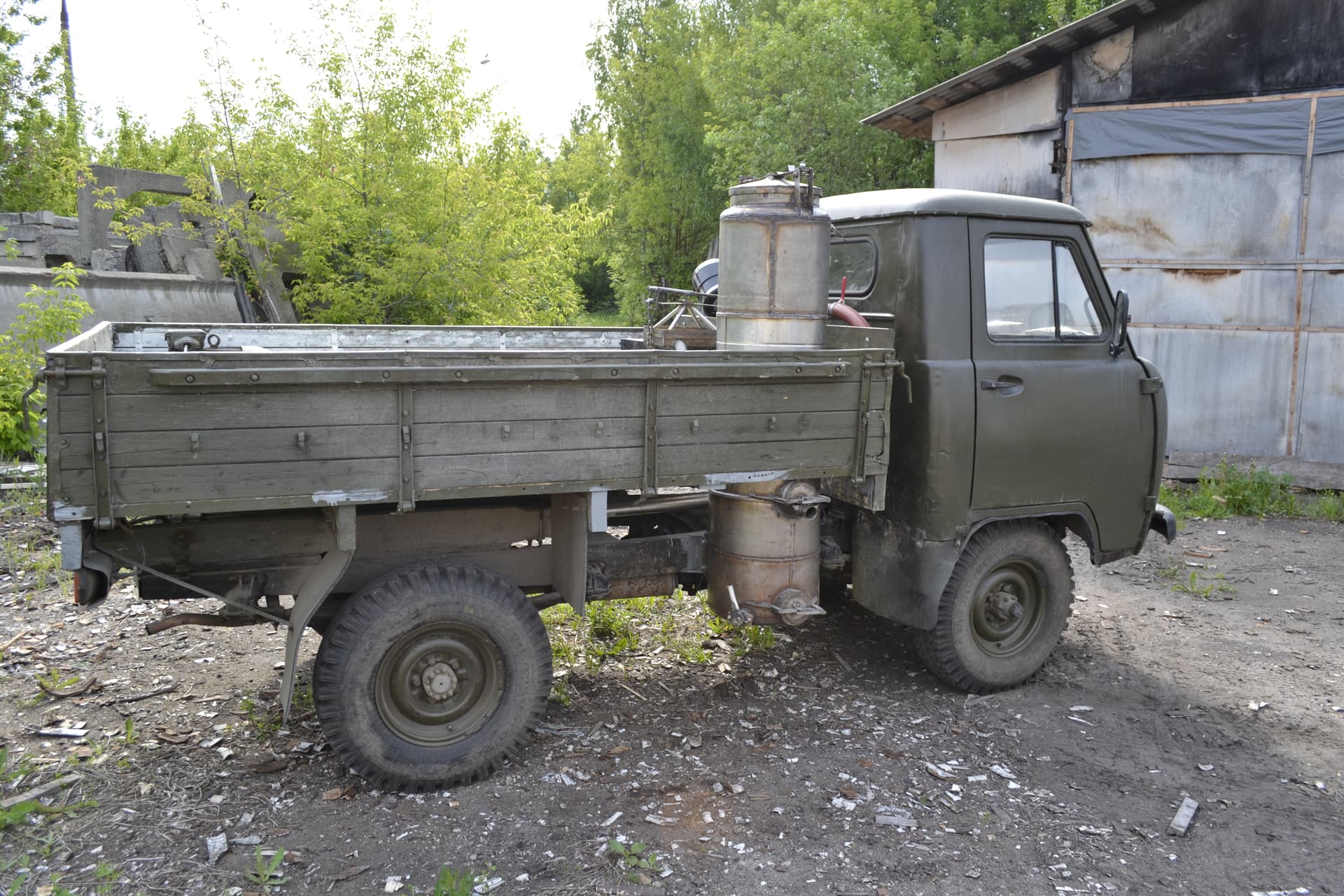

4 pedals for 2 legs is a very fresh solution!!! :wink:
This is necessary for separate brake control on diagonal wheels. On a good road, the pedals are connected together and brake all 4 wheels. If you get stuck in the mud and diagonal hanging, you can disconnect the pedals and slow down the freely rotating wheels. Due to this, more loaded wheels pull the car out of the mud. This is a kind of ABS and differential lock)))

Neat looking old truck you have there,Gasifier looks supreme QUALITY. That old truck could save a tone of money in fuels, now you need a gardon too knock down some of the crazy high food prices. OR at leiste I Do need a bigger Gardon. How fast can you maintain speed on the blacktop roads.? COOL.
Hello Kevin. We have a garden and a vegetable garden, rabbits and chickens. We also need to buy goats for milk. To completely free yourself from the power of money.)) On gasoline, the speed is 55 miles per hour, on firewood 43 miles per hour. But I don’t need a lot of speed, it’s a post-apocalyptic car, there’s nowhere to hurry.
