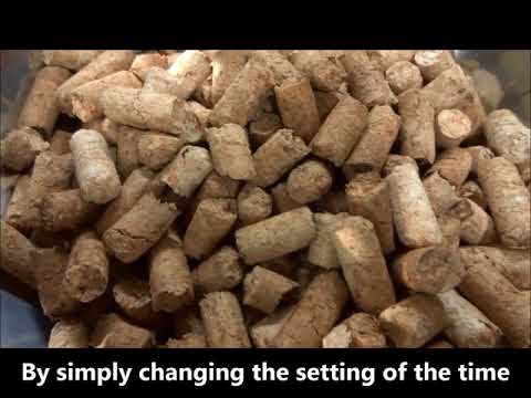

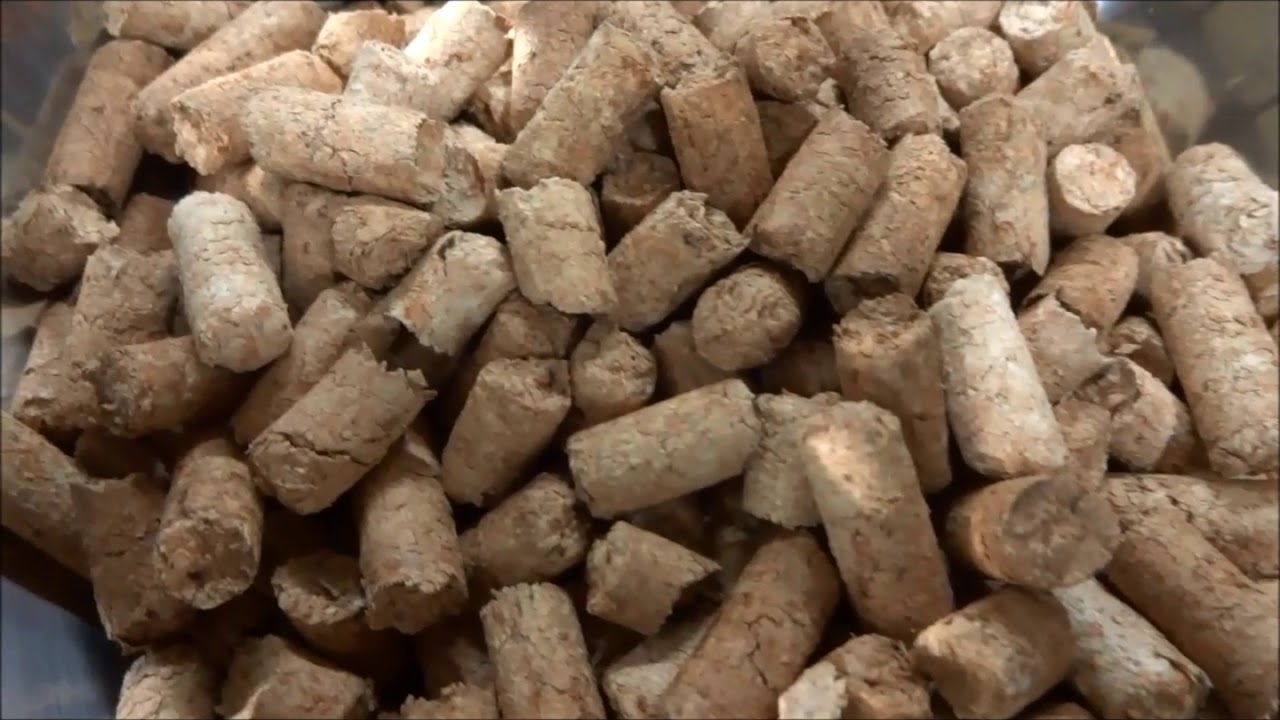

Torified wood still retains 90% of the energy content of the original raw wood.
Its not charcoal but its more predictable than raw wood
I wager I can build a cross draft that can crack any remaining tars running on this fuel. I am going to give it a shot in this seasons run of tests

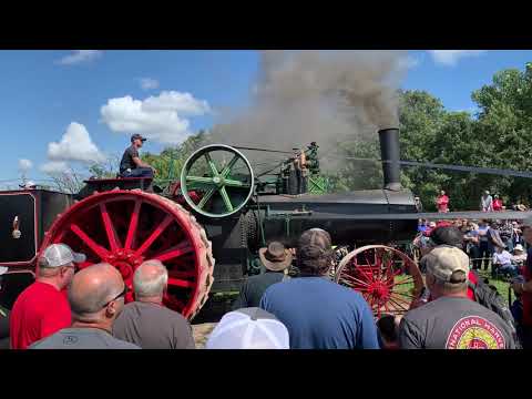

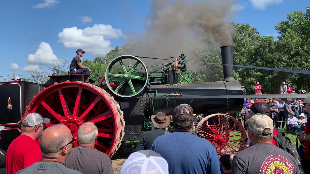

150 hp and 5250 Lbs ft. of torque.
That’s been around for a long time. A bit hard to do but should be doable. If I recall correctly, the wood will be water proof because some of the tar coats the surface layer. There is some outdoor preserved wood being treated this way.
William, I love old steam engines! Seriously have had an obsession with steam for years. However those old piston steam engines make all that torque at about 200-300 rpm (I believe in the video you showed it was stated it made 171 hp, 5000lb/ft at 180rpm), which is why they were so terribly slow (that and their mammoth weight). They are so cool and I love them but at the end of the day you can do the same amount of work with that engine that you could do with a 150hp Honda Civic engine, it’s no wonder they went out of style. You see those videos of the steam tractors having a tug of war with newer 500hp modified John Deere’s and the steam tractor annihilates them all, but that’s more to do with the fact that the steam tractor weighs 20,000 to 30,000 lbs! The 500hp John Deere after transmission, differential and possible even final drive gears is actually putting well over 5000lb/ft of torque to the ground.
