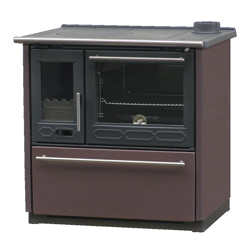

http://www.plamen.hr/hr/Proizvodi/1
We have such a stove in the kitchen for cooking in the winter, otherwise it is an older model, it has been working for 20 years and is undamaged, the interior is cast iron, an indestructible stove. My wife wanted a new one, which I ordered these days, approx. 800 Eur.
Oh, I’m looking at something similar, water jacketed, I have to give 2800euro approx.
it says that they ship throughout the European Union
The demand for these stoves is very high, they are not currently available in any store, they say that you have to wait at least a month. Plamen is a Croatian company with a long tradition, they make very high quality products, this stove is for connection to central heating, an excellent product, my brother has an older model, it has been working for 15 years.

I have looked at this, think it is from Croatia, costs like at least 2800 euros in Sweden, 6-8 weeks delivery time.
Jan, be wery carefull about ordering a central heater, if you want to also cook on it. Father has a heater like this and you cant even boil a cup of tea on it. Its what he wanted so thats ok (just a few kw radiated, the rest in to central) but if you got other plans, you might be dissapointed.
