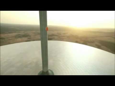

Something like this?
Yes I will. I have moved to eastern Wa and now getting settled in. So I am going to startcolecting materials for it and many other projects I want to do. I am thinking about building a vortex impeller so it won’t need the high speed.
We are now getting nearly 4kw from our turbines with 3.5 m blades.
Several YouTube’s on “Tower Electric Generators”. All a little different. One said it was to be built on the Mexican boarder of Arizona and be completed in 2015. Later I will have to see what I can find on it and if it ever happened.
Barstow Calif has a tower with a field of individual reflectors, all continuously moving the direct the sun raze to the top of the tower. At the top is a structure full of water that turns to steam and the steam is piped to turbines on the ground.

I think that the solar tower idea forgot something when the computer modeling looked like a cinch.
