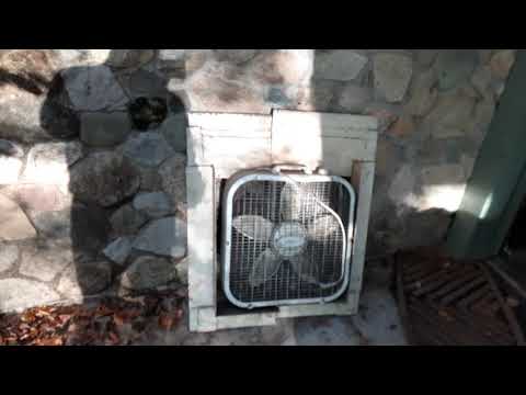

I have had some issues with my wood heater . When the heater is cold and I try taking the ash out there will be very fine dust that will escape . I could build a hot fire to make the heater draw good but on these 70f days it just doesn’t seem right to have a hot fire going . I have an ash dump door in the heater but to rake the ash into it the front door needs to be open about half and the dust still will escape .
I thought about adding a little pressure to the inside of the house to see if it would help and it did. After I laid down the camera so I could use both hands and hold the ash bucket up in the door it seemed I skinned that cat ![]()
