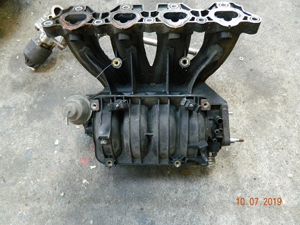

One job we are going to have to do is build an intake manifold because these cars only ever came with plastic.

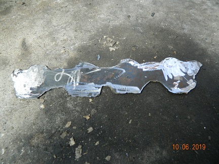

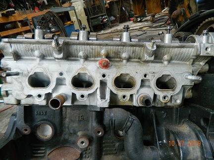

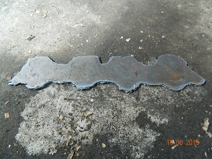

I started making a metal intake manifold for the car.
