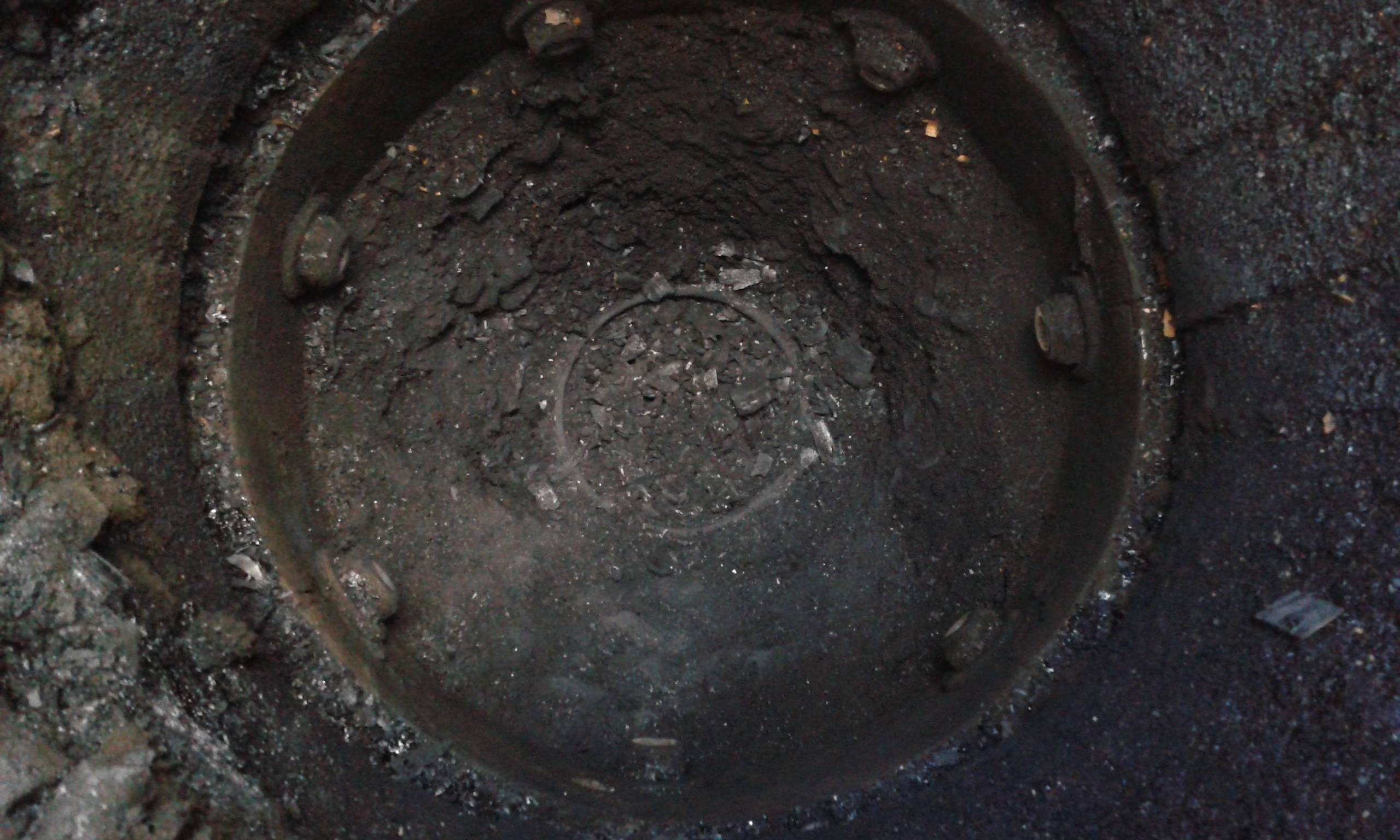

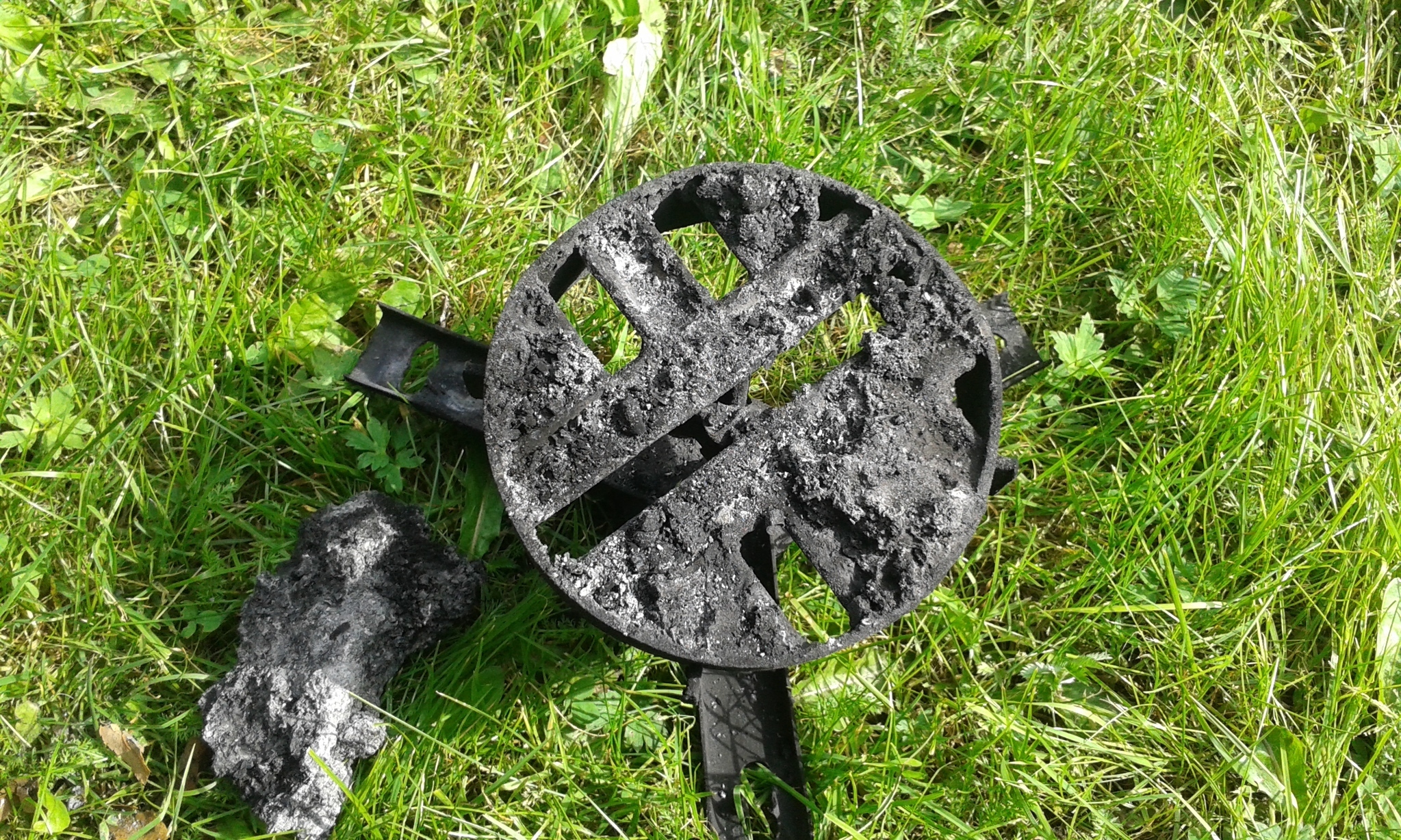

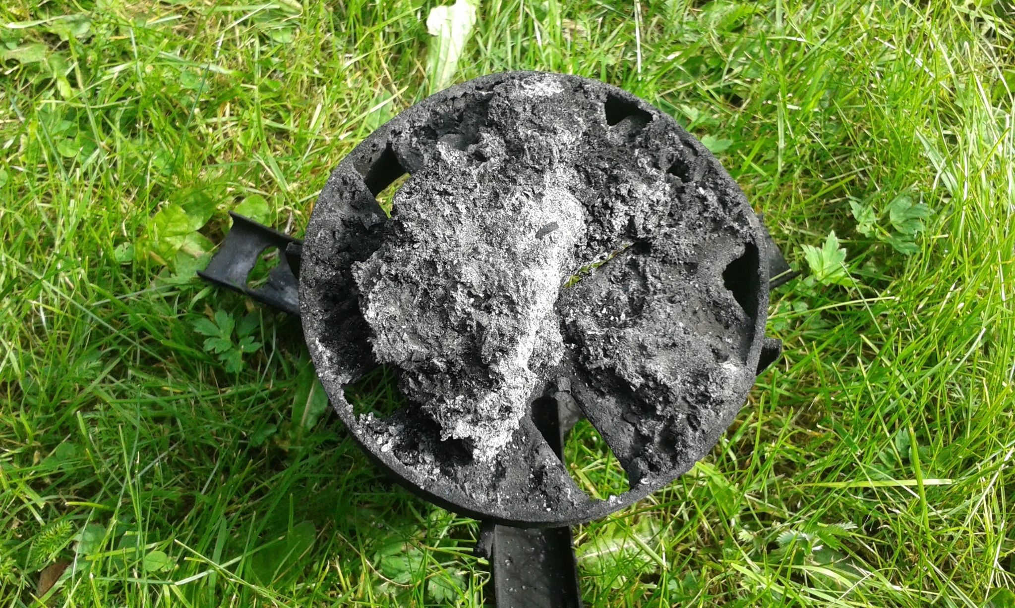

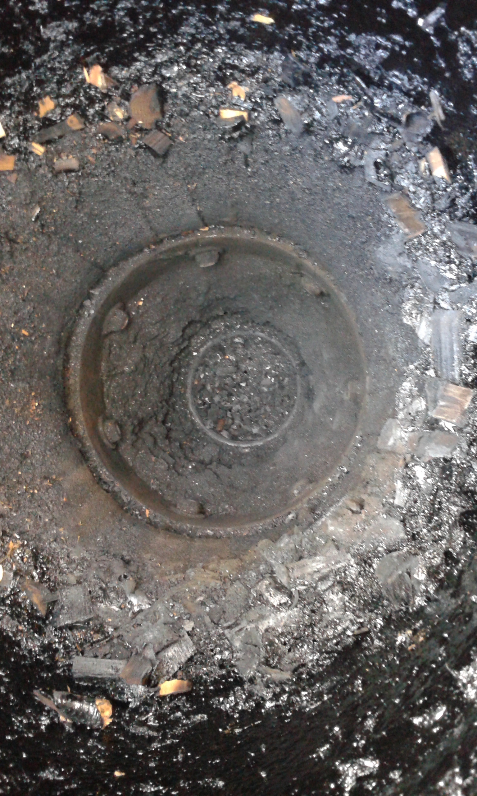

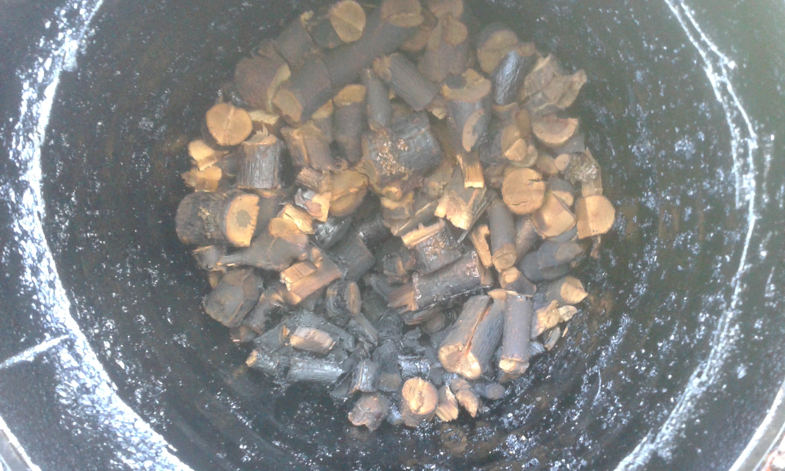

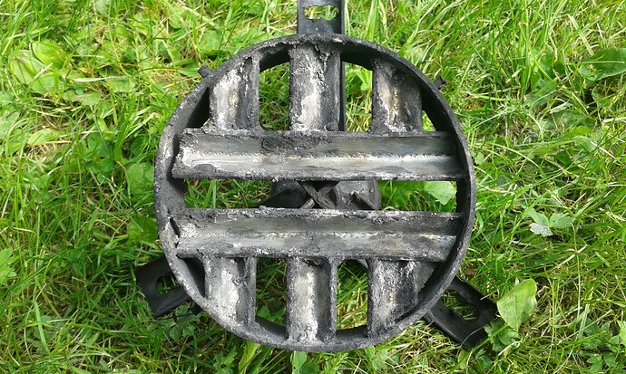

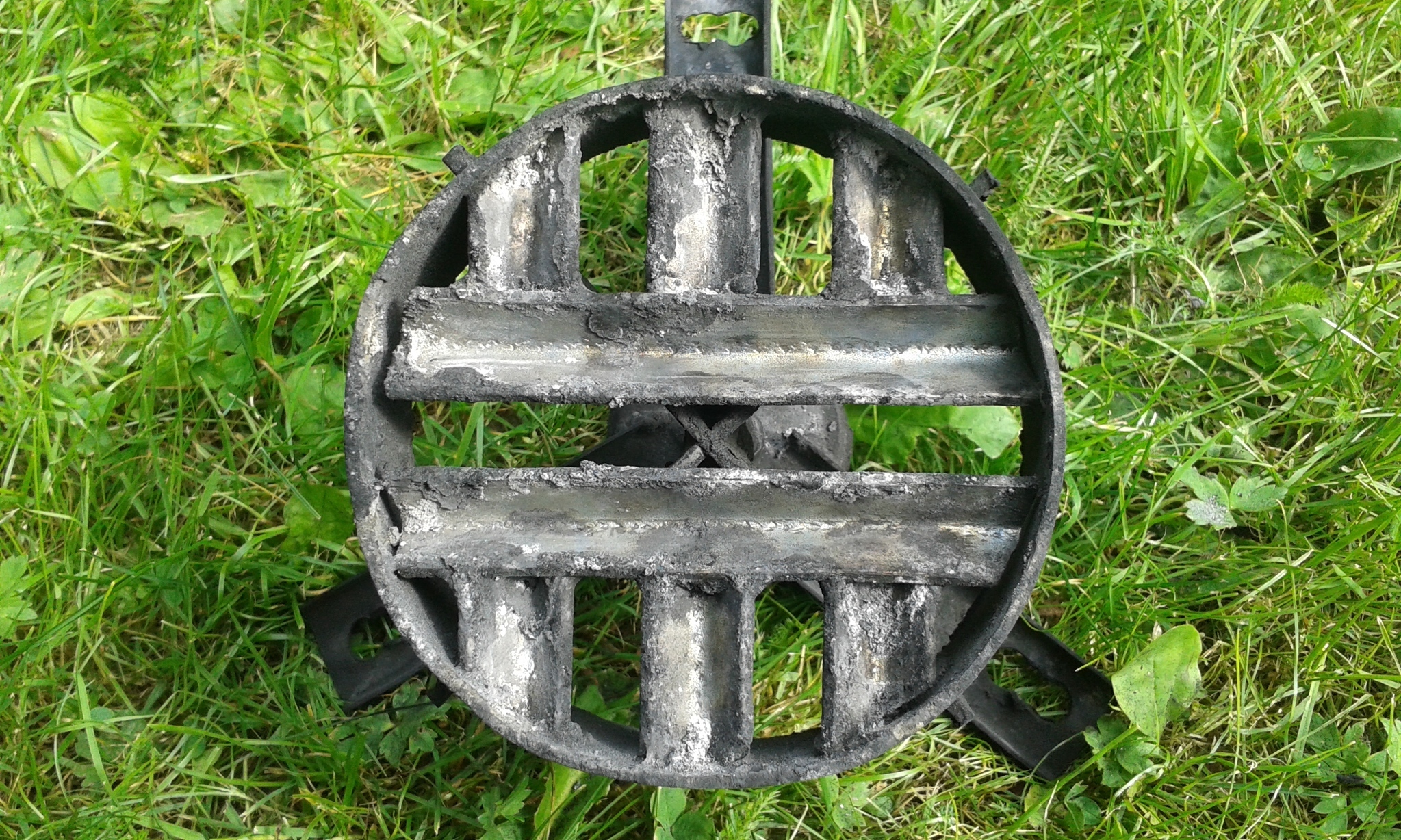

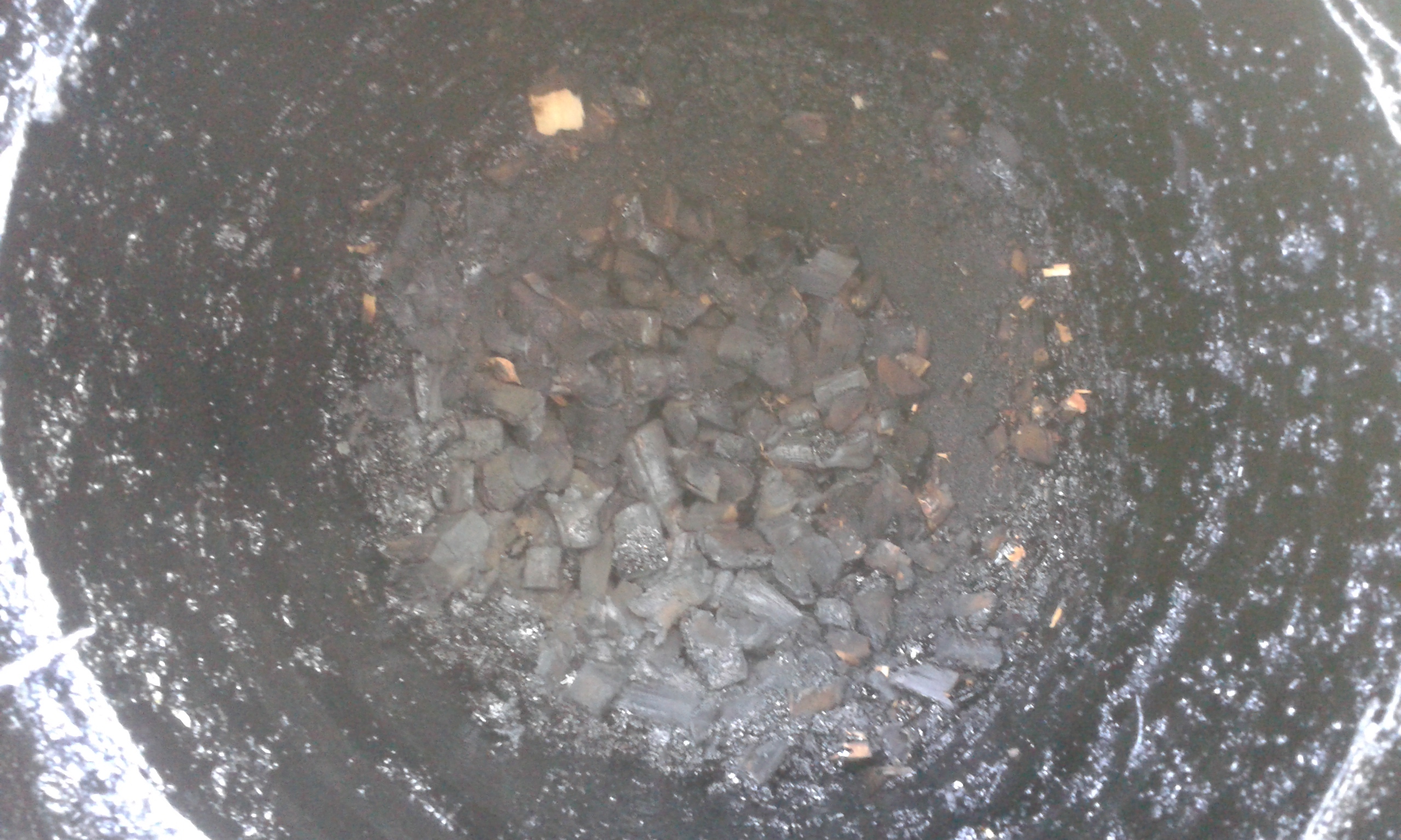

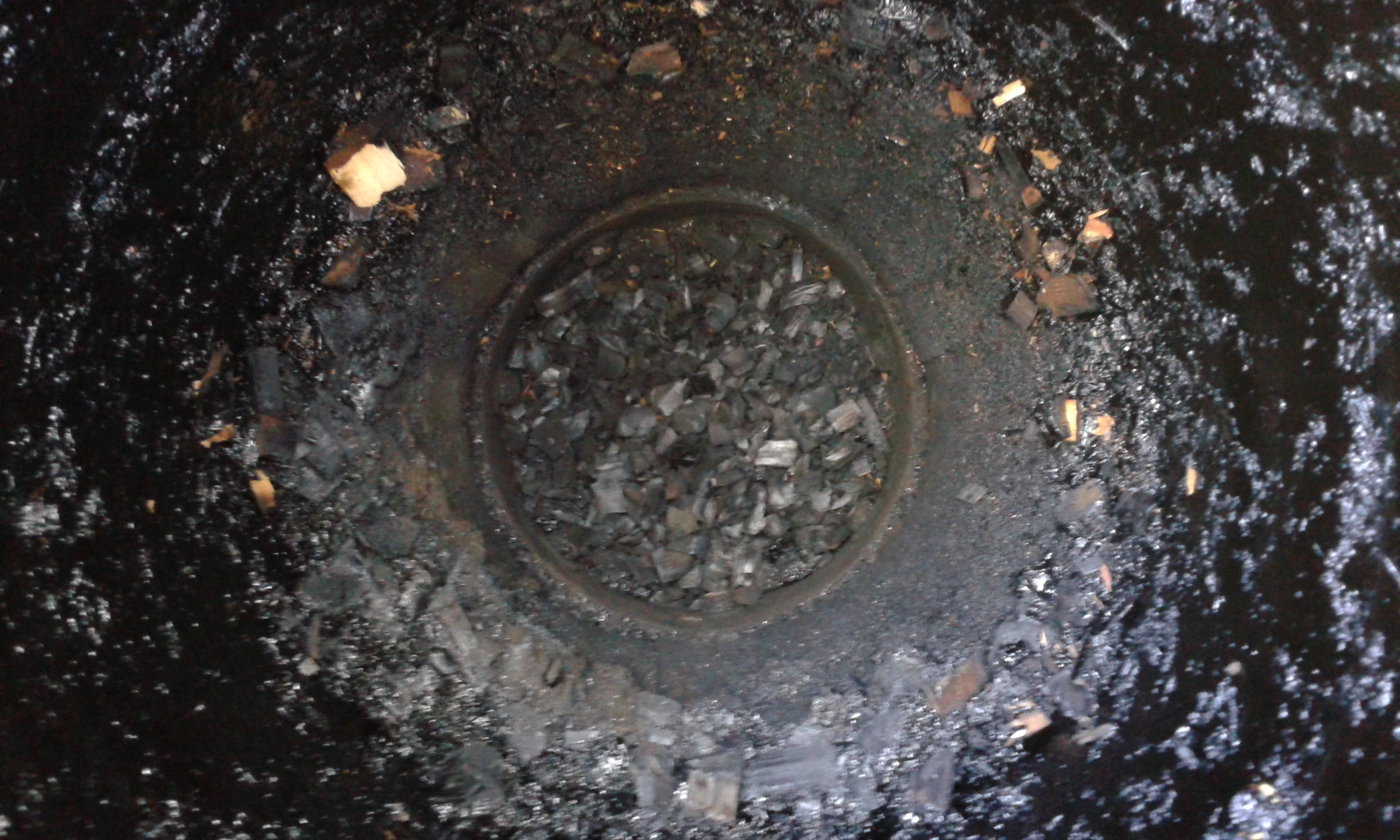

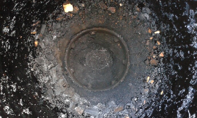

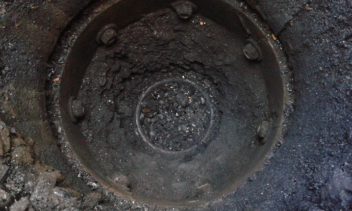

These are pictures from yesterdays event:
Below insert is removed:
Reduction and grate plugged big time.
We live, we learn…

Is that slag on the grate? it looks like my charcoal gasifier slagA!

No, i think it’s only a mix of ash and very small char (dust). Falls easily apart like wet sand that has dried up. The whole reduction was filled with it. Only wormholes left for the gas to travel through. Didn’t even come out by itsef when I removed the grate.

It seems the lower part starts to handle its task as expected!
The upper part is still about 1,6 times as big as half cigarett paks need, comprising of an char-coke cone and a flat “WK cylinder” upon it.
This seems to be successfully circulating the pyrolyse gases and keeping the returnloops around the nozzles free and dry from tar-coking.
It may now handle fuel bits of a tennisball size.
If a newer set of pictures show changes in the upper part, please show the new pictures!
If “flattening” is needed, the threaded 3.5" ID nippel in a welded-on flat nut is a handy way of regulating the cone height.
Yes, that’s the size of the biggest ones I used. Probably the very upper limit. They are after all going down into an 8" firetube. I remembed the old rule of 1/4 of firetube dia for a maximum.
