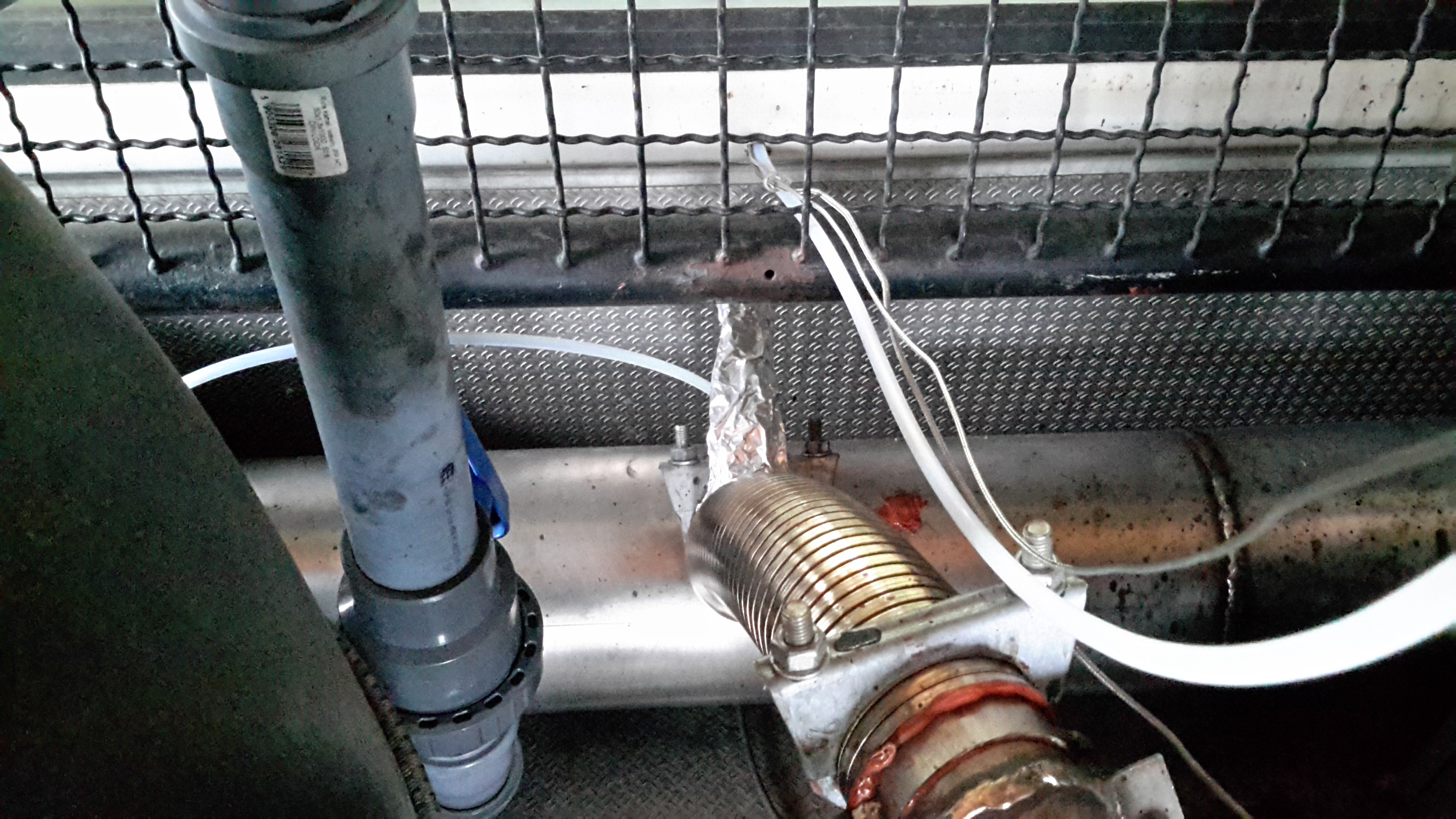

OK Kristijan, here we go:
I mounted the tc in the flex pipe going from the cyclone to the condence tank only 4-5 inches upstream the previous position. What a difference! I´ve only been measuring steam temp in the tank before.
With a warmed up gasifier the reading now levels off at about 300C (572F) and that´s on medium load, 1/4 throttle, never faster than 80 (50). (Well, full throttle is usually 90 (55+) :smile:) The tc is rated only 307C and I didn´t want to ruin it.
Even when I stopped, and after 10 min of 1000 rpm idle, the temp never went lower than 200C (400F).
Funny, I could still hold my hand on the condence tank and the top of the coolers, right before the plastic pipes, were only slightly above ambient. (About 5 s after I been running 300C.)
Conclution: To find out more I´ll have to find a temp guage with a higher rating.

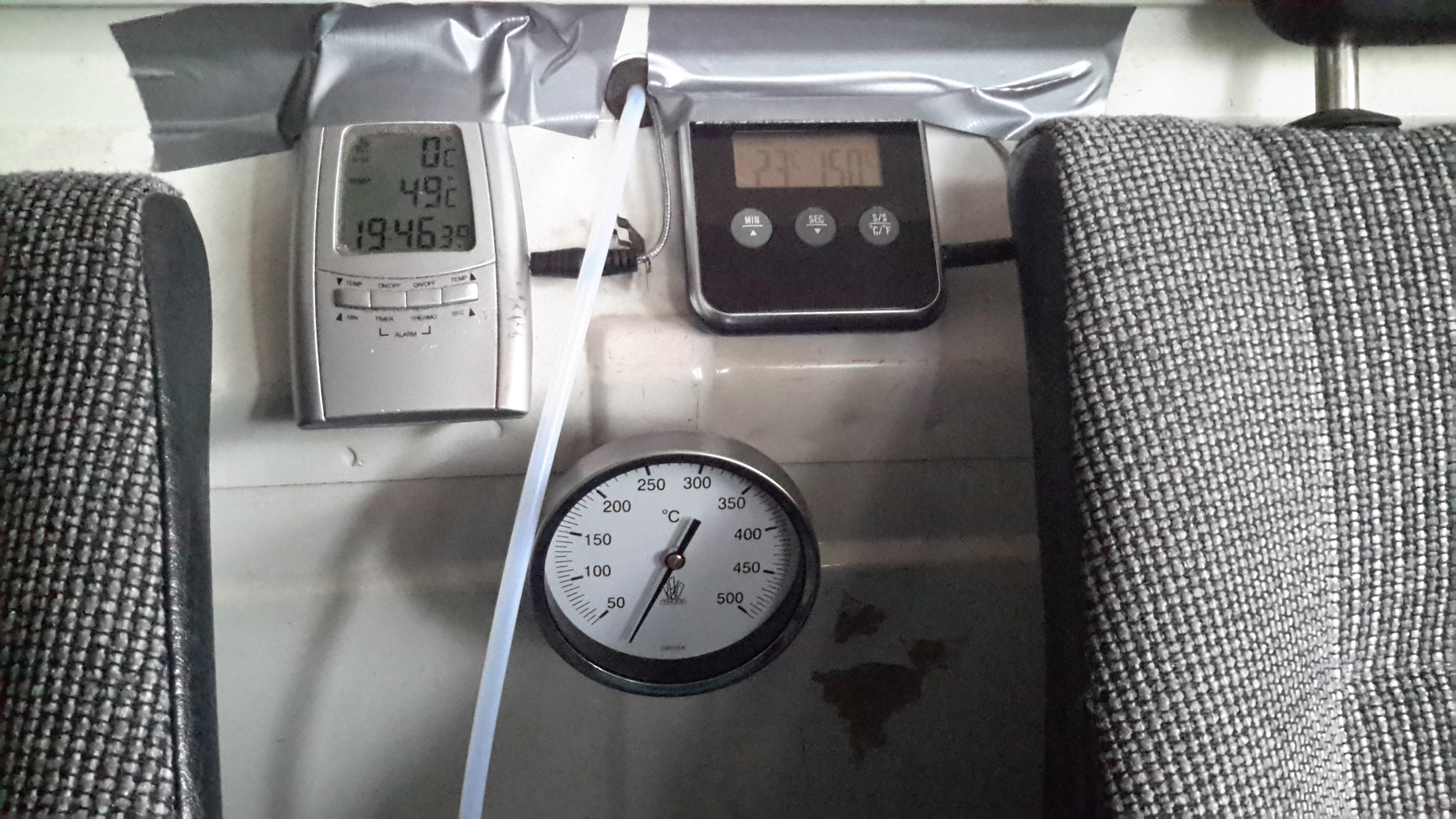

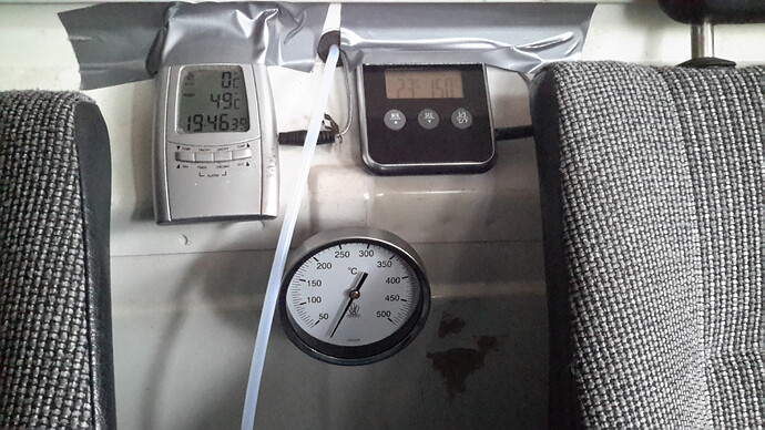

Bought a new chimney thermometer yesterday. I had problems keeping in the 300 C range with the meat probe since I moved it into the pipe from the cyclone. The new one goes up to 500 C. But it responds very slowly and doesn’t show more than 300 C anyway, even after 45 min open road speed. I wrapped some insulation around the shaft and dressed it in alu foil but no difference.

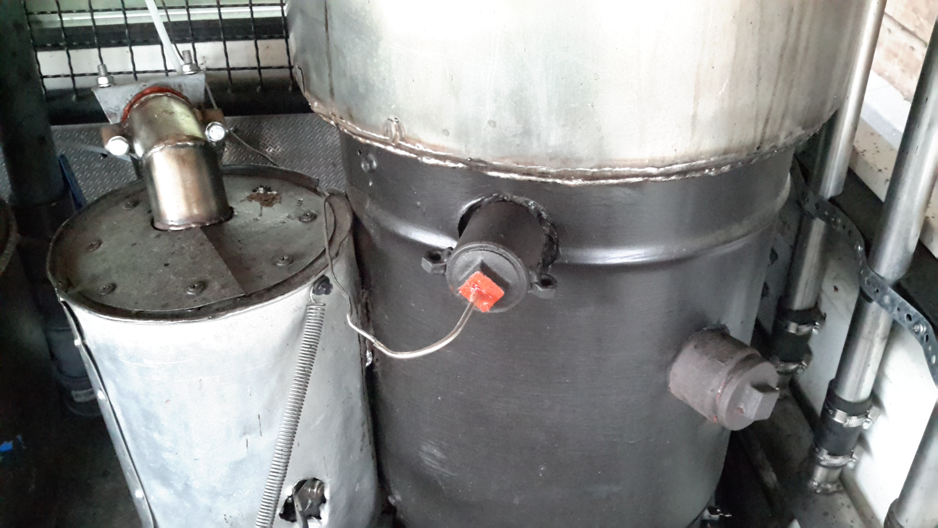

The meat probe (left digital) now serves as a air preheat thermometer. I drilled a small hole in the light port lid, put the probe into the nozzle compartment until I hit the firetube wall and the backed out half an inch. Didn’t work. It hit the upper 300C/572F in about 10 min driving. I have now pulled it out into the light port pipe another inch and manage to keep below 300C. The lid probably works as a heat sink now. To get a proper reading I will have to get a new tc here as well.
I didn’t expect to have this good preheat since I only steal heat from the outgoing gas.

My preheat temp was 300 C. That´s 572 F. The cyclone preheater is only the first stage and will raise the temp just a little bit. Around the entire gasifier housing I have a second propane tank, slightly larger, creating a 1/4 inch void where air svirls upwards before entering the nozzle comparment.

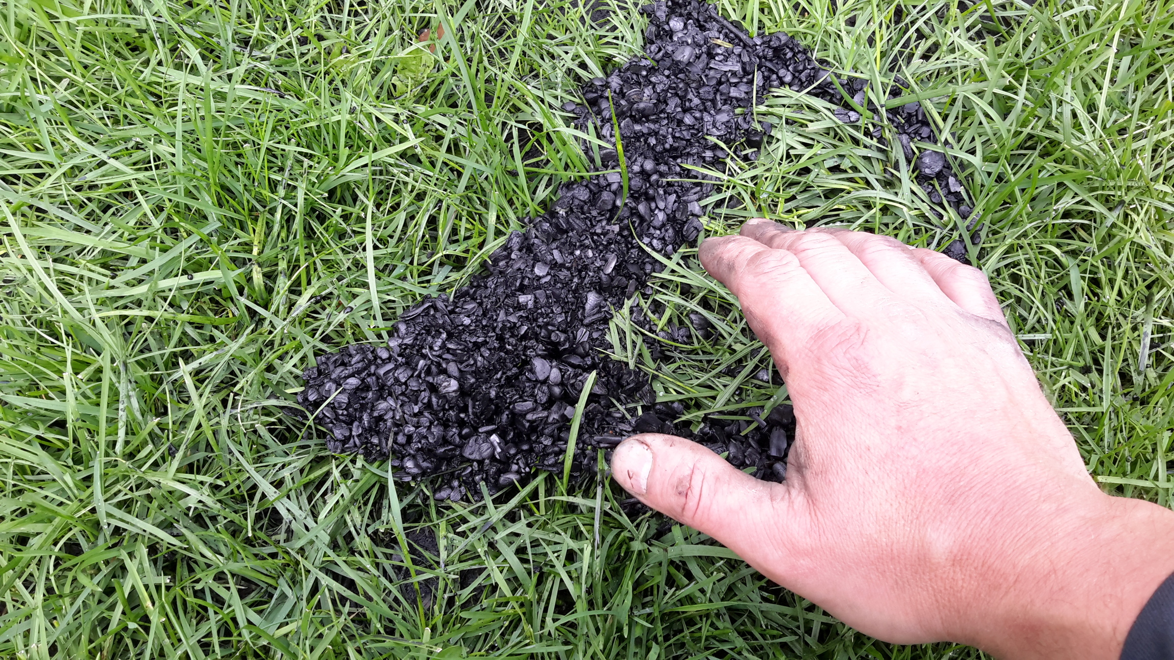

Definetly char in the condensation tank. The result of a full dump and a full cyclone. I’ve been a bit sloppy about maintenace lately. No harm done though. I saw no high vacuum or difference in performance in my 100 mile trip yesterday.
Makes me wonder though how a hot (sock) filter would react to glowing char. I think I’ll stick to the wet side in the future.
