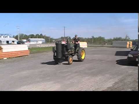

trust me… once i get the carb figured out… I have an idea what i’m gonna do… I’ll be driving it up and down our yard…

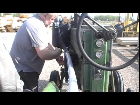

You surely want perfect control and adjustability. To achieve this, there is no SHORTCUT! The ganged twin flaps must be identical in every sense. Both must close at the same angle and be so tight, that direct sunlight will not pass!
Only a lathe will deliver the precision needed. The tubes must be lathed inside first, and then the flaps can be made accordingly… 3-4mm thick brass makes wonderful flaps.

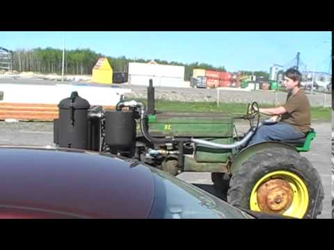

My son out driving the tractor… all be fore breakfast… been a good morning so far.
He did manage to stall it once mind you… one end of the yard is really loose sand, it and third gear were too much for it… other than that, the gov.seems to be working like it’s supposed to.

my son really likes it, i know he’s gonna miss it once it’s back in the customers hands.
i must say i learned a fair bit by this build… next one will be even better.
