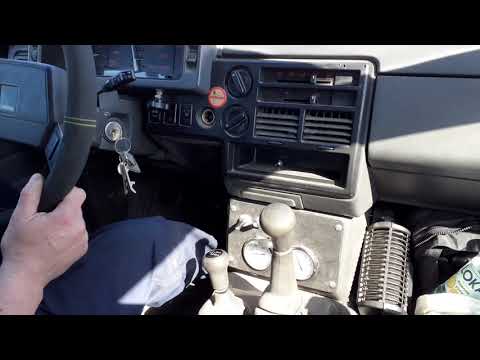

Big road + steep hill + heavy truck + small motor = hybriding.
100 mile roundtrip yesterday. Wife acts camera man.
On our way home we had two intake events. Cars behind us disappered in a cloud of smoke
