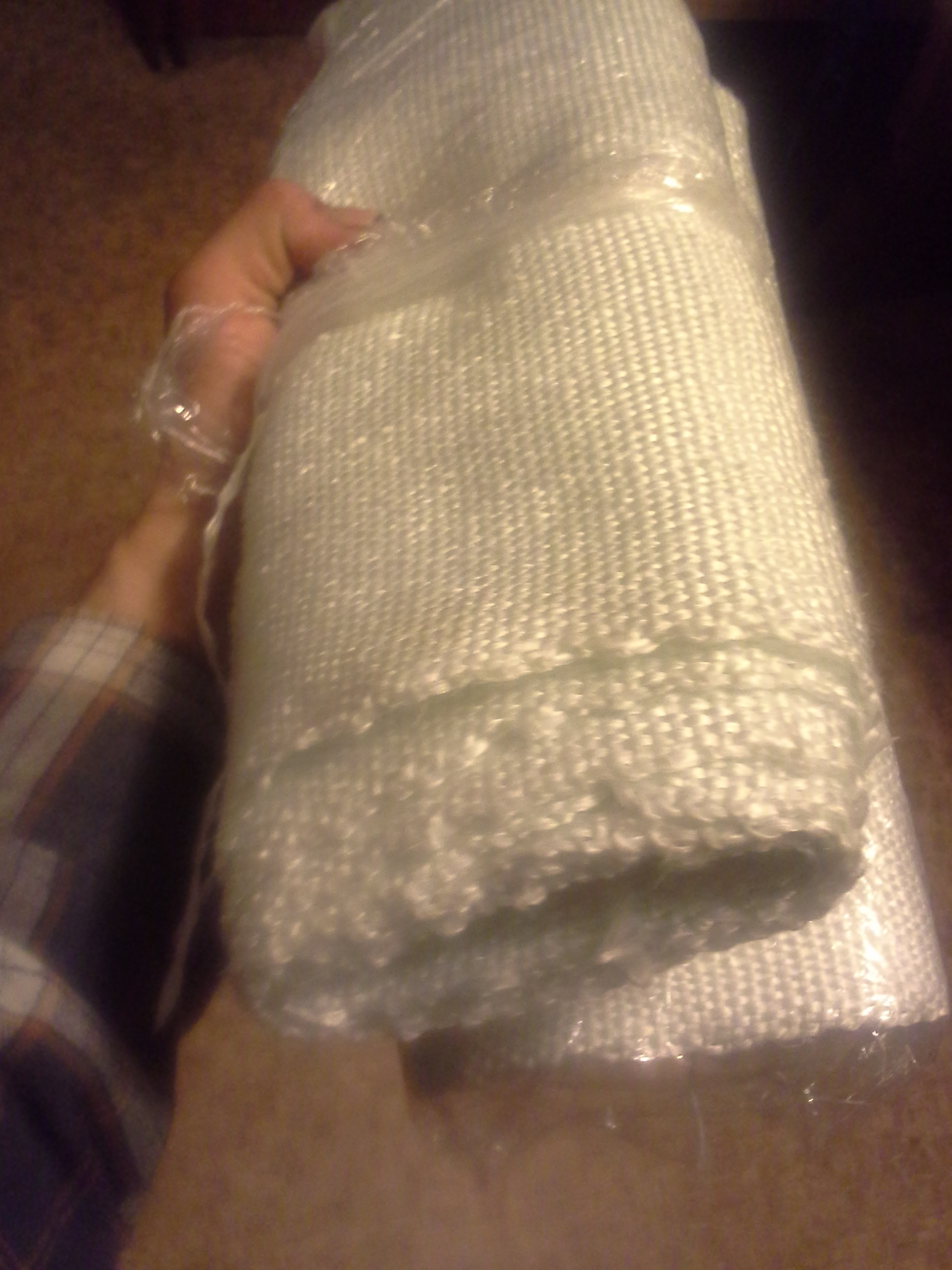

I bought the fiberglass fabric today! This looks much better. As Max wuld say, the non sun shine let trugh kind.
