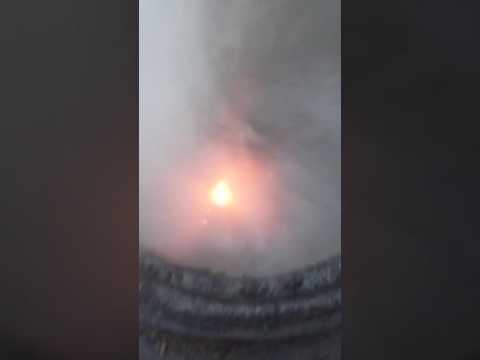

And in the end, a short video l wuld like to share with you guys, one l dont think l ever seen before on Youtube, the operateing near emoty gasifier hearth and its butyfull downburning flames:
This is good news. Maybe you get some advance after all only restricted by the ping sensor. 10-15 degrees of advance is often enough.
Nice video btw.

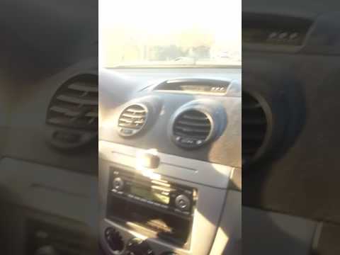

It is a lovely warm and sunny sunday afternon, it is Martinovo this weekend (saint Martins day), Martin is sayd he makes young wine from must. We celebtate all three days, tasteing neighbors wine and eating roasted geese, red cabage and mlinci, a kind of tortilia steamed with boiling soup. After there were only bones left on the table, l thod it wuld be nice to make a short DOW, but since i drank a few glasses l let my wife to taste the pleasure of wood power.
thiink she passed :smile:
Like the video . keep them coming :grinning:
Wow Kristijan! That’s really impressive. Just think about it. We use to talk about one in a million. I bet your wife is one in billion in the female category (now living woodgas drivers). Was that a refueling stop at the end? I also saw you pushed a button when stopping. What was that about?
I was starting to wonder where you went. Now I know you’ve been partying all weekend :smile:
True JO!
She was wery afraid of it but saw there is no big deal driveing on wood, expecialy with the automixer. The only thing to do realy is hit the swich when needed.
We just turned around there and went home.
This is a hybrid swich so that the engine doesent stumble or dye on traffic lights and such.
