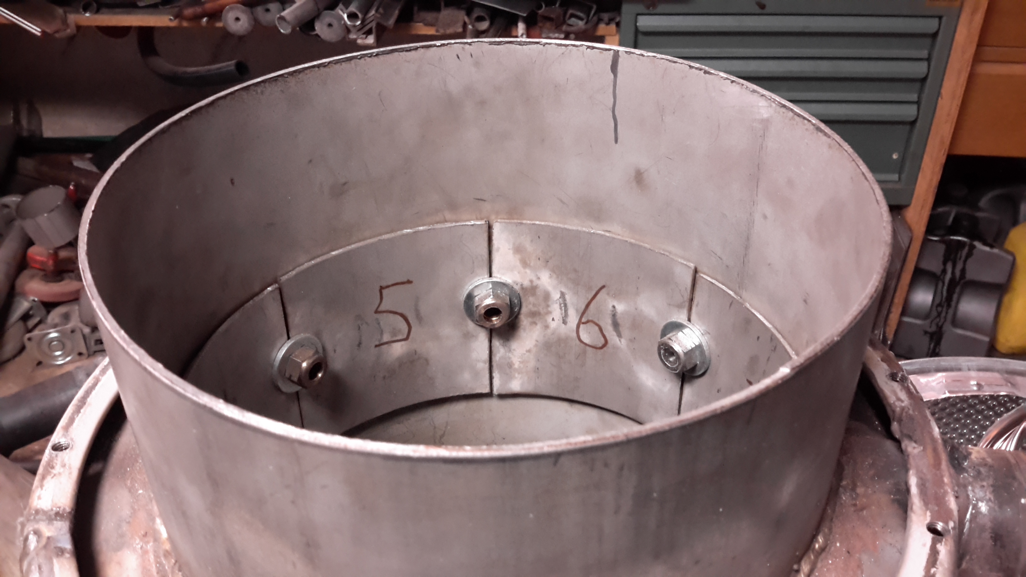

This picture is from when I installed the sacrificial plates. They hold on only by the nozzles and brackets. The burntube was later cut off the same hight as the plates.
I haven’t checked them out since before christmas but I saw no wear on them at that point. I think ss may have lower melting point, but it seems it doesn’t flake from high heat. So far so good.

Hi Kristijan, my plates are looking good. The only thing to remember is make sure you have two opposite flats cuts on any circular choke plate or disk you use, so you can remove them. My plates are bolted at the top and have a little gap behind them at the bottom from the high heat. With 12 of them in place I lost about a 1/2" of diameter at the bottom from heat. Better to have the plates to take all the heat than the fire tube wall. I cut my circumstances on my choke plates smaller also. The ash fills in the voids.
