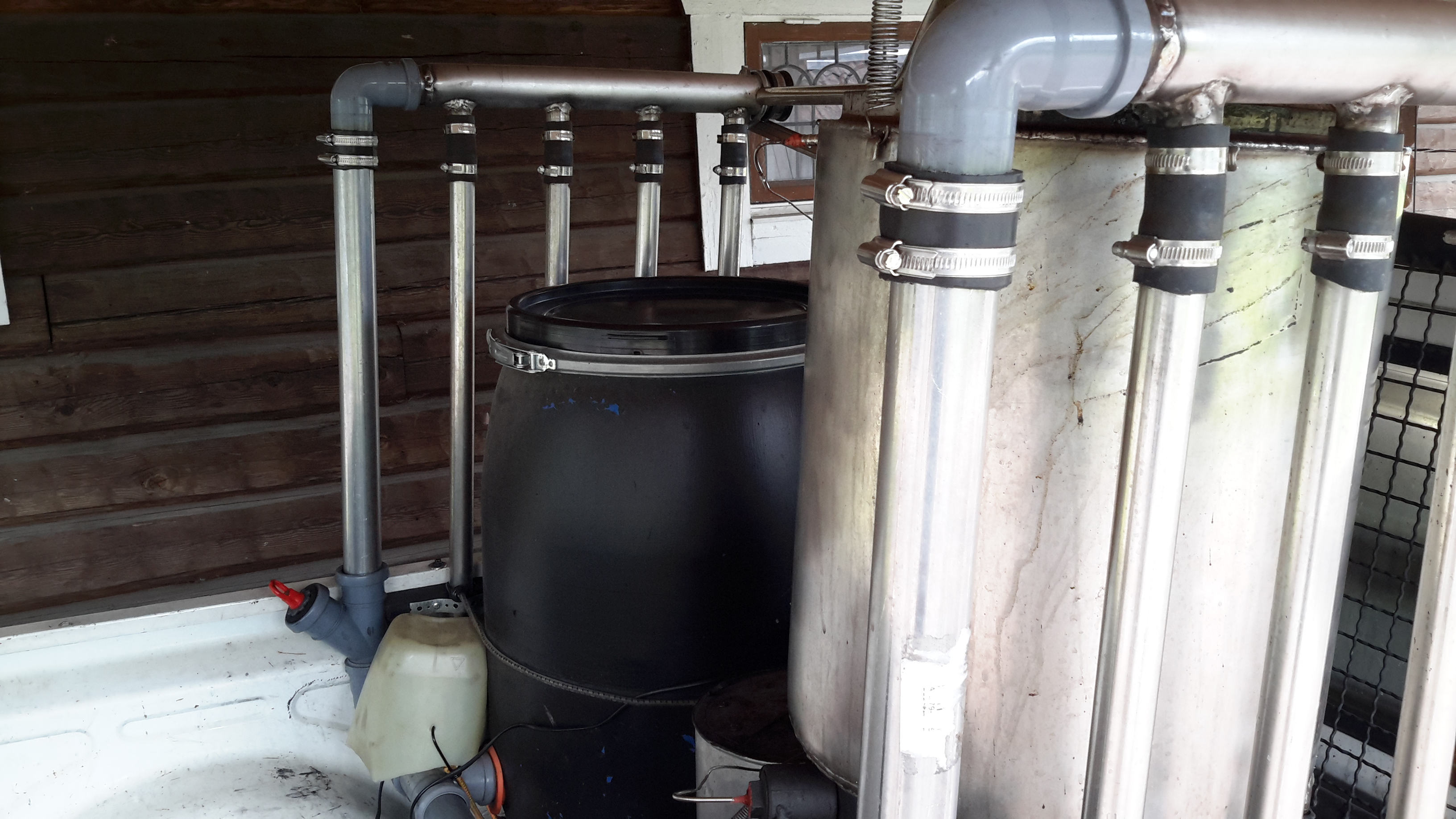

A bit of update.
The 105mm restriction occadionaly gave me sticky throtle. Made a 95mm insert, power good, no more tar.
But, a nother problem showed up. We are close to 40c (120f) outside, feels like a desert, and the gas is comeing out of the system wery hot and moist, lean. We all know that this promotes a driver to press the gas pedal harder makeing things worse. Yes, the cooler is on the small side and its not up to such extreme temps. Allso, the hot gas makes the plastic filter soft and vacuum sucks it together. What to do?
I was thinking to throw out the filter barrel, put in a metalic one (althugh geting one is a nother story) and 2 cyclones with fins. Shuld gain a lot of cooler area.

It is tough to get enough cooling when you have to hide everything in a box like you do.

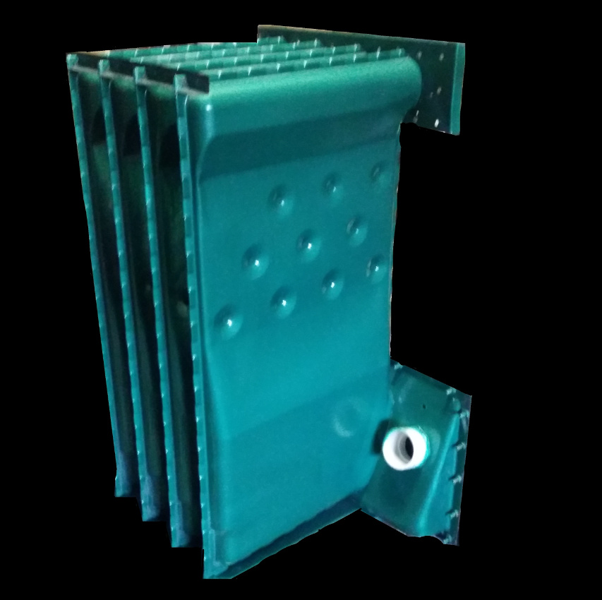

On my new build The gas will be going through a cyclone before going through this heat exchanger.
If that is not quite enough cooling, I can put a 12v radiator fan there to assist air flow.
Well, one of those plates has more surface thain my entyre cooler. I dubt you will find any problems.
I have a fan in the alubox. It cools the hopper. It culd allso cool the gas some.
The plastic filter barrely is crapy for heat conduction right now…
Sorry Kristijan, can’t give much advice when it comes to extreme heat :smile:
Well, the truth is I had to reinforce my plastic hay filter as well.
I even changed out a couple pipes from plastic to metal the other day. The ones going down to the filter barrel. Gives me a few feet of extra cooling.
