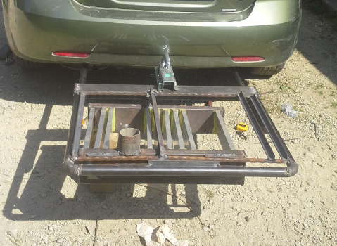

The plan is to make it look factory made as possible (becouse of our blue angels). I was looking up to this https://www.google.si/search?q=smog+pump&client=ms-android-samsung&hl=sl-SI&source=lnms&prmd=ivn&tbm=isch&sa=X&ved=0ahUKEwj2ku2P-uDOAhWLLMAKHTbKAl4Q_AUICCgB&biw=320&bih=508&dpr=1.5#hl=sl-SI&tbm=isch&q=thule+easybase&imgrc=grQ0Fe0BQbsbGM%3A
I culd just buy the platform but it is rated at 45kg max weight, my system weighs about 65kg so the bumps wuld realy be a problem. This one l tested jumping on it and it seems to hold well. Snow will be a problem thugh… front whhel drive…
Ill print some stickers with instructions and logos to give the homemade platform some factory stile. But shhh :wink:
Hi Krisijan , looks fantastic and nice and clean too , I understand about the stealthiness of the build , but wouldn’t a jockey wheel on or under the back help support it as your a little over the rated weight would help stop some of the flexing on those bumps .
Cheers Dave
Don, I think the box is there so the trunk lid will clear the box. I believe in my state he would have to have a tail light mounted on the box or it would be considered sticking out 3 ft. past the back of the car. The tail light< i think, is then the measure of the back of the car.TomC
A wheel is to eyecatching, and the thing is the Easybase costs 250€ ($280?) And lf l have to change it to much (wich wuld allso be ilegal) its alot cheaper to build from scrtch. My setup cost me 15€ to make :grinning:
Allso the Easybase is mountedvonly in one place, the towbar. I dont thrust that so much. My is fixed on 3 spots, much more stable
Where will you hid your cooler. What is the flex tube (?) Made of?
It is already under there Arvid.
Ahhhh… so it is… clever… is it big enough? I guess we’ll soon find out
I see Don already anwsered that one :wink:
The cooler is about 1,5m2 and the platform is sllso a cooler, 0.6m2. The heat exchanger us about 1m2 and the 3" ss flex tube (the other question) is about 1m2. But like you have sayd, will see that soon.
