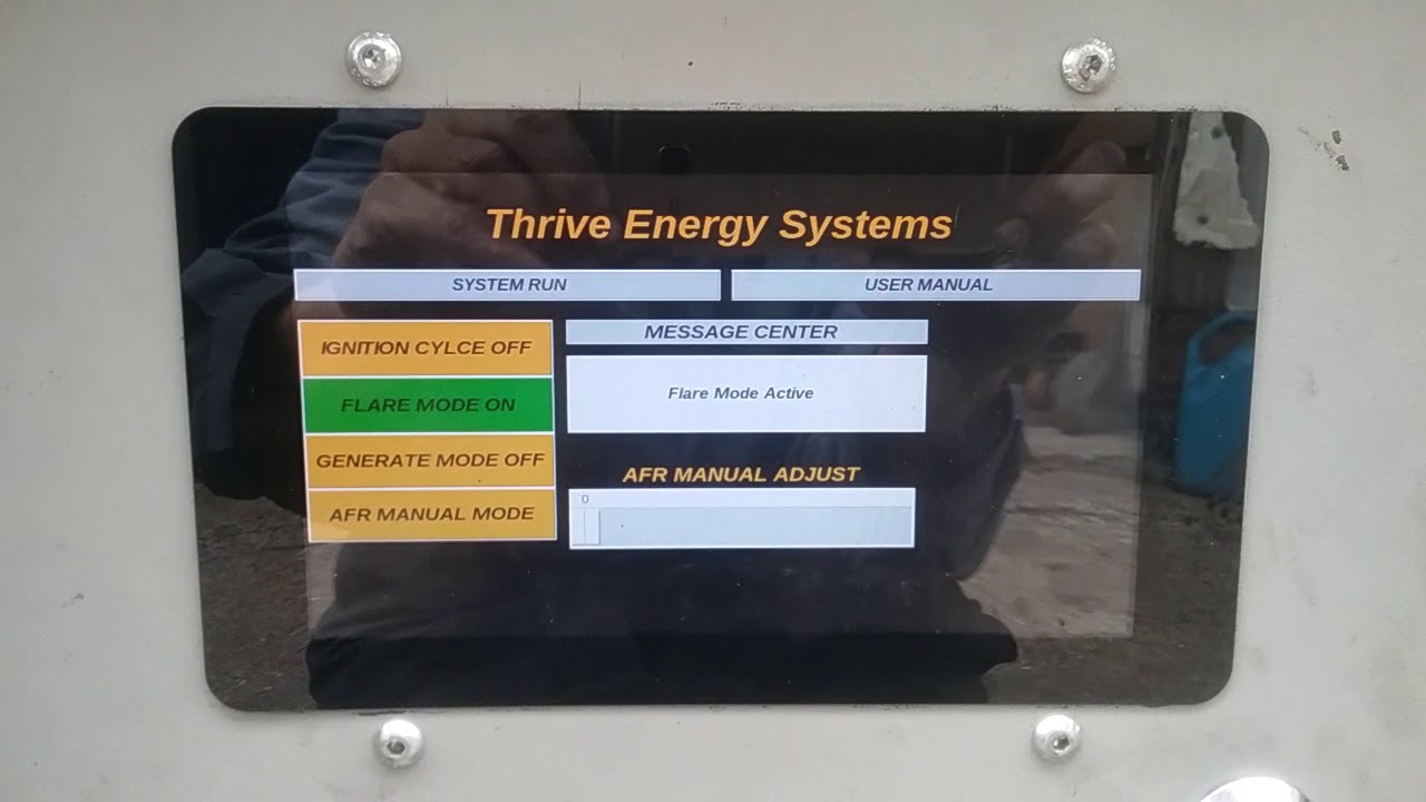

If you watch this video around the 14 minute mark when I am trying to start this machine you can see the DRO of the AFR meter read the mixture. If I would have been paying attention to it I would have started the machine up faster. But when you do video you can lose focus on things.

To Matt: DRO’s are indeed utmost important, even when your engine is not running… The DRO gives an exact status and subsequently a program rule that fits that certain DRO status.
Ad an ECT sensor and a TPS to the Carburetor controller, adjust the flap position for cranking when cold and of you go… program connect your O2 sensor with the TPeS from your gas pedal and MAP sensor and create an acceleration mixture … ( more rich to accelerate and lean when idlle… )
