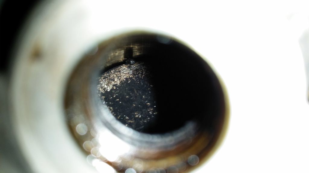

I found out what had seized up my chainsaw… The shop mechanic at the place I bought the saw from thought I’d somehow overheated the engine. He said I should look into the spark plug port to see if the cylinder walls were scoured.

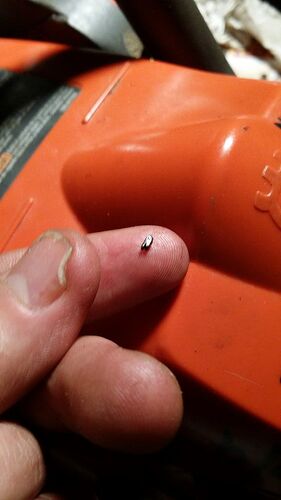

The good news is they weren’t scoured. The other good news is that I know what caused the engine to seize and got it out of there. It was a little chunk of metal, about 1/2 the size of a grain of rice, wedged between the cylinder wall and the piston head.
The bad news is that I have no idea where it came from. The spark plug, the air filter, and the fuel filter are all intact so the metal chunk came from somewhere between those 3 points.

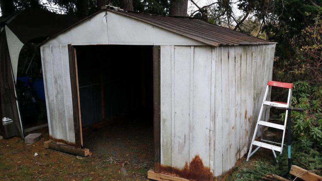

Also, I got my shop/shed up today and the roof is on. It’s going to be nice not having to carry my welder all the way across our yard from our “barn” in the front yard to my work area behind the house, and then back again when I’m done for the day. I’m not ready to weld in the shop yet, but at least it’s only about 15 feet from my old work area, vs about 200 feet+stairs to the “barn”.
I still don’t have any serious power out to my shed though. My only extension cord is fairly light duty, 120V/12A max load. My welder will pop the breaker of my 15A power strip fairly quickly on “medium” settings or higher. I found some REALLY heavy gauge cable (I think it said max load is 600V/200A) in the “barn” but it has no ends/plugs. I tried installing some basic replacement plug ends but I couldn’t even fit 1/2 of the bundle of wires into the recepticle thing (2 pinch plates with a screw between them) for each prong of the plug. Hopefully, I’ll be able to sell this batch of firewood soon and be able to afford some heavier plug ends (and more parts for my smashed car).

That looks like the locator pin out of the piston.
There is a small locator pin in the ring gruve to keep the ring from rotating and and the end being caught in the window in the barrel. Or it could be one of the cage pins out of the crank bearing cages.
Either way it would be better strip and inspect before there is major damage !

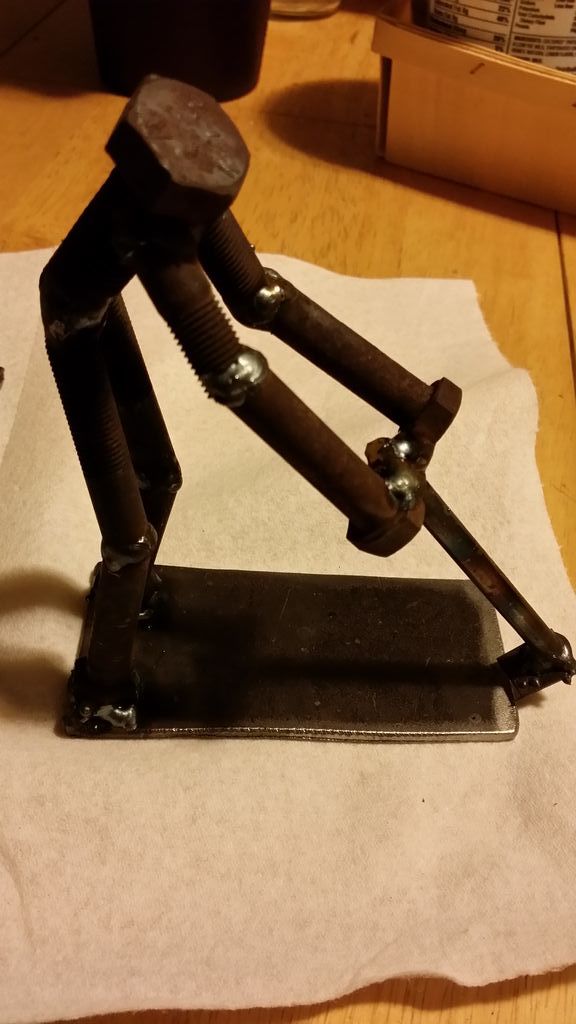

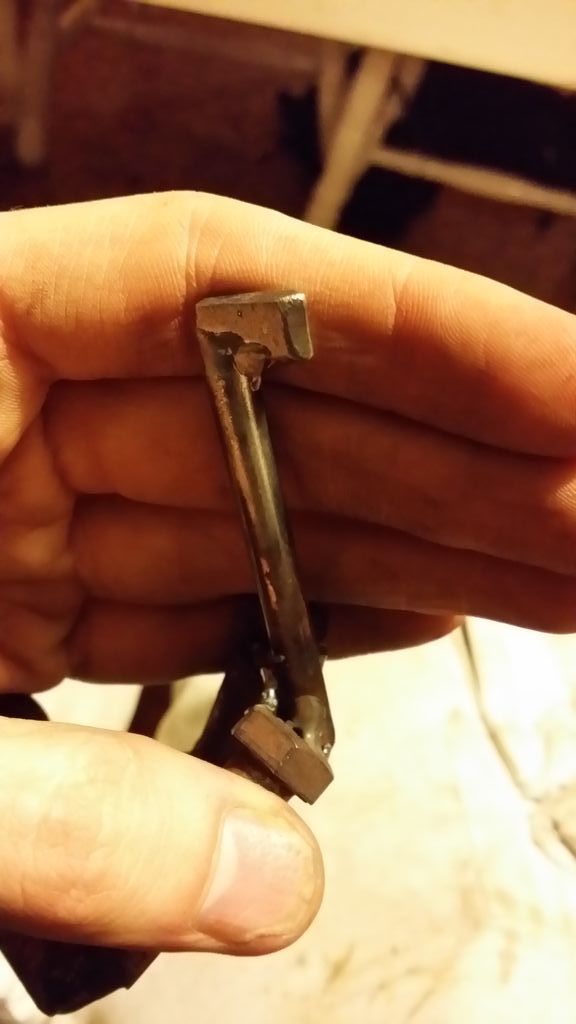

In other news, I built my first things in my welding shed today! I made 3 more “Bolt-Folk”: A shoveling digger, a hoed gardener, and a axed wood chopper. Pictures soon.
