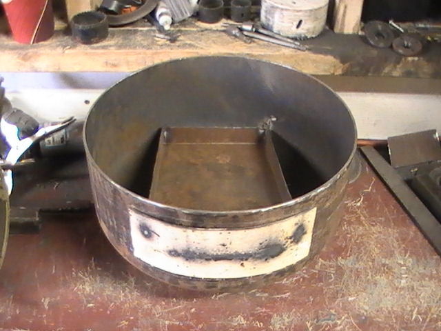

Doug, Do you actually feed secondary air into the upper barrel and from which end. A lot of folks don’t know that the gasses from the lower barrel are supposed to be burned in the upper one … This requires a small secondary air inlet and it is also fun to put a site glass in the middle of the upper barrel so you can watch that blue flame in it … Most folks just think of that upper barrel as a heat exchanger and miss the whole idea. Mike L
Torch cut and bent one inch rebar with four inch high legs for the middle section. The right hand and left hand grates rest on each side of the middle grate on their legs. They got four inch high legs on one side with two inch high on the side going up the barrel side. Each section width is 10 inch wide. I had one work like a charm on my last Vogelzang stove. This one is better yet as $110 gives you an ash door. Don’t buy the cheaper Vogelzang door as the extra $40 means that I never have to remove the grate to clean the ashes.

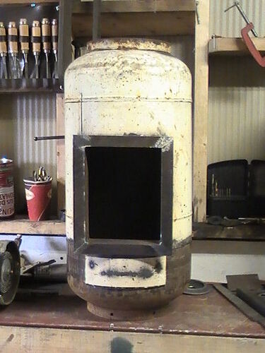

Thanks Steve, primary air will come in under the grate, secondary air will come in through the side at the bottom. I have ceramic blanket insulation that I will wrap the insides with and then have a piece of thin stainless to keep it in place… we’ll see how it works. I’ll post some pics as it comes together… I may use a round Pyrex pie plate as a door… thanks for the offer for glass though… it’s more than a little appreciated.

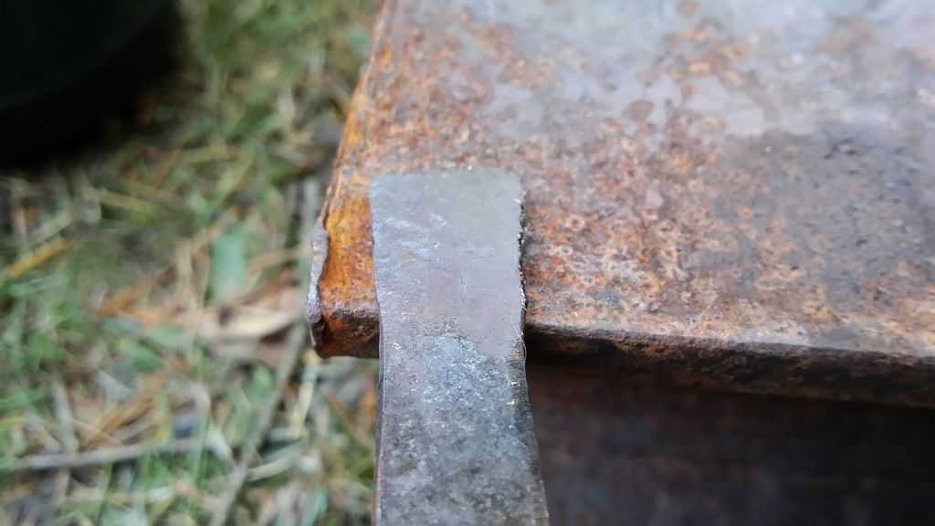

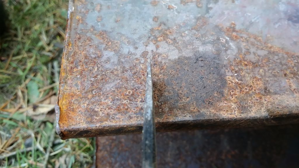

I spent part of today trying to shape the “horn” on my I-Beam anvil.
First picture showing my “relief cuts” in the bottom surface. Second and third pictures showing the curvature I managed to achieve today.
My charcoal forge is still drying the refractory liner so I couldn’t use it to bring the anvil up to forging temperatures.
Instead I just set some fire bricks into my charcoal grill, built a fire in it, and free-hand blew under the bricks into the char bed with my forge blower.
It’s amazing how much easier it is to work steel that is glowing cherry red, bright enough to see it out of the corner of my eye vs the dull red that just looks like a faint rust coating. ![]()
Also, I was smart enough to install a lighting/clean out port into the front of my wood stove before adding my fire clay/refractory coating to the front wall. ![]()
